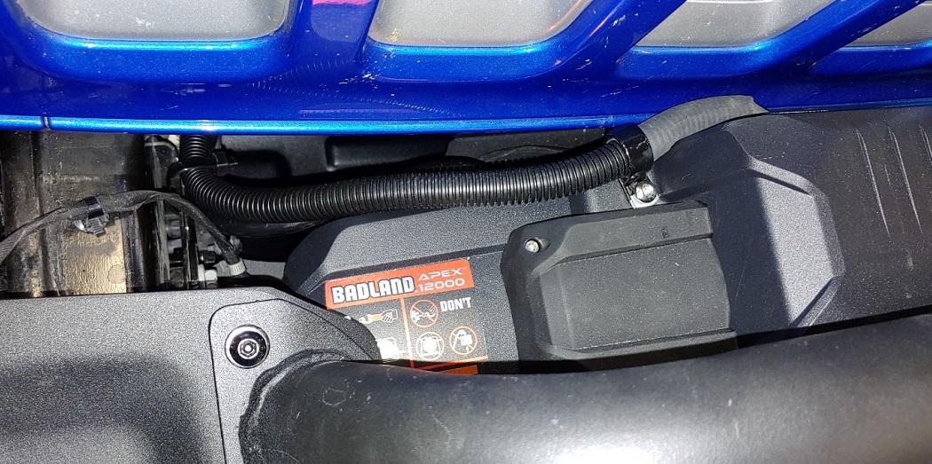

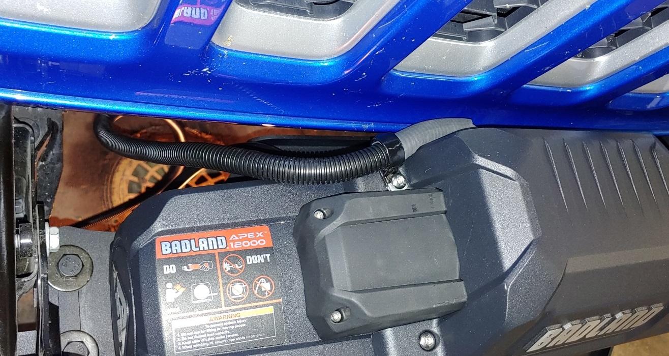

I didn't remove anything at all to route the cable in the end. I put a light under and above the engine bay and sought out the route I wanted, ran a wire down where I figured it would work, and along the frame up to the winch.
I modified the cable a bit to make it bend better along the lines I wanted it to, added a clamp to hold it in place. It doesn't touch the grill, it's a good 1/4-3/8" away from the grill so it won't rub

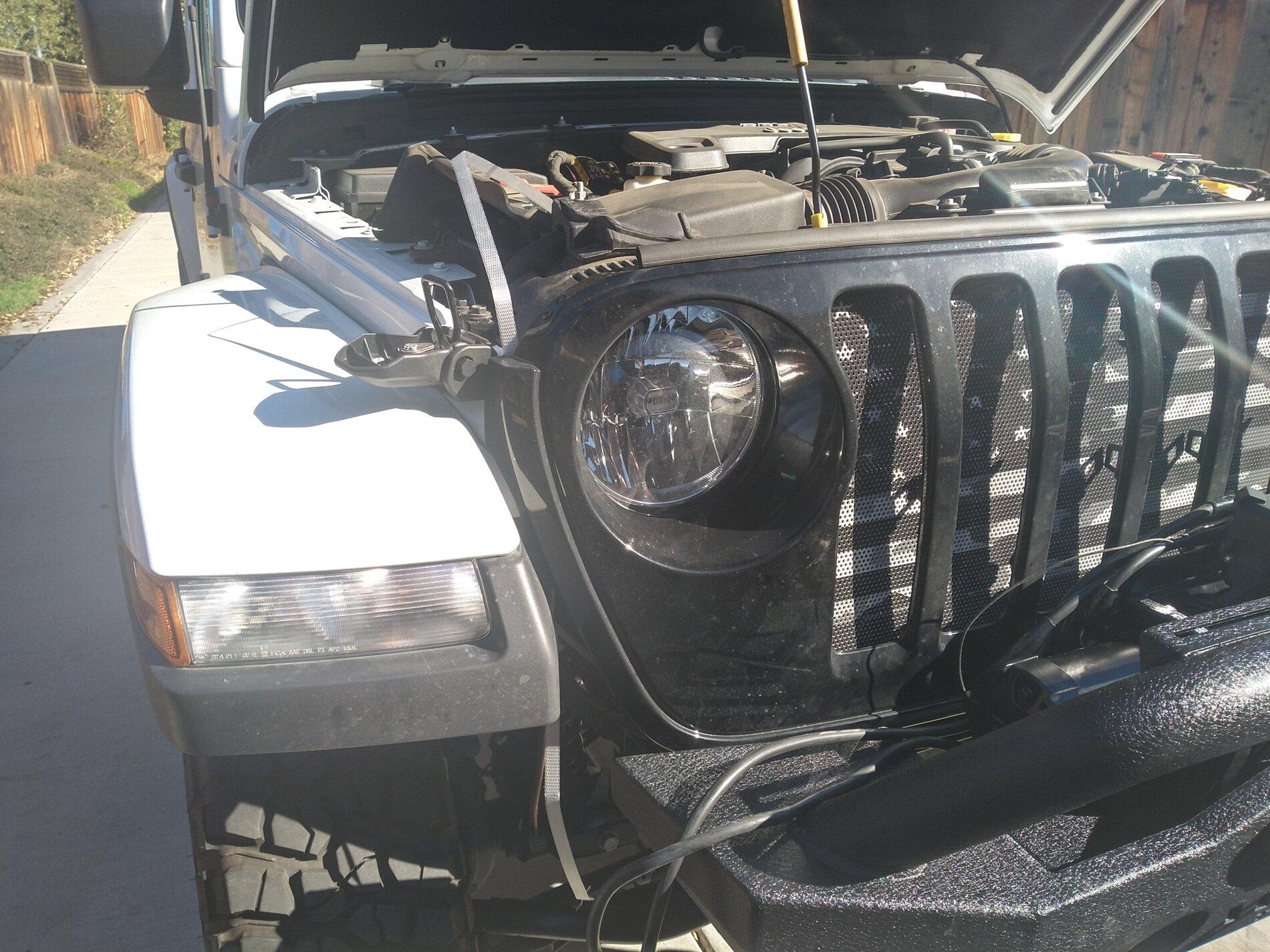

I just did mine along the the inside of the grill. There’s almost a channel for it on the sport grills.

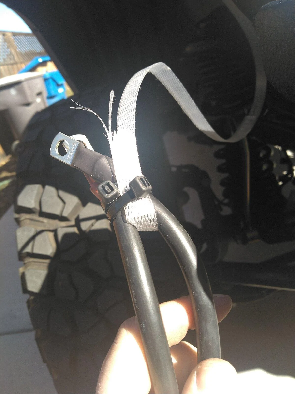

This image was pretty helpful. Once I got to the jeep I could see the "Channel" in that area and was able to route the harness for my winch through there. I used a plastic strap from the box the winch came in as a wire fish to get it through.

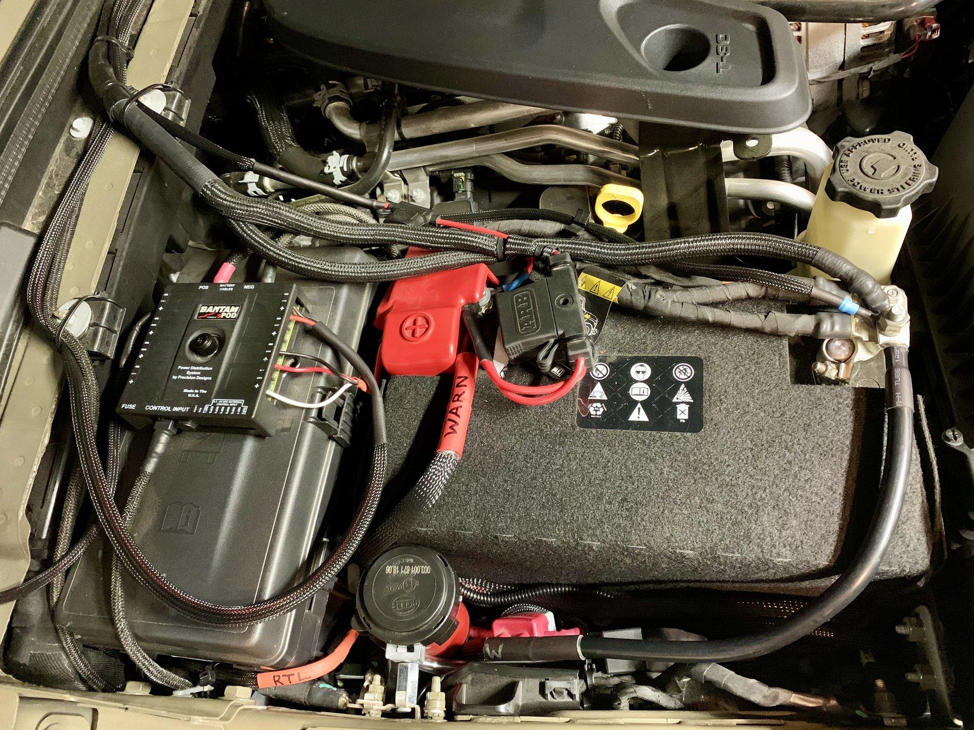

First off, thanks to everyone for the posts on routing the main power wires up to the battery. I went with the idea posted by khockey02. Will pay attention to any rub points and jacket the wire if needed.
