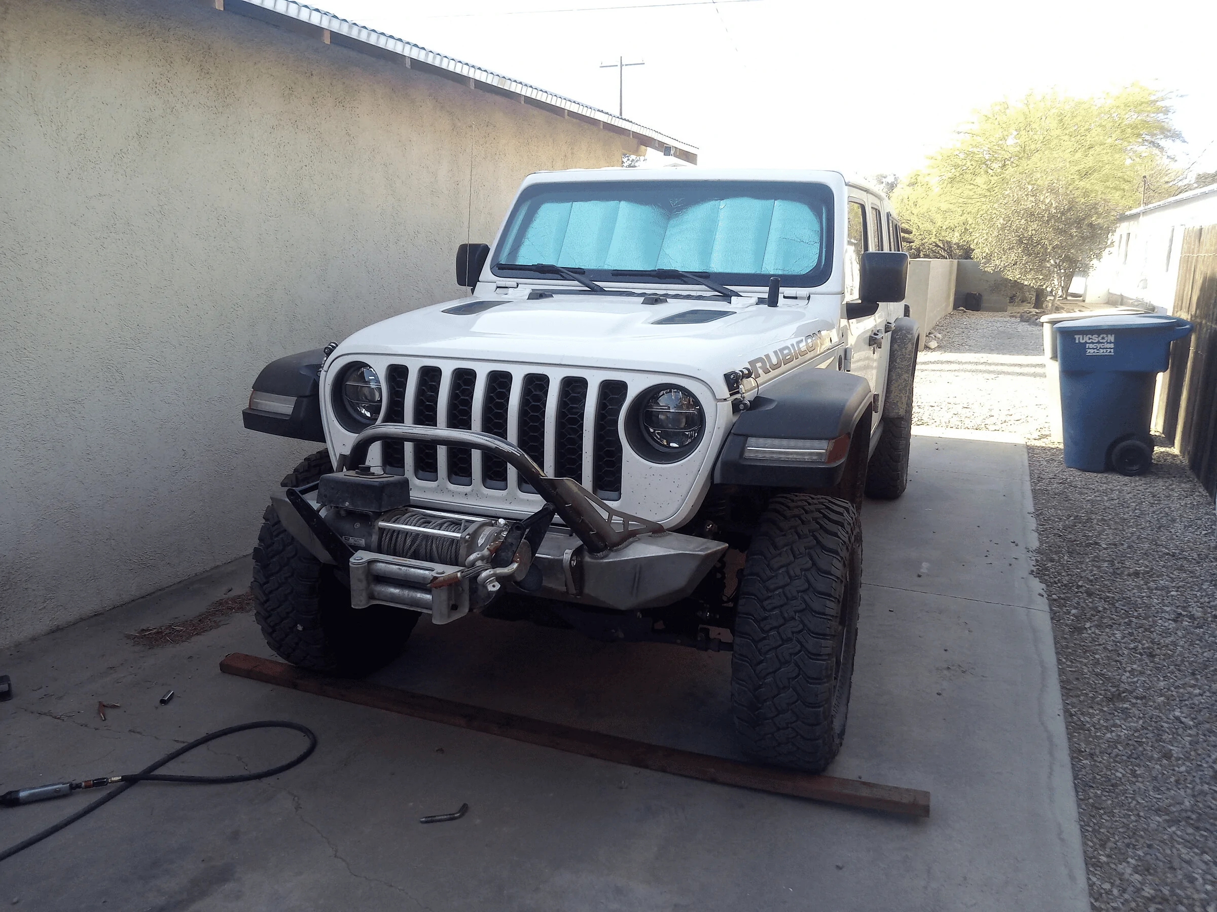

Combing the internet and can't seem to find any consensus on what size power cable to use for my winch.
Got a Warn XD9000 which has a max draw of 478 amp per their chart.
Seems like I need less the 4 feet for upfront, which means i could go a touch smaller? maybe 4ga or 1/0?

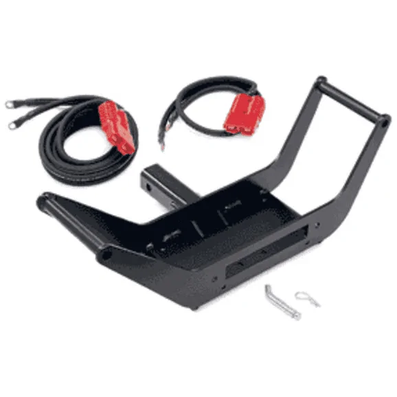

Also want to run a cable to the back of the jeep so I can use the winch as a rear pull (it's in a cradle).
So maybe 1/0 or 3/0?
Any good tips or references I can use to educate myself?

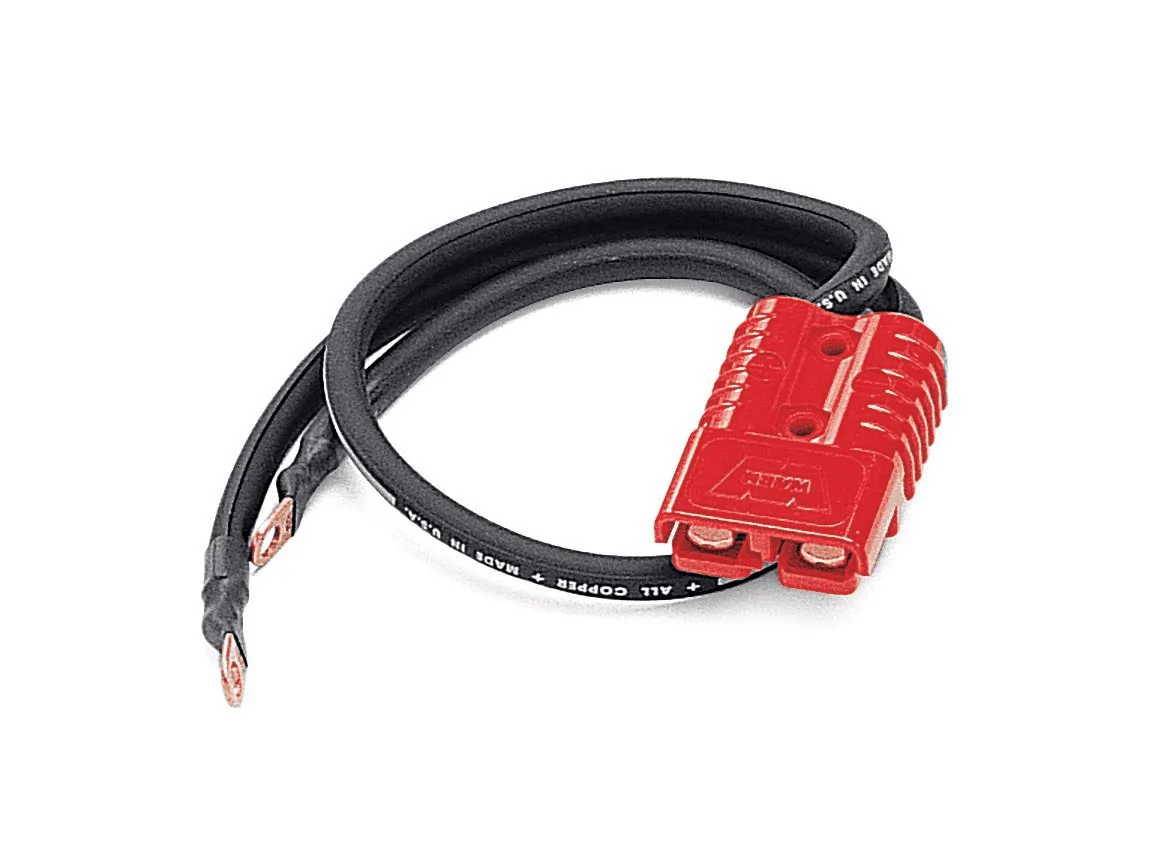

I have about 4' of cable that looks like what warn sells (black cover, joined pair, made in the USA, but it's only like 6ga, at least a 6ga lug fit over it snug before crimping.)
Please explain what you mean that it's in a cradle . You can remove the winch easily and then use for a rear recovery ? Thanks
