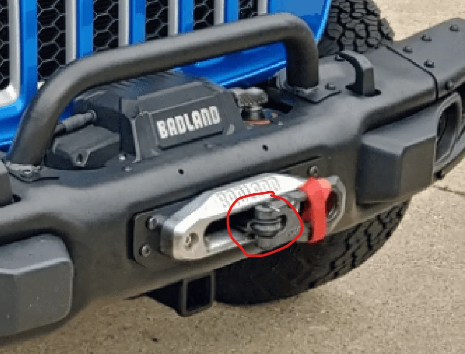

I'd be real leary about that hawse fairlead. Those look Ike pretty square or super tight radius edges on it, not good for the rope.
Will keep an eye out. Bumper should arrive in the next couple weeks....will be mounting it and pretensioning the lead at that point. Already have my sights on a fairlead/front plate mount.

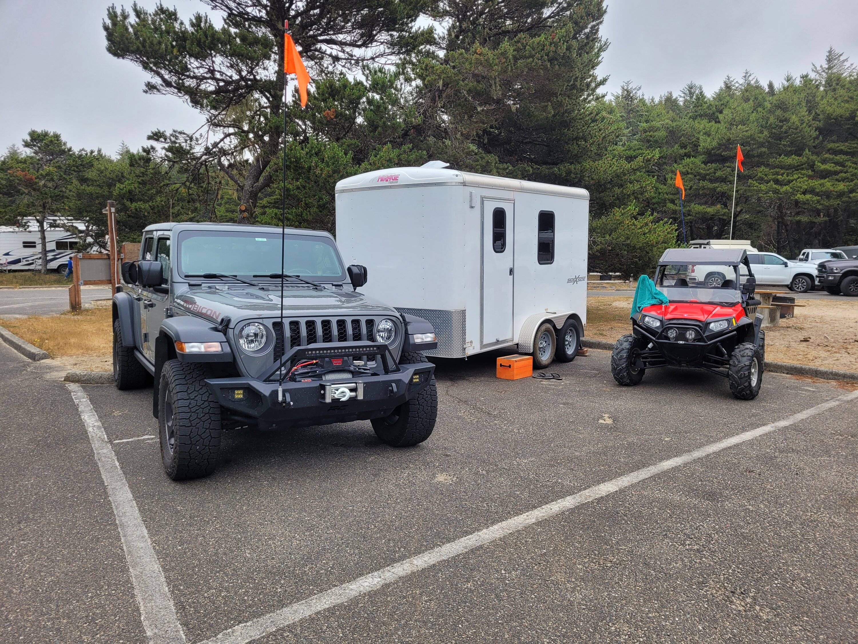

Among other things, my Gladiator is my tow vehicle. Which means it could also see time as a recovery vehicle for our toys in the sand dunes.
Jeep Gladiator Winter winch 20230706_112803
Part of the reason I went with steel cable. Sand will kill synthetic rope. I've had my cable buried in the sand trying to pull a rig back up to the top of a tree chute. You want to keep the tow rig back away from the edge so the cable naturally digs into the sand at the break over point at the top of the hill.
