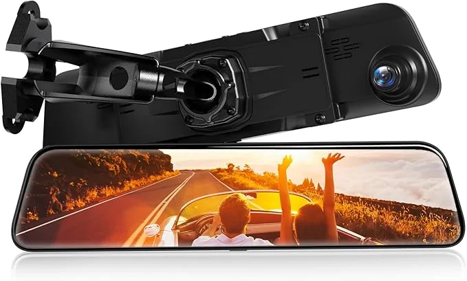

I just installed the G930 on my JT with Adaptive cruise. I am not sure if this is the case for all the G9 series kits, but I had to get an additional mount (model 179) from Wolfbox to install. I did not want to strap it to my OEM mirror. In regards to the Wolfbox mirror hitting the sun visors, I tried the 1/2" spacer trick as seen on a YouTube install but the drivers side visor still barely hits it. I might play with it some more and see if I can get it any better.
BTW- Wolfbox company is fantastic to deal with. They actually respond to emails and offered to send me the 170 bracket for free. This mount is also available on Amazon.
Bracket model 179:
Jeep Gladiator Wolfbox dash cam install with adaptive cruise. 179 bracket
Bracket model 179:
I'm in the process of installing a G930. Do you have a link to the spacer trick? I was thinking of just notching out the lower mount so I can clock it slightly to the passenger side.
I like Wolfobx products, but their accessories need help, or maybe their design team is incapable of seeing big picture.
The G930 is the only product that properly fits the Wrangler/Gladiator, or at least fits somewhat properly, with minimal blockage of view and interference with sun visors, yet you can't can't order the Jeep OEM mount for the G930? WTF? It's literally advertised as an option for vehicles that need a smaller width mirror.
The G900 line of mirrors is too large. It blocks view and prevents usage of sun visors, yet you can order an OEM mount for this mirror... stupid.
So I ordered the Gladiator appropriate #179 OEM kit for the G900 and then a #1 for the G930 in hopes I could combine the two. Turns out both kits use the same ball socket mount, but the G900 plate that the ball mount attaches to is every so slightly larger than the G930, literally only a couple millimeters larger. They could easily make the plate accept both mirrors by elongating the holes by a mm or two. Had I known this, I would have just ordered a #179 and elongated them myself instead of buying two kits. It's a simple oversight that if resolved would make things far easier for customers and more adaptable for their products.
Agreed on all points. I do wish they would package the G930 with the correct 179 bracket...AND rev the part so it fits without mirror contact. LOL
The youtube video I watched, that mentioned the 1/2 spacers, is linked here:
I bought 1/2" nylon spacers and longer screws off of Amazon. If I were to do it again (and i may go and have a run at it) I would offset the mirror bracket attach point about 3/4" to the right, passenger side of the top windshield mount.
