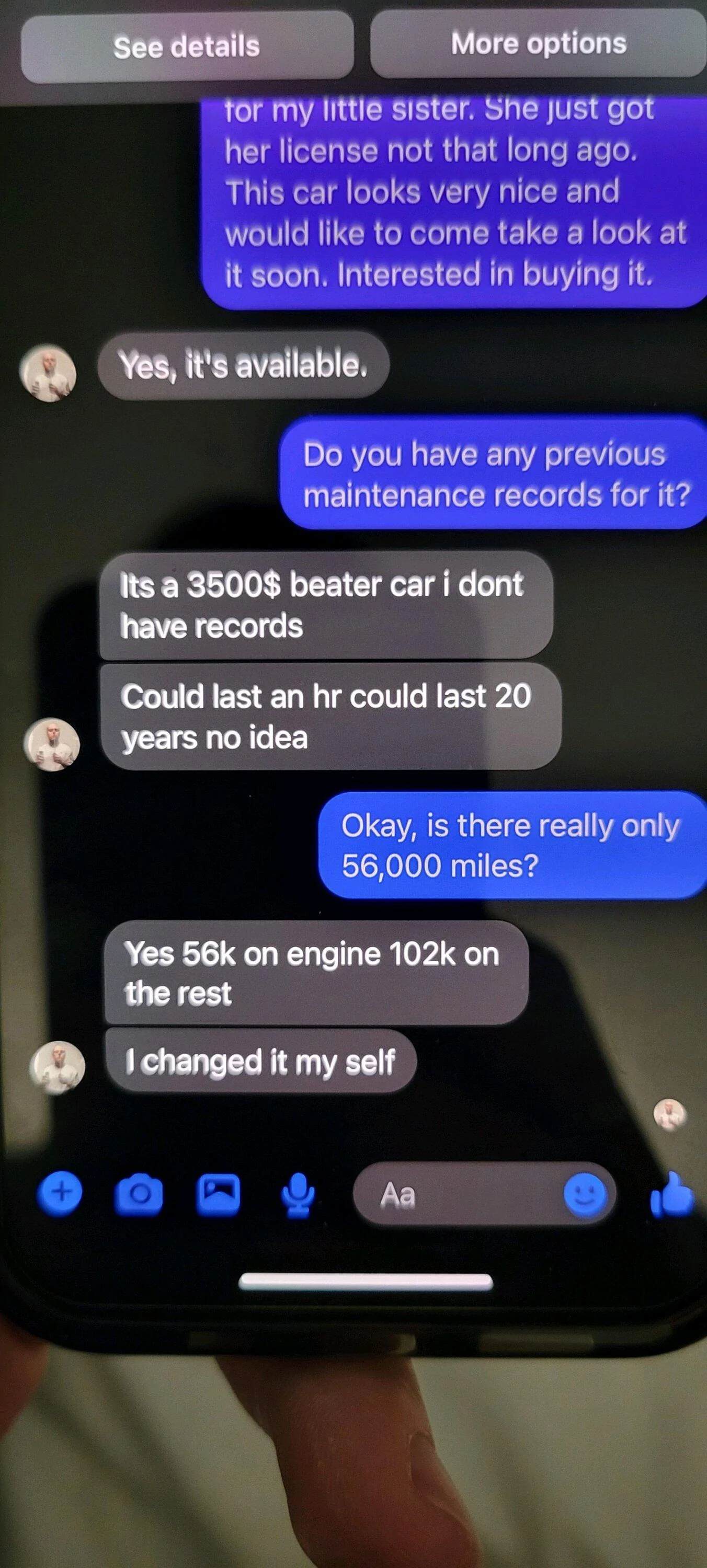

Around here a beater if what you buy from a private party for <$1,000
You may need to make it run.....
2007 Honda Fit… saw it on Zucks marketplace and told my son to look into it for his GF’s little sister
What's the pic of the conversation for?

Back in the day, beater cars were a lot cheaper.
Oh, gotcha. Yeah gone are the days of $1,000 cars to be had for $600 and a case of beer.

Plus I just thought it was funny that he said “could last an hour, could last 20 years, no idea.“ I think he dropped out of car sales 101.
