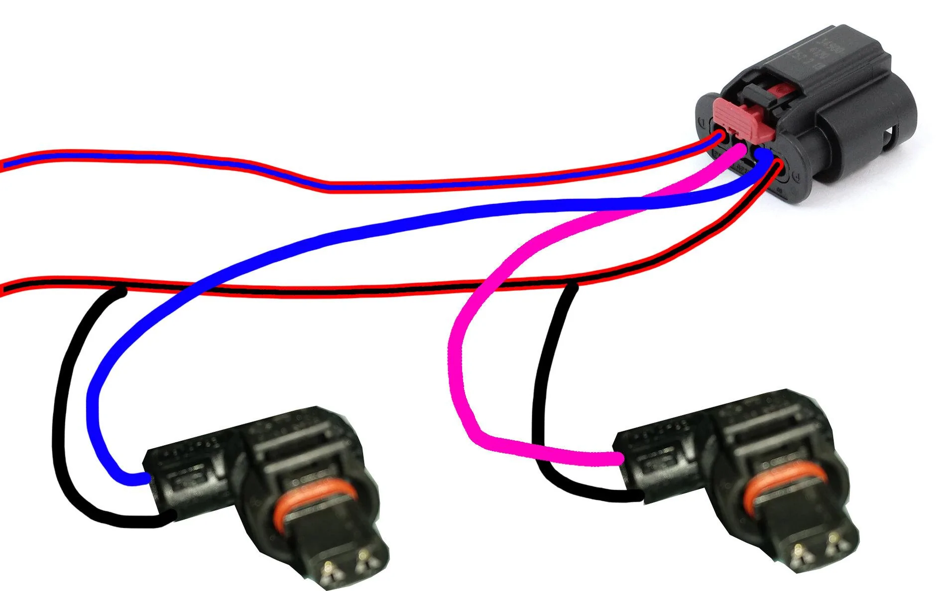

Would the rest fogs they work if wired directly to the front fog lights themselves? They wouldn’t be independently selectable but if i need my front fogs on, I want the rear ones on as well.
yeah, you could tap into them so they work as you described. You would just need to know the amp draw of the added rear fogs and make sure the fuse can handle it

So on my PPV there was no foglights and it was not turned on in the BCM. So I ran a harness from the lights to the fuse box > and used an add a fuse, jumped off from the park lights to power pin 86 at the relay(had to open the relay and solder pin 86 to the add a fuse) to make them work w/o the reflash. It was a 15 amp circuit and the LED bulbs in the foglights were only rated for like 5 amps. Its been 2 years now and no issue.
In theory you could or should be able to run the add a fuse off from the foglight fuse to provide power and then ground everything off the frame. Perk to this would be keeping that extra AUX switch open for other accessories and when ever you turn the foglights on, it should fire the rear foglights w/o issue or need for headaches/playing with the BCM.

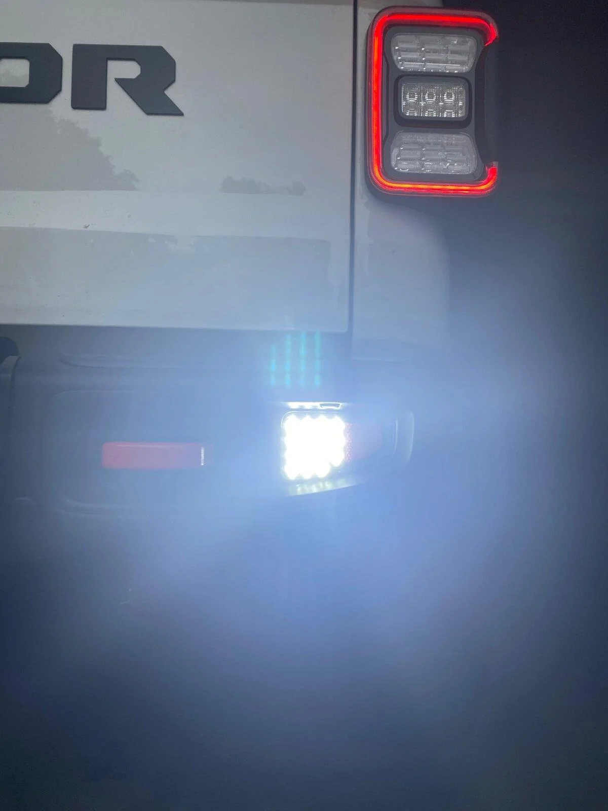

FYI this will also work if you happen to have picked up the oracle integrated rear bumper LEDs. No issues with it being wired into the BCM and you can use the fog light switch to turn them on/off
what tails are those?

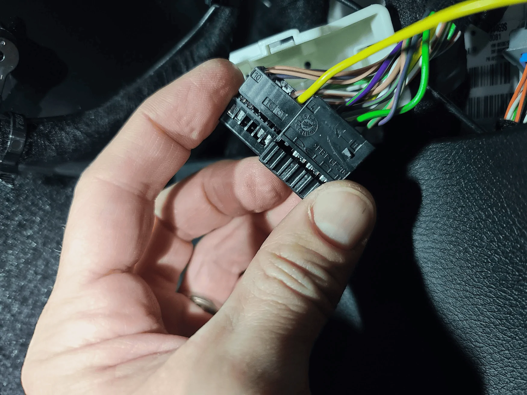

You inspired me, after much thought about adding the rear fogs, to use the BCM output for my aftermarket driving/fog lights.
I tapped into the BCM C6 pin (I just happened to have 1.2mm TE MCON receptacles) and am using that pin to switch a relay to actually power the lights. Now I don't have to use an AUX switch or a 3rd party switch: it's built right into the JT!

So my first question is, the foglights have an overlay wiring harness (which I have routed up into the cab) which only have two wires (one ground, one power supply), that feeds both lights. I assume this means I really only need to tap into one of the two BCM pins (and activate that particular pin).
