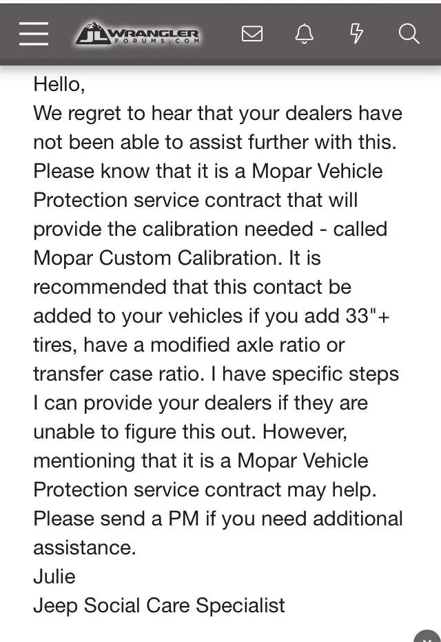

Interesting tidbit here on dealers flashing for tire size corrections in Canada. It is forbidden by transport Canada according to my dealer when I asked for it!
And you believe the dealer? I don’t trust much of anything a dealer says. You know FCA actually put out instructions to their dealers on how to correctly program for tire size, along with the number of labor hours to charge the customer?
Jeep Gladiator Wrong Gear Ratio Factory Installed 35’s 1E4FEF07-2863-4492-87D4-EAE7CDB85146
Jeep Gladiator Wrong Gear Ratio Factory Installed 35’s FF4CB617-30A6-4A53-83FC-51061FFCA14F
Yeah a lot of dealers just don't want mess with it for whatever reason and lie to their customers, not sure what the logic is there. Hendricks told me they would flash it for free if it's under warranty if I decided to add larger tires. I had already added the tires and got the JScan before I knew that. They did however flash it for the led bulbs I put in the tail lights to turn the turn signal light out warning light off the dash at my last oil change and did it for free.
Yes, FCA can do whatever they like in the the US according to US regulations.
However, in Canada it is FCC and they must follow Transport Canada Regulations.
In this case I do trust the dealer. The sales manager I dealt with has a 2020 Wrangler with larger than factory tires and referred me to an aftermarket shop that sells the Tazer. That is how she got her tire sizes adjusted.
The field for adjusting tire sizes in the factory software provided to the dealer is greyed out.
