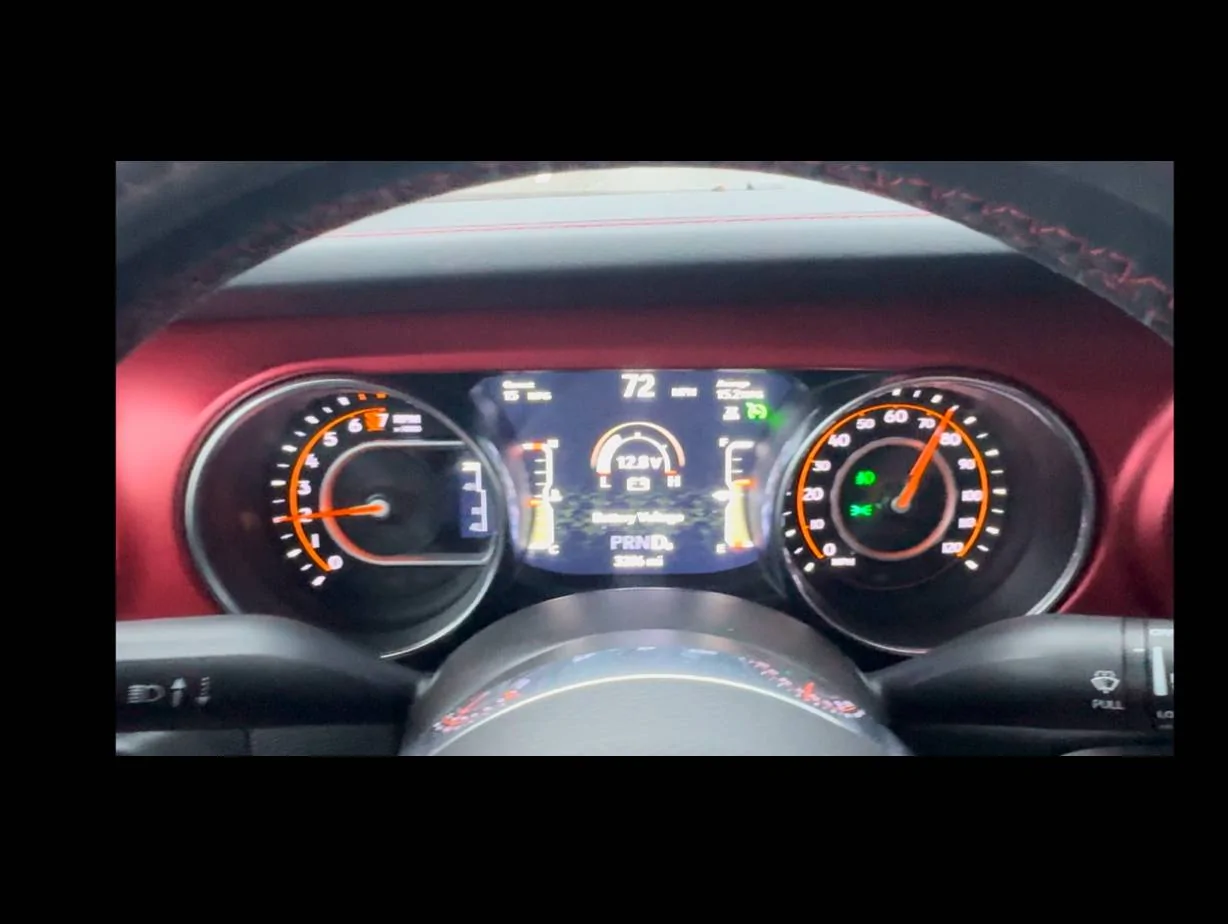

I started my truck and the battery red 12.8 V I understand that that is normal however high speeds with the RPMs above it never charged above that and prior to the battery typically 13.4 V or higher.
I drove it on the highway at 70 miles an hour at or above 2000 RPMs and the battery voltage never went up.
There was no draw on the system as I had. The headlights turned off. The climate control was turned off no electronic devices were charging and I even turned the screen off just to see if the battery would start charging above 12.8 V.

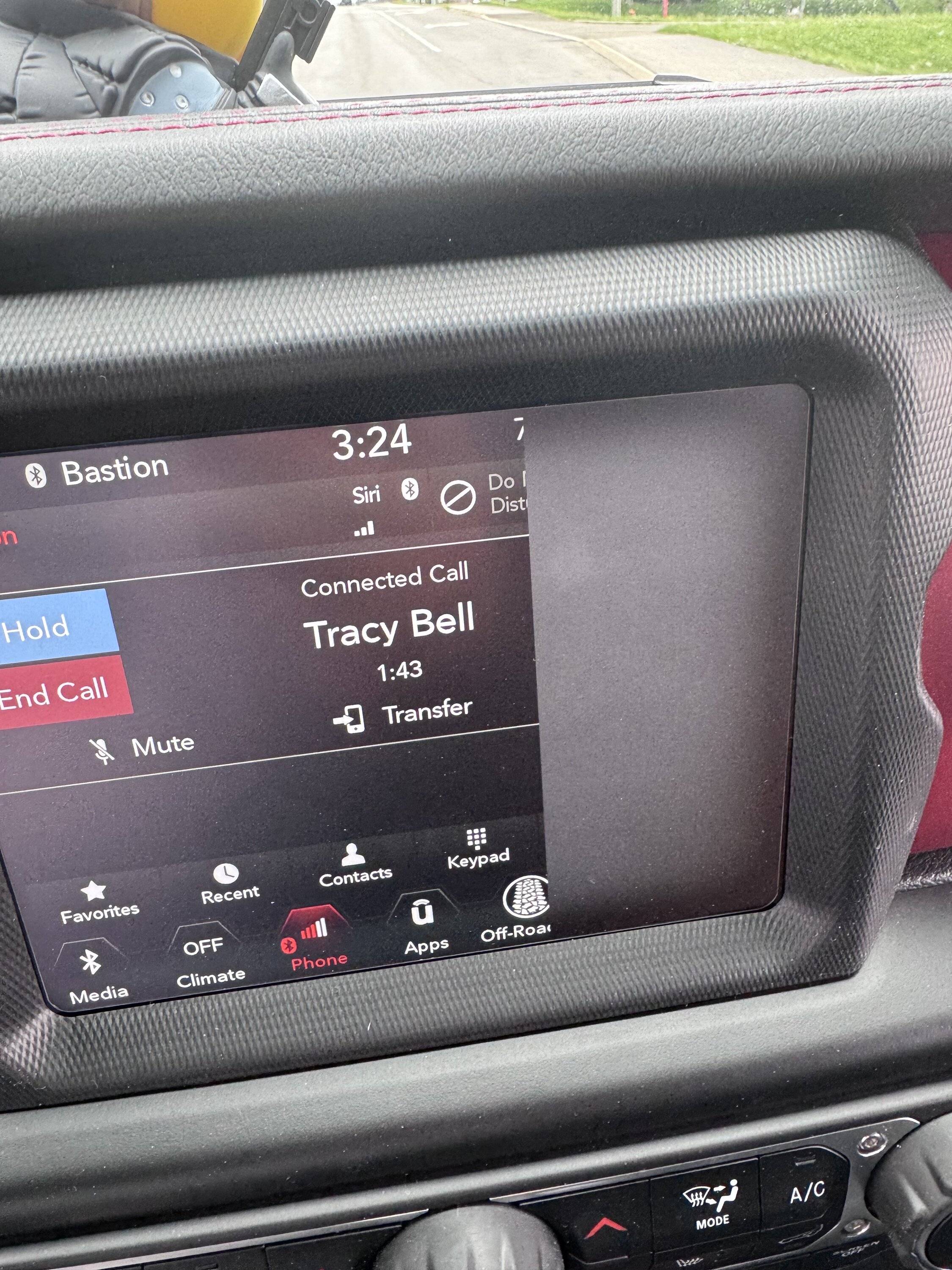

The following day, my screen had almost almost half of it turned white, gradually became black and then was all black. It did respond to touch input and then about two hours later, it returned to normal.

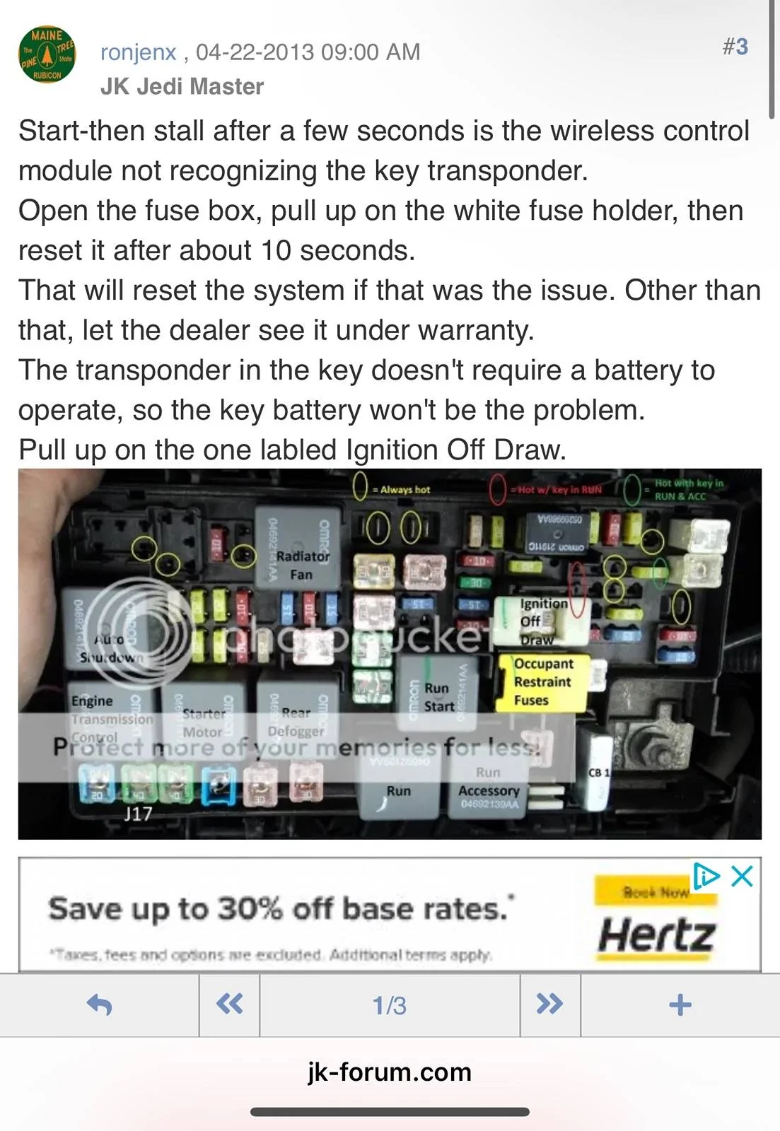

I have read online that there’s a wireless transponder is not reading the key fob correctly and my start/ stop battery and or main battery is done.
I do find it hard to believe that either battery would be dead by now, but it is a possibility as it’s likely that my truck sat on a dealer lot for several months without being started.
do you guys have any suggestions other than pulling the transponder for the short time mentioned in the picture above? I’m going to take my battery in and have it tested, but I have a feeling it’s likely toast.
