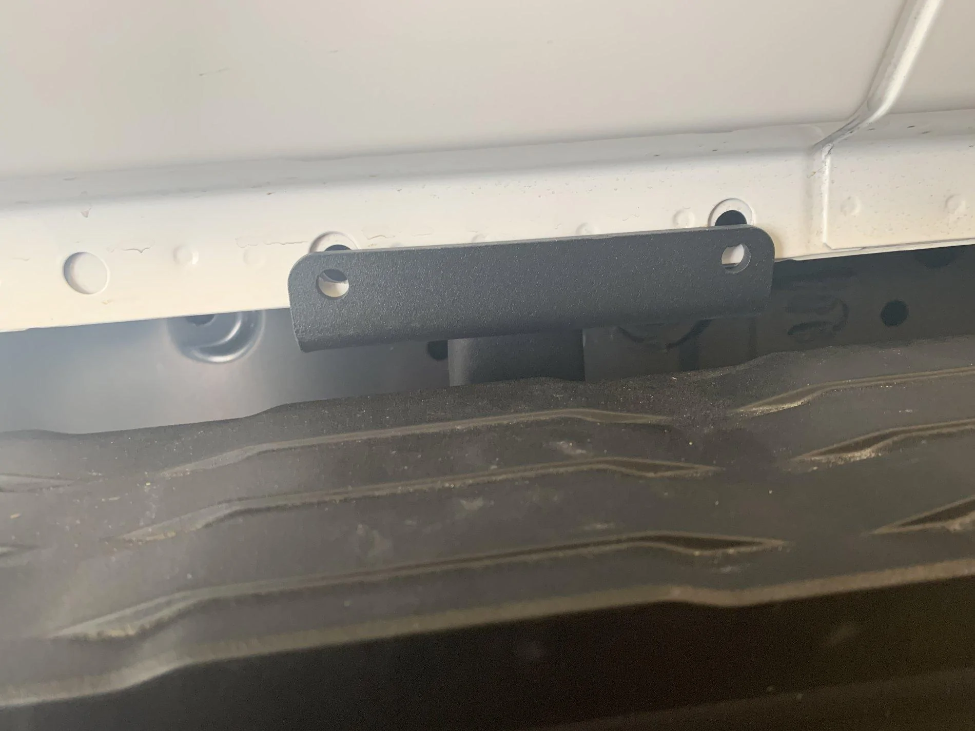

So Im returning the bars. Go rhino has sent me 5 additional sets of brackets and none of them work. Just fed up with them not being able to figure it out, they were overall “nice” but not capable of fixing the issue and finding brackets that fit in the 3rd slot. Pretty frustrated because I liked the bars and price....
I have attached a picture of how the final bracket lined up...
I most likely will not be a go rhino customer again in fear of having a problem and them not being able to figure out how to fix it.

Did you loosen up the rest of the other brackets and try to fit it? Are the brackets for the other slots position dependent and if not, can you swap positions with another bracket to see if it fits?
Find it hard to believe that if they engineered and shown in a early stock photo a bracket for that position, they cannot get you one that would not fit.

yep tried to loosen all of them. To be honest there is not much play and the other 3 fit perfectly flush.
with the original 3 brackets there is two that are the same... they go in positions 1&2. The other goes in position 4. Initially they said it should be the same as as the forth bracket.. but that didn’t work.
I didn’t try to switch them around because honest I didn’t try. I now have a box with 10 extra brackets. I have 16 total to send back. Out of the 16 total I have 5 different brackets... I just didn’t have the time to switch and bolt on 5 different brackets in 4 different slots.. which could be how many combinations? I’m just moving on and frustrated!

Just spit balling this out there as a suggestion. Maybe try a piece of wood on top of a jack on the bottom side and slowly jack up to see if it flexes enough to go into position and bolt in? I have installed various other side step and rails on various vehicle over the years and "massaging" a piece into place was not uncommon.

Tried that, the issue is the way the under mount bolt attaches it lowers the outer holes. You would actually have to manipulate (somehow reform) the bracket to make it work. Additionally the bracket sits longer from past the side of the step and it looks bad

Obviously the bracket isn't made for that location, the only reason they sent it was because you demanded it.
Hole spacing, and overall design isn't necessarily universal, they would have had to design and manufacture a bracket specific to that location, which adds significantly to cost (r&d ain't free)
You're making it sound like they are incompetent, when you are asking for a special accommodation, which is pretty shitty.
If the CS person who is trying to make you happy had gone to engineering they probably would have found out there is no bracket for that location, because they didn't design one for that location. Things are not always as simple as they sound
