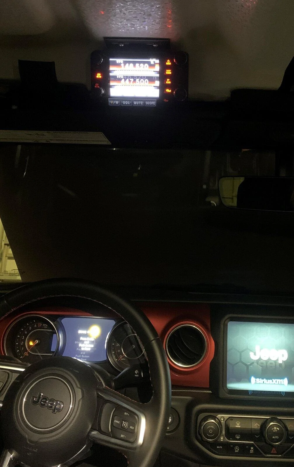

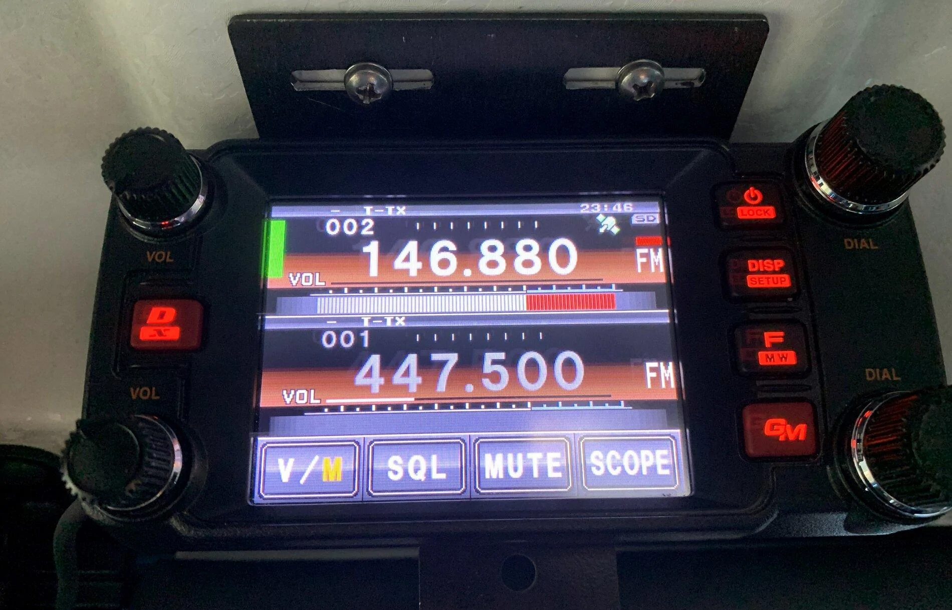

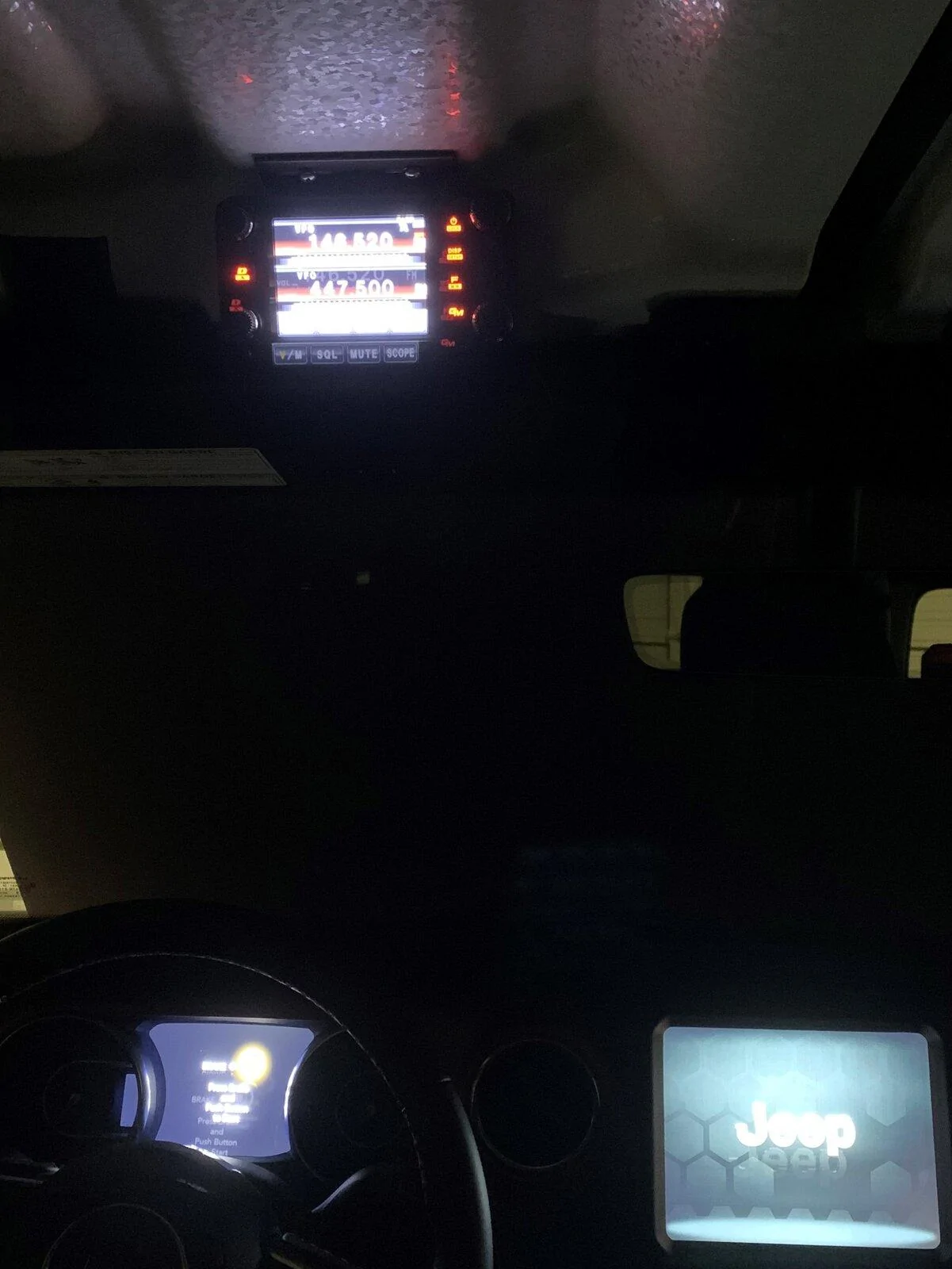

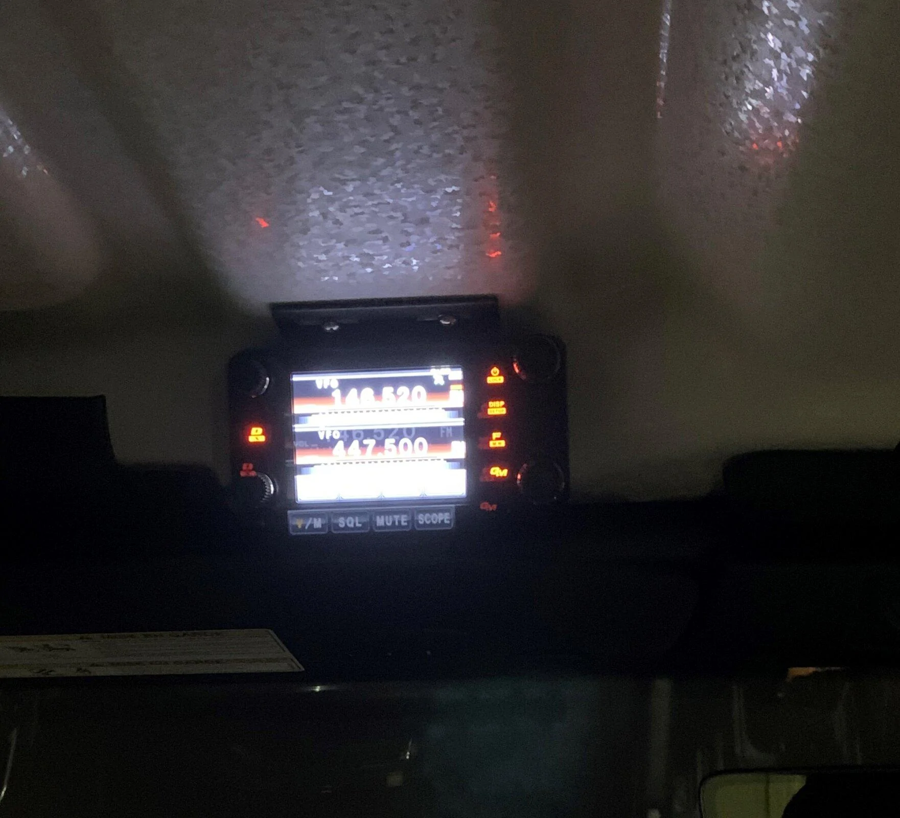

Installing a Yaesu FTM-400 this is the control head have not mounted the transceiver.
Any others with radios if so where did you mount the radios and or antennas.
I would love to see pictures of other radio installs
Jeep Gladiator Yaesu FTM-400 install IMG_0674
Jeep Gladiator Yaesu FTM-400 install IMG_0675
Jeep Gladiator Yaesu FTM-400 install IMG_0677

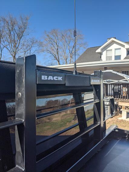

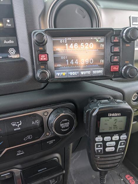

FTM400. Head on Grab bar and deck behind seat. Have a back rack with my antenna on it.
Jeep Gladiator Yaesu FTM-400 install ftm400
Jeep Gladiator Yaesu FTM-400 install backack

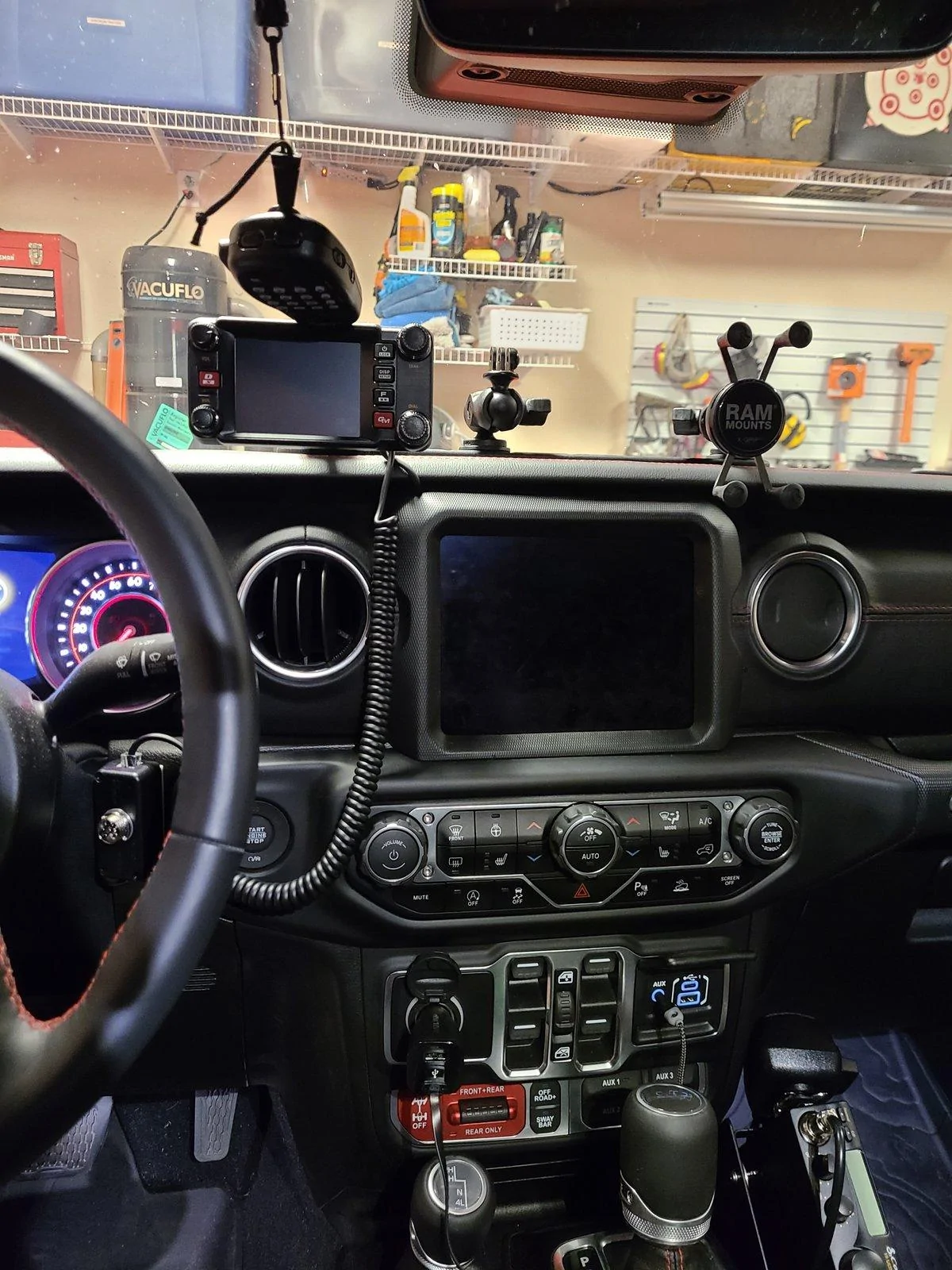

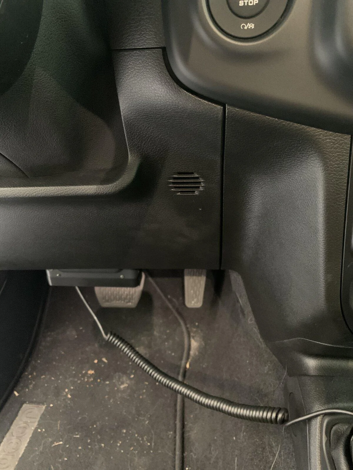

I have the FTM-100 but mounted the deck under the steering wheel.
Jeep Gladiator Yaesu FTM-400 install 14696067-E4F0-4A6F-AB15-C51F97CC4F14
Jeep Gladiator Yaesu FTM-400 install DB07E9EA-F7DA-48A8-9077-DEE17CF912B0

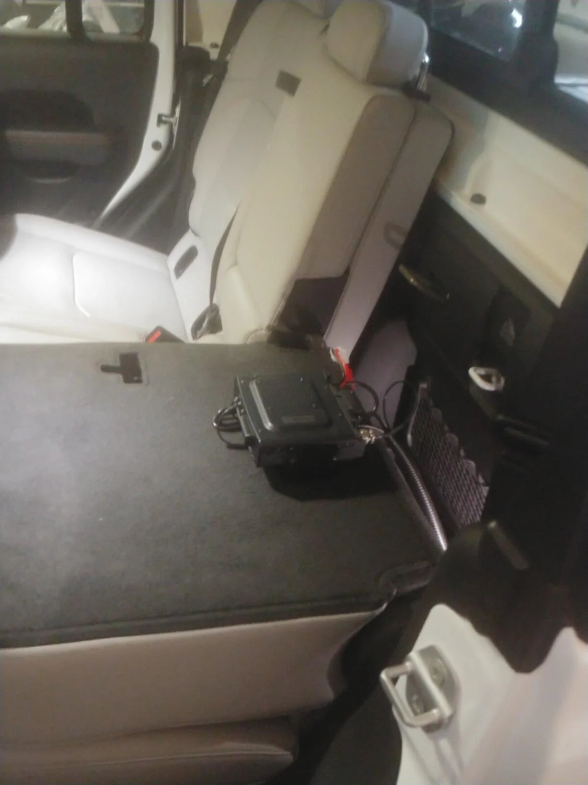

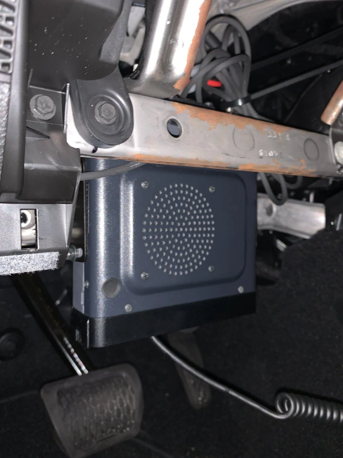

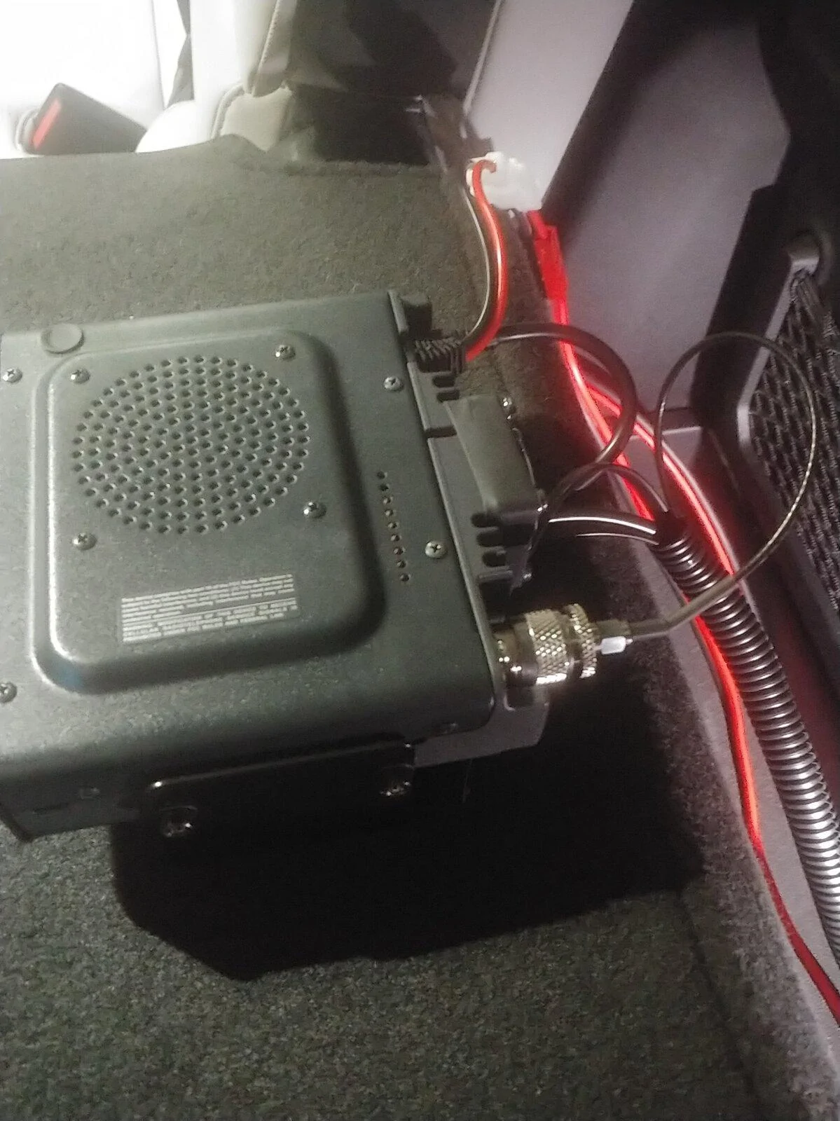

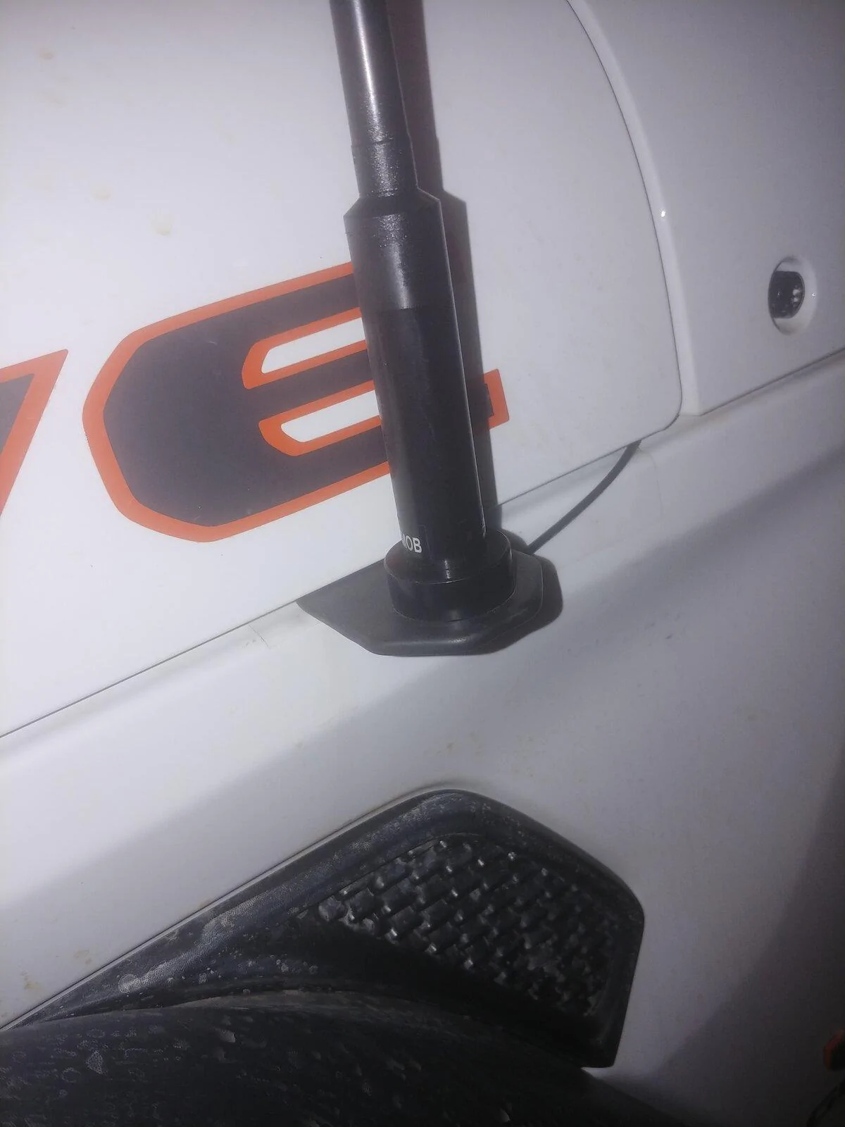

Radio behind rear seat, topsy hood mount, diamond antenna.
Jeep Gladiator Yaesu FTM-400 install 20210101_135805
Highly recommend this antenna as it does not need a ground and jeeps are remarkably scarce in that area.

Dipped the mount In plasti dip. Took 4 dips. Has a nice clean look.

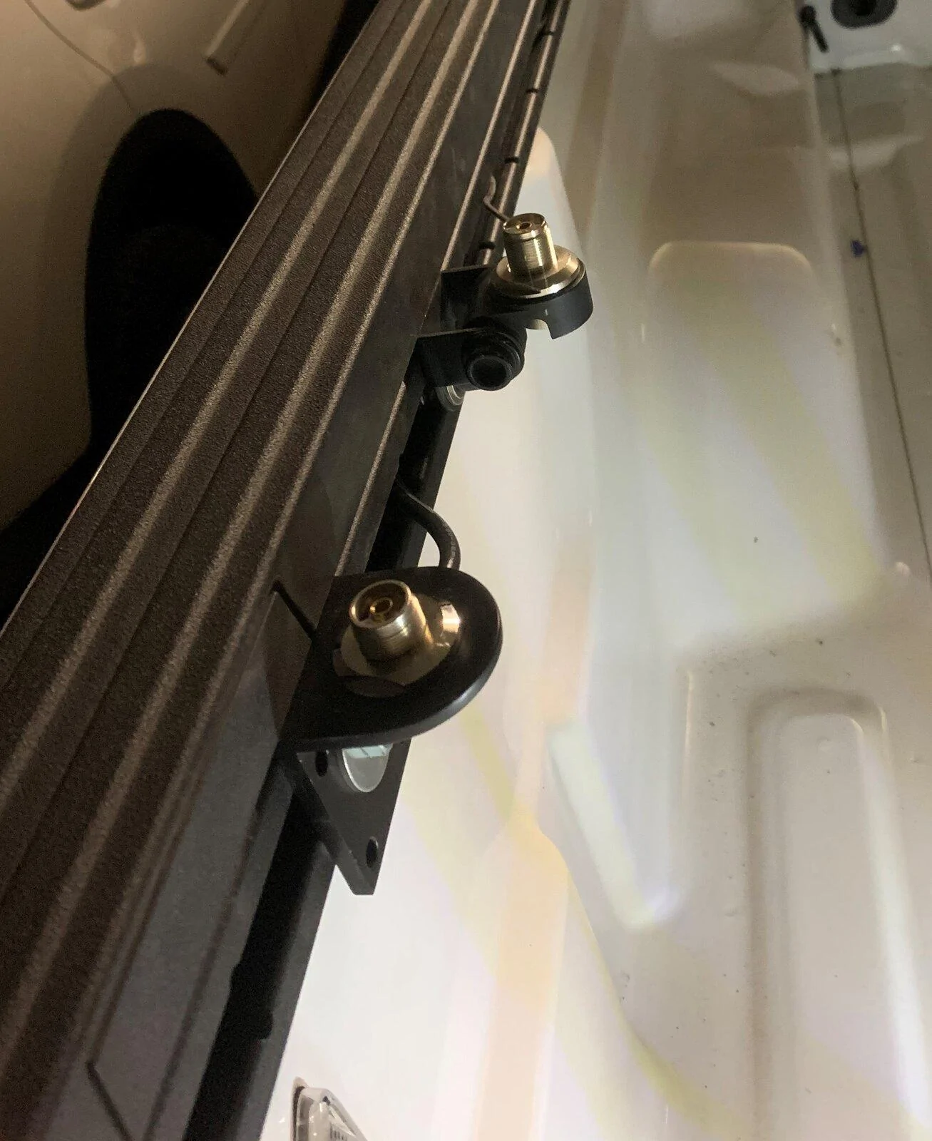

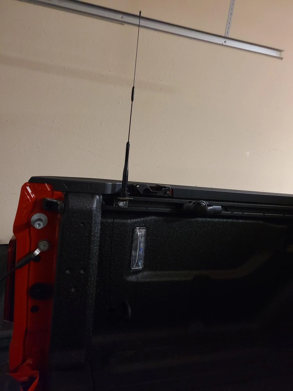

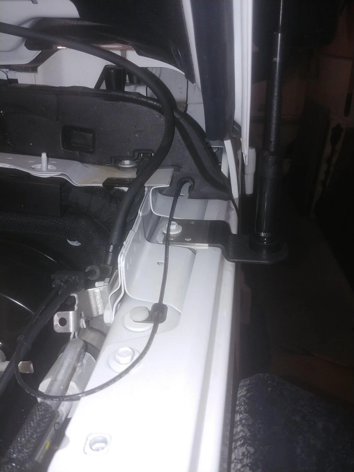

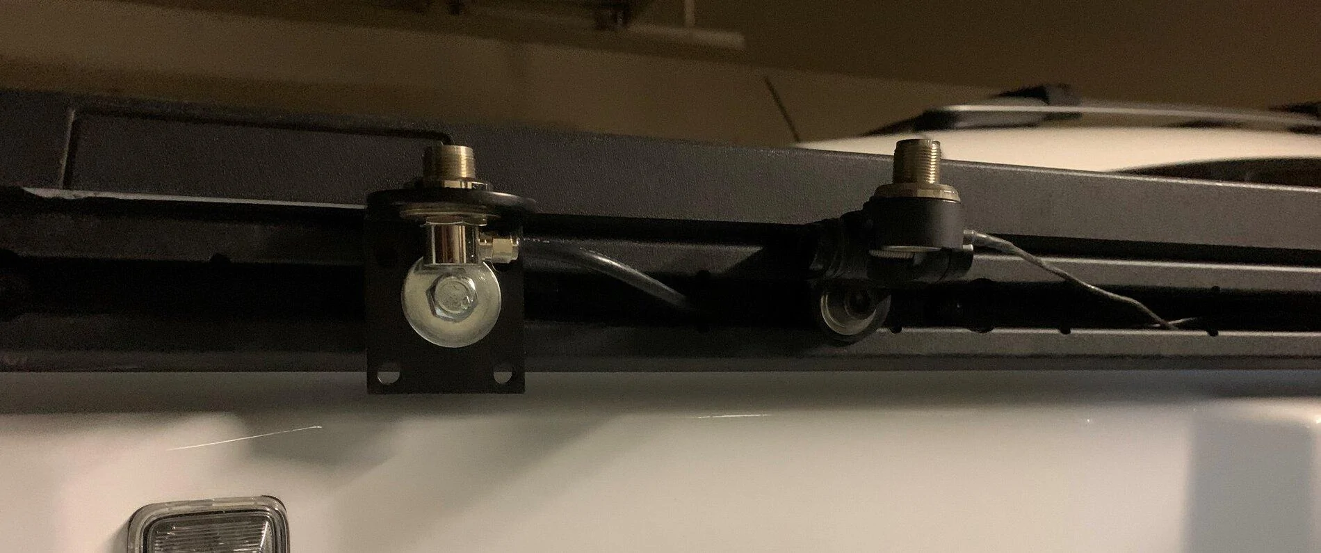

I installed the antenna mounts today
Jeep Gladiator Yaesu FTM-400 install IMG_0687
Jeep Gladiator Yaesu FTM-400 install IMG_0688

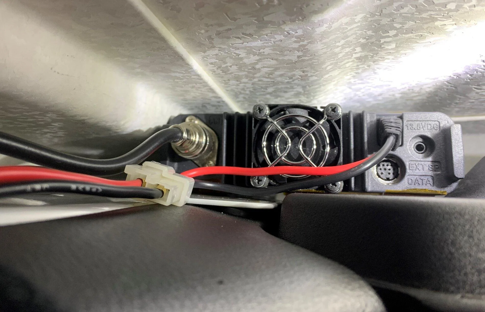

Installed the antenna and radio went for a test drive to mount Lemmon. I put the radio on top of the cross bream behind the driver.

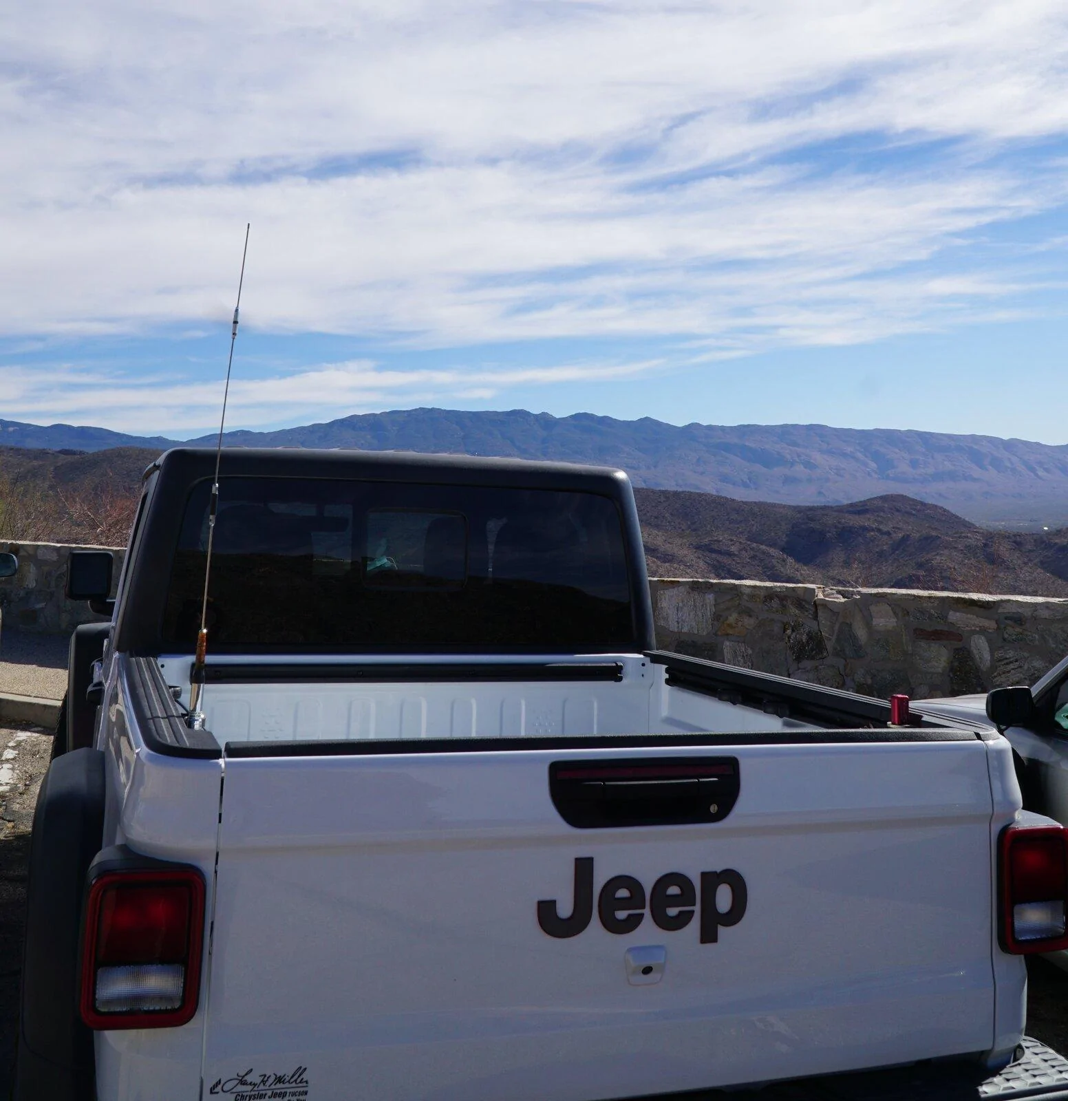

Right now my antenna is mounted in the bed but I plan on moving it up front so I can get a cap or roll bar
Jeep Gladiator Yaesu FTM-400 install 20201001_195906-jpg

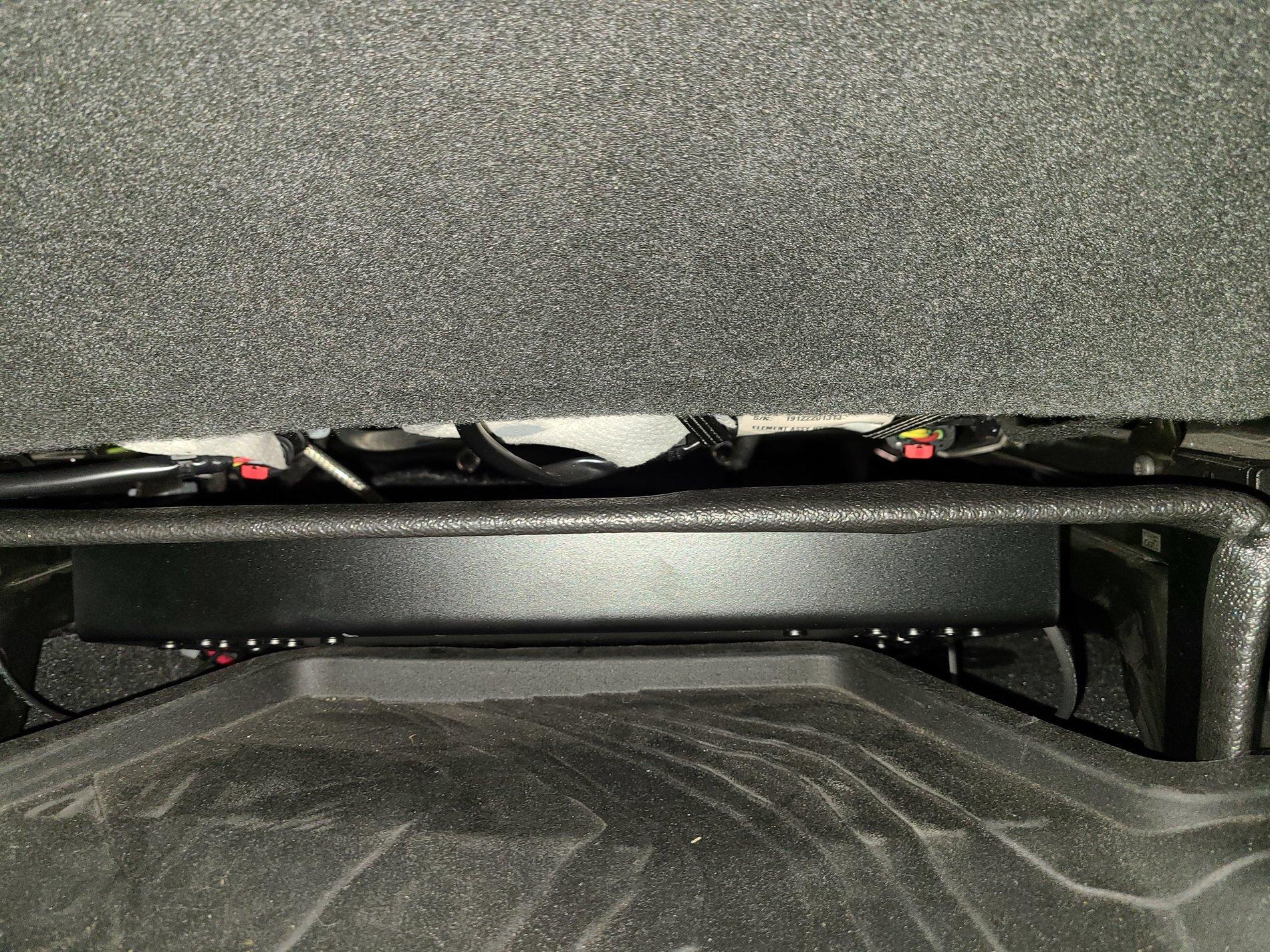

This is an amp mount for the JT that I mounted the radio to..it goes under the passenger seat

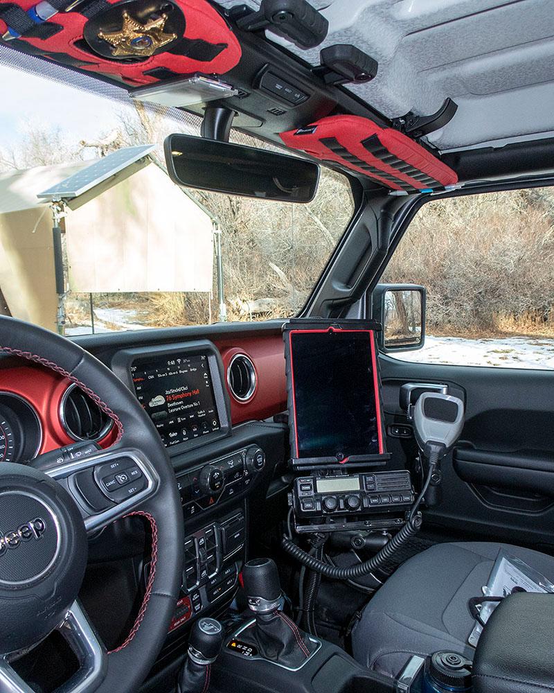

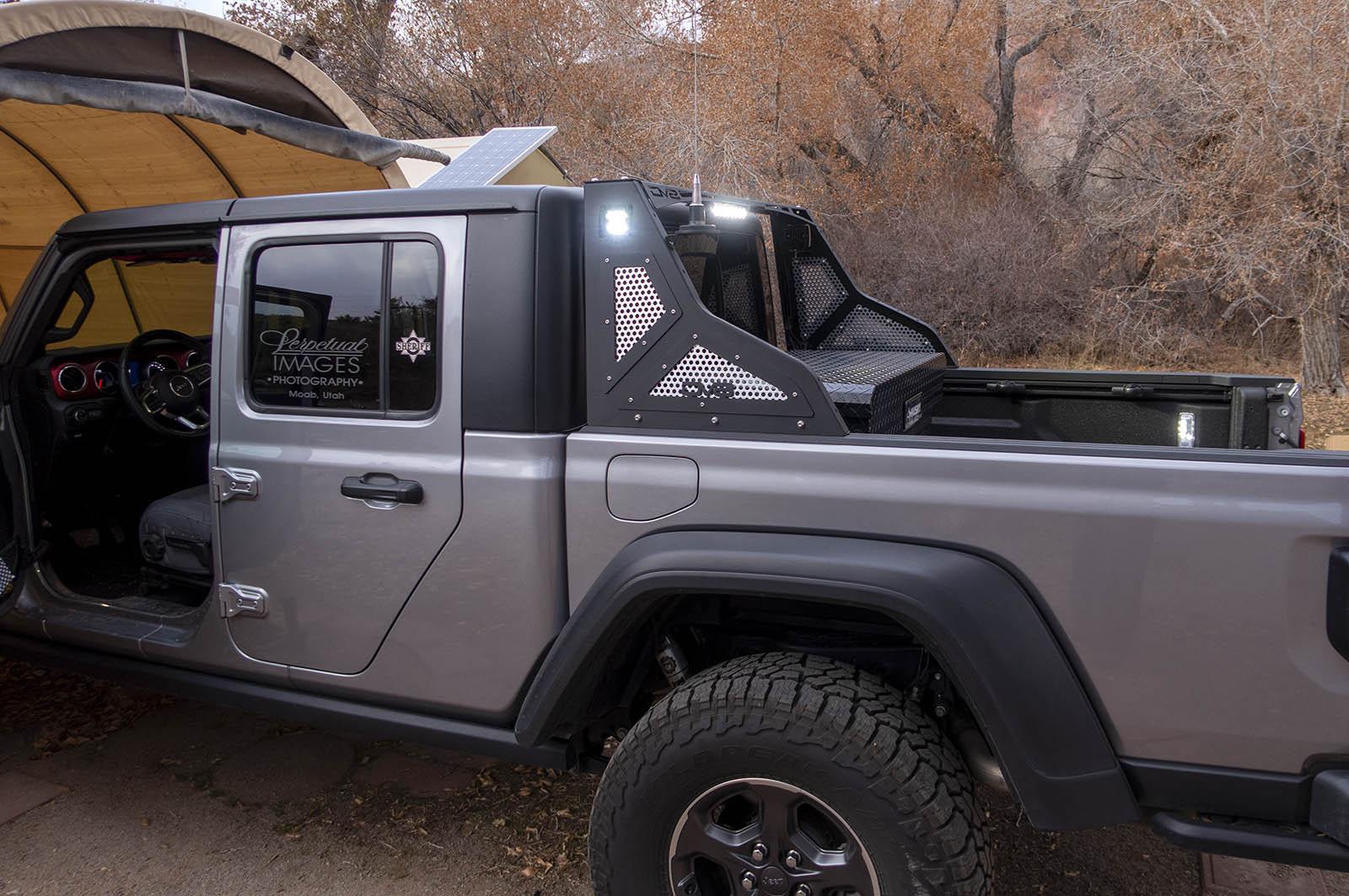

Not a Yaesu (it's a 100-watt Vertex), but shows another mounting option using RAM Mount components. The control head is mounted on the stalk attached to a seat-mount bolt with the rest of the radio under the passenger seat.
Jeep Gladiator Yaesu FTM-400 install vertex mount

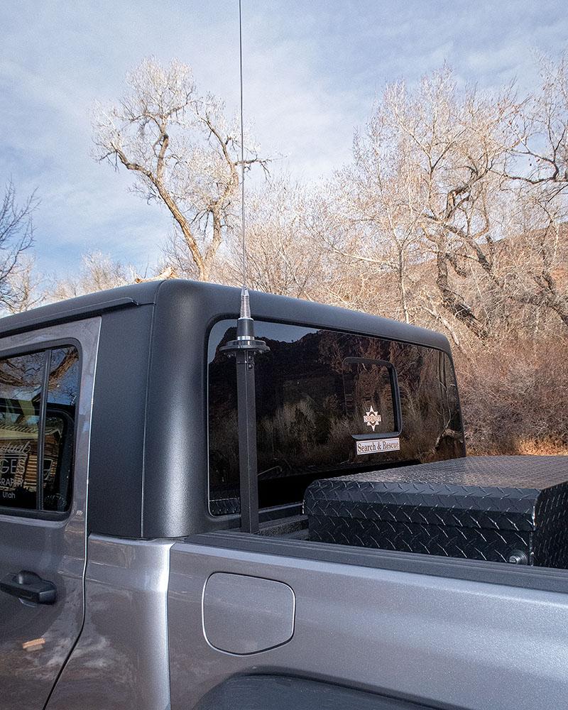

Original antenna mount:
Jeep Gladiator Yaesu FTM-400 install antenna
current antenna mount on chase rack:
Jeep Gladiator Yaesu FTM-400 install LetThereBe

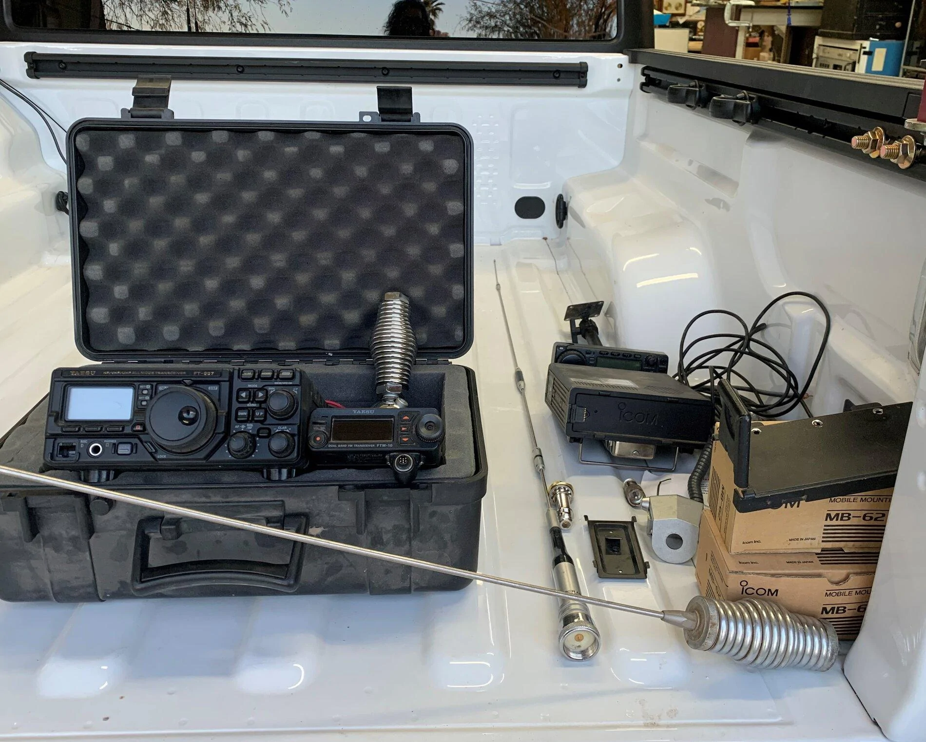

Thanks for all the pictures gives me ideas. I have a couple of HF radios that I am going to mount.
Jeep Gladiator Yaesu FTM-400 install IMG_0733
It kills me that I didn't think of this and now I'm stealing it. I ended up using a little Xpel film under the mount to prevent damage and now that I'm moving it, I have to clean up the leftover adhesive.
MrZappo
Tom
Aug 9, 2020
780
1,872
Granger, Indiana
Gladiator Mojave
Computer Consultant
Hey, I get something right once in a while ...
For reference, it worked best with the liquid (not spray) plastidip ... And it took 4 dips (30 mins apart).
The first 2 dips I hung the mount from a hanger. The last 2 I inverted it and put in a vice ...
If you dont do this you get a fatter blob at the bottom ... It ends up being relatively uniform if you do what I did in this case ...
Hope it helps ... Send pics when you finish !
What are you using for the original antenna mount? That looks real interesting to me
Moabite
Sep 26, 2018
357
665
Moab
2020 JT Rubicon
I made the original mount out of 1" square aluminum tubing with a steel plate attached to the top with small brackets. It was bolted to the 2 holes in the front of the bed.
