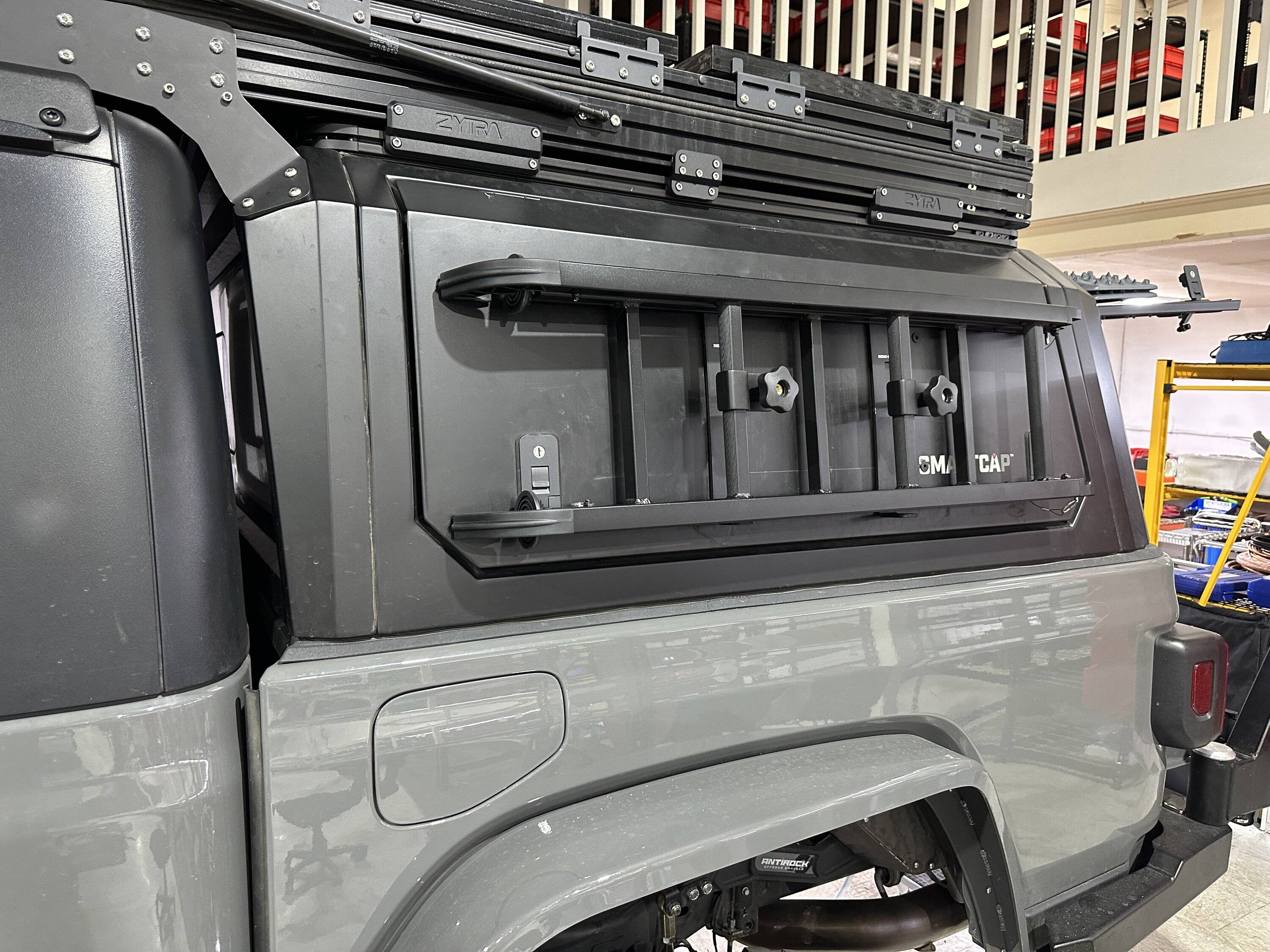

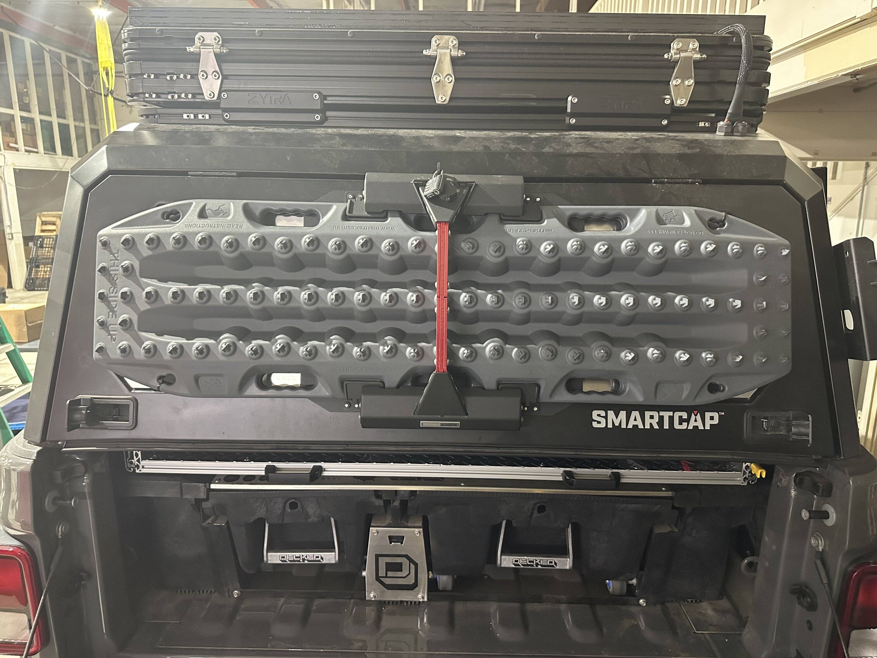

I previously had the traction board mount on the driver side window of the RSI.
The main issue I had with this was the board covered the latches. Which means the only way to open that window was to remove the traction boards. Impractical, which means I was basically never opening that window.

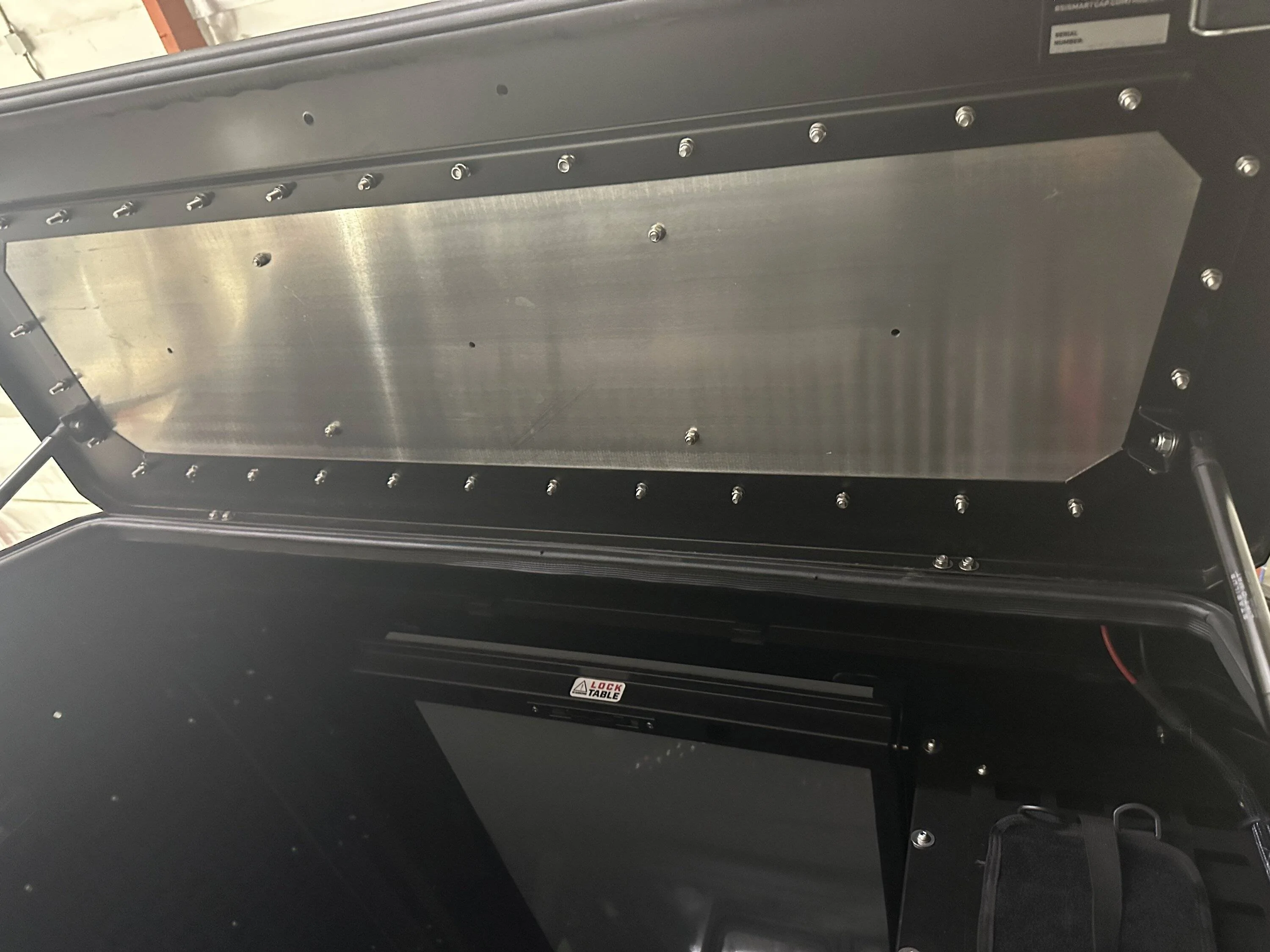

Considering I have absolutely no visibility in the rear view mirror (in fact I deleted it long ago), I decided to remove the glass window of the RSI rear window. I laser cut a replacement out of 3/16" aluminum with mounting holes around the perimeter. Mounted it with silicon washer for sealing.
That aluminum panel is bigger than the side windows and host the traction boards perfectly without blocking access to the latches. That panel will be painted black and add a couple beads of RTV to seal it. On the inside of the panel, I'll mount the molly panel that was on the passenger RSI window, which is useless when the kitcken is mounted on that side.
I am going to mount the RTT ladder (rhino rack) to the left side panel, which means one less thing to carry inside the bed.
I need to take more pictures, maybe a quick video, to show the 500lbs capacity drawer I designed for the bed. Getting stuff in and out of the bed is a pain - reason why I bought a deck system in the first place - and pushed it further with something low profile that sits just above the Deck drawers and give me access to the entire bed without having to climb in the bed. You can see a little bit of it in the first picture below.
