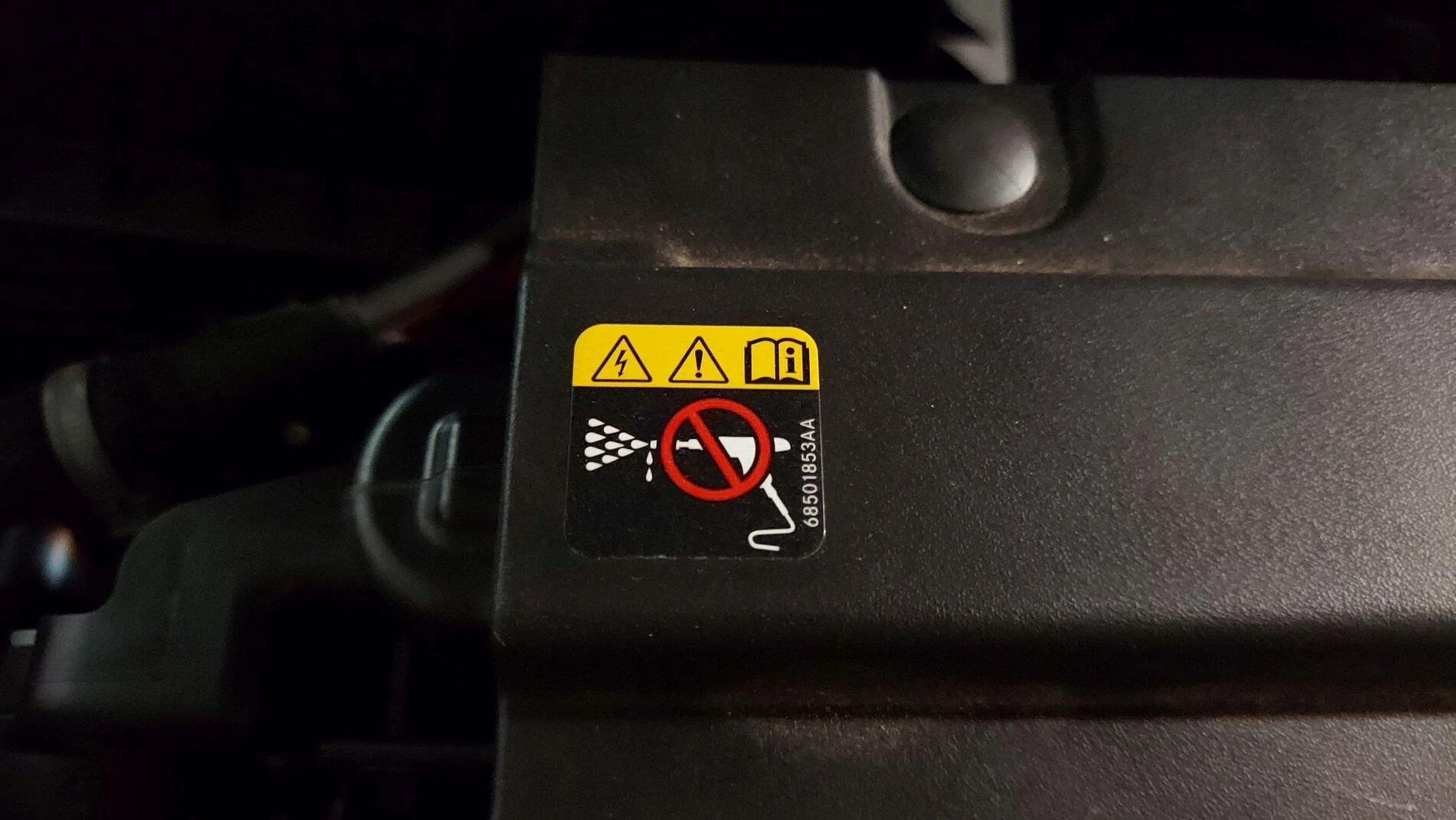

If these are subject to failure when getting wet, they must place a clear warning under the hood - CAUTION, DO NOT WASH THIS ENGINE!
haha, funny you mention this. I just noticed yesterday, there is a little sticker by the prop rod hole...
Unreal - so small, and so silly, because we've been washing engines for decades, including those with the old fashioned distributors.
It's probably like the warnings about drinking battery acid - gotta put a sticker there because someone is going to put the end of the nozzle right into the electric connections or into the back of the alternator.
That sticker is just for pressure washing. You can wash it all you want, just not with a high pressure washer. The owners manual explicitly says pressure washing not recommended in the engine bay, and that is a picture of a pressure washer.
