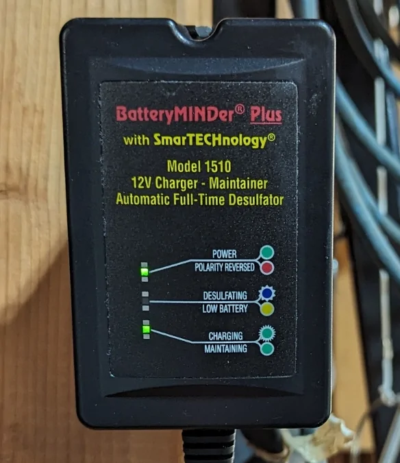

I don't drive my Gladiator very often. I think it has 3,400 miles on it (December 2023 build date). It's not uncommon for it to sit for a month or two without being started. You would think the OE batteries would be toast, but I keep them maintained. I highly recommend keeping your Jeep on a battery maintainer when not driving it. I usually get 9+ years out of the factory batteries by keeping them maintained.
Note: I have noticed that it takes much longer to charge the dual battery system in the Gladiator.
Is the above pictured your setup? I was just curious how you wired that all up. I have a car that i drive at most 500 miles a year but keep it plugged in almost always. Battery is 12 years old no issues. I'd like to get my Jeep wired like yours but was curious how you did it. Less questioning the ports in the bumper that's strait forward but did you run the leads separately to each battery or just connect to the main or just aux etc?
Yes
Let me preface this by saying that I'm not a battery expert, so take what I say with a grain of salt. Based on my narrow understanding, you can charge the main battery by itself, and it will keep the auxiliary battery maintained. The reason why is because the main battery and auxiliary battery are already wired together in parallel.
To answer your question, I used a BatteryMINDer Ring Terminal Assembly, BatteryMINDer DC Extension Cable, and BatteryMINDer Flush-Mount EZ Connector. I plug in the Jeep once every two weeks for about 3 days of charging/maintaining/desulfating. So far, I've had no issues. The Jeep sometimes sits for 30 - 60 days at a time.

Yes
Yes, what he said ^^^^ the batteries are in parallel so connecting to one would charge the other.
By the way, really like that connection setup! Neat and clean and simple as heck to use.
