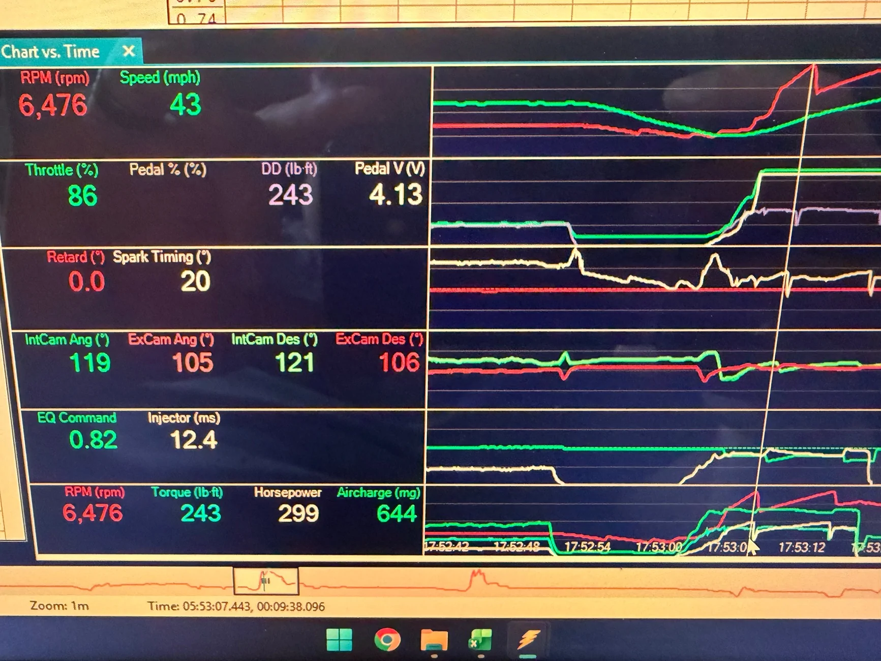

I own a 2025 3.6 JL Auto after previously owning a 2020 and a 2018. The GPEC5 (2022 ish and newer) Wranglers and Gladiators suffer from a hesitation/stutter/misfire at low load/low RPM situations. Brand new off the showroom floor I noticed the issue. Most noticeably felt between 3rd and 4th gear at RPMS below 2000, but can also be felt at highway cruising speeds in the same area. They also have a terribly uneven power band at low throttle.
One of my side gigs for the last few years has been tuning. Mostly Ford Ecoboost platform and some occasional GM. I have tuned 100s of vehicles both remotely and in person. I am OCD about the way my own vehicles drive. I spent a ton of money on training courses and took nearly every single one I could find. Tuning/calibrating has essentially consumed my free time for the past few years.
A Jeep mastertech on the JL forum (shout out to @alphawolff) dealt with this issue and determined it was a tuning problem, but no one had a fix, not even Jeep. Jeep Cares and their tech support area has known about this since as early as 2023 and they have not been able to fix it.
Within a few days of testing and development, I found the "stutter" problem. Here is a brief summary:
JL Wranglers and Gladiators with the PUG (2nd gen) Pentastar 3.6 have new features, namely VVL and an EGR system. For years, people said the VVL was like Honda VTEC, activating at high load/high RPM to increase power. I discovered that is NOT the case. At no point in a wide open throttle run do these us "high lift". The ONLY time VVL is active is low load/low RPM situations. VVL is activated by cutting the 12 volt power supply to the VVL solenoids. When these solenoids are deactivated, the high lift mode engages, locking out the center rocker of our complex rocker arms. The way this system is set up paired with poor VVT mapping, torque management, spark mapping, and 8 speed transmission mapping focused on economy, makes driving these a sluggish experience.
I have corrected these issues and more by developing FULL TUNING on the whole platform for all 3.6 owners, including eTorque models. My tuning addresses all aspects of the engine and transmission and completely transforms the driving experience. Smoother, better power, more refinement, more usable torque, and much more. Expect power gains of up to 30 HP/30 TQ on 93 octane, could see more depending on health of vehicle. 87 octane gains will be more conservative, but all octanes will result in huge improvements in drive-ability, response, and usable power below 3500 RPM.
Heads up, there is up to $1500 total cost in this when all is said and done, but every single customer of mine will tell you it was worth it, plus you get lots of features with the MPVI3/4 units.

-All octanes have improved mid range torque, throttle response, refinement, and drivability.
-All files CUSTOM tuned with datalogs and revisions as needed to dial it in.
-Cam timing and VVT operation completely revised.
-Dramatically enhanced throttle response, no more spongy throttle
-Torque management changes to put power to the ground better
-Gains of 30HP/30TQ possible with 93 octane fuel
-Gains of 10 HP/20TQ possible with 87 octane fuel
-All octanes will shift the torque curve and make power much more usable.

JL Wranglers and Gladiators with the PUG (2nd gen) Pentastar 3.6 have new features, namely VVL (variable valve lift, an add on to the existing VVT) and an EGR system. For years, people said the VVL system was like Honda VTEC, activating at high load/high RPM to increase power. I discovered that is NOT the case with this VVL system. At no point in a wide open throttle run are our vehicles using the "high lift" feature of the VVL system. They are on the low side the whole pull. The ONLY time VVL high lift is active is low load/low RPM situations. The high lift is activated by cutting the 12 volt power supply to the VVL solenoids. Normally they are always powered up to keep it in low lift mode. This is backwards compared to similar systems from Honda.
On our Jeeps, when these solenoids are deactivated, the high lift mode engages, locking out the center rocker of our complex rocker arms. At the same time, the VVL system adjusts cam timing, making it nearly fully advanced on the intake side. In my testing it appears high lift VVL activation is to supplement the EGR system with extra air and not for power. The way this system is mapped, paired with the TERRIBLE intake cam scheduling, torque management Nannie’s, rough spark table mapping, and 8 speed transmission mapping focused on economy, makes driving these a sluggish experience.
I have corrected these issues with tuning via HP Tuners. Heads up, there is a considerable amount of up front cost to get into this (PCM unlocking, MPVI3 or MPVI4 device, access cable, credits, then paying me for the tuning and logging itself. My tuning addresses all aspects of the engine and transmission and completely transforms the driving experience. Smoother, better power, more refinement, more usable torque, and much more. Expect power gains of up to 30 HP/30 TQ on 93 octane, could see more depending on health of vehicle. 87 octane gains will be more conservative, but all octanes will result in huge improvements in drive-ability, response, and usable power below 3500 RPM.

-All octanes will have dramatically improved mid range torque, throttle response, refinement, and drivability.
-All files will be CUSTOM tuned with multiple datalogs and revisions as needed to dial it in.

Here is a datalog picture from a 2021 Gladiator I wrapped up tonight for @zuki_dan
Estimated 299 horsepower at 6400 RPM on regular 87 octane gas. Now this is an inferred calculated number based on aircharge and other variables and not an dyno or crank number, but, it’s an Insane number, that same calculation in the software usually has these around 265-275 on 87 fuel with stock tuning. I see 220-240 HP on these with 87 octane all the time.
But all of my customers will say the same thing, it’s not just about that magic HP gain, it’s more about drivability, shifting the torque curve to the left, and making your Jeep drive the way it should have from the factory.
