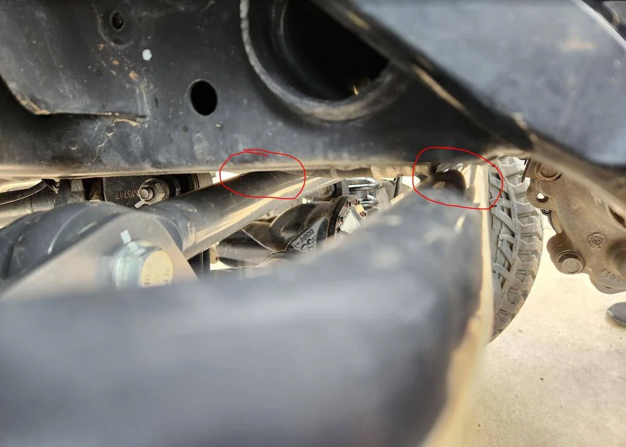

Well I personally wouldn't go so far to say that track bar relocation brackets are "not good" for a smaller lift, you simply need at least 3in of bump stop up front to keep the track bar and tie rod out of the frame and other components... ask me how I know. The track bar relocation bracket though does work with a 2.5"-3" lift. I'm not saying the Rock Jock stuff is bad, there are options though.
