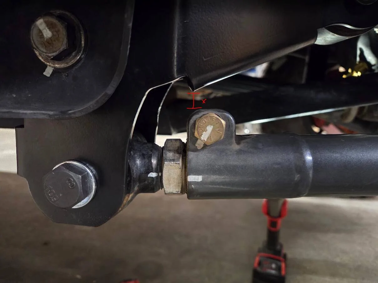

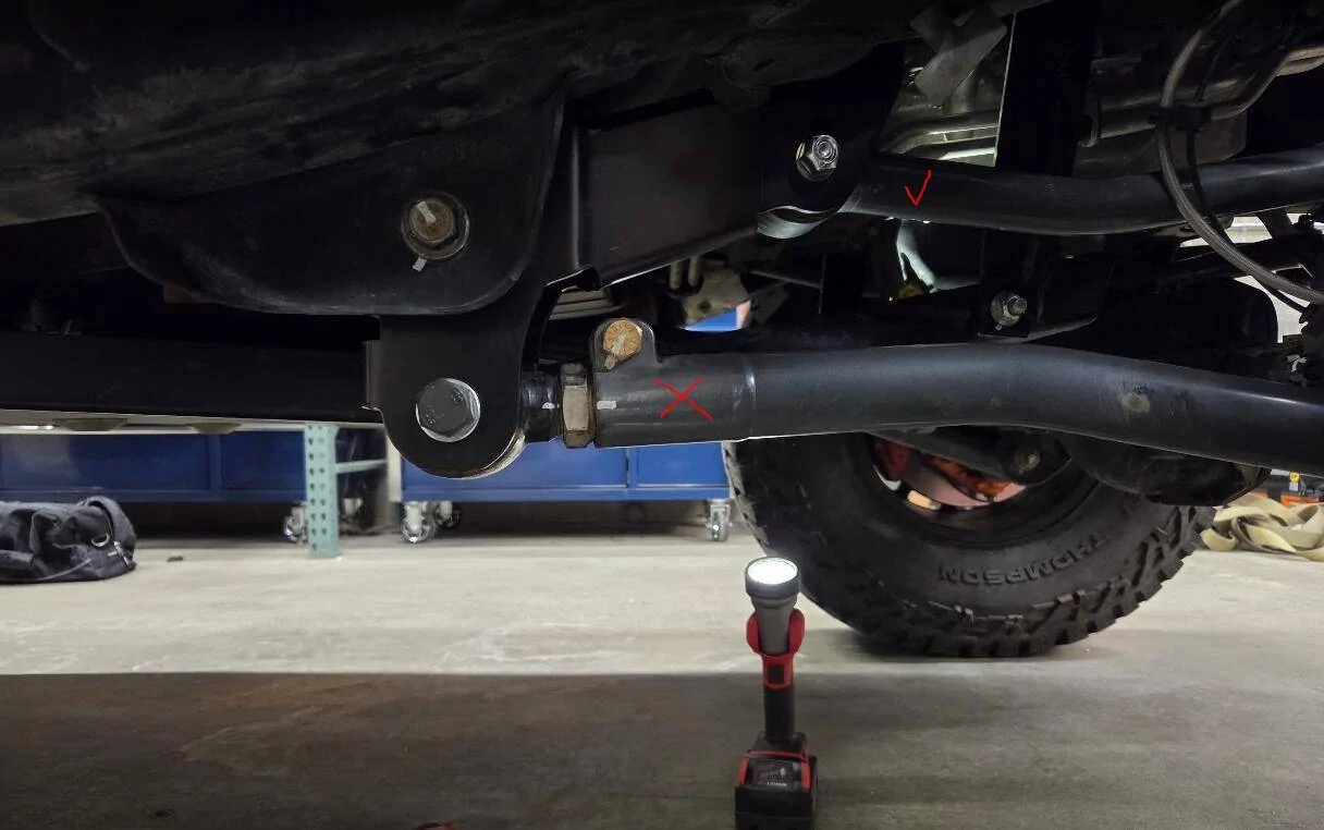

In full transparency I did not read the prior 6 pages, but if there is any question around the effectiveness of drop brackets on ride quality I will whole heartedly stand behind the improved front end bump compliance after "pick your brand" drop brackets. I decided to try out JKS drop brackets with OEM front upper/lower control arms after 4 years of not having them on a simple 3" lift and I was blown away with how much better the ride became. I had everything Synergy Mfg you could throw at the front axle/steering components and I was very happy, but when I switched out to OEM arms and drop bracket it was a noticeable improvement and something I wish I'd done a long time ago. Granted I sold my JTR this month, but if I ever got another Gladiator I'd keep OEM front arms with drop brackets and still do the Rock Krawler 4-link in the rear. It may not be the best for the hardcore trail guys, but rigs that see more highway time will benefit tremendously.
Also, as an FYI, Synergy Mfg lower control arms will likely NOT work with drop brackets as it appears the pinch bolt is too close to the bracket. I never flexed this out to verify but after I installed the Synergy Mfg lower and saw this, I took it off to use the OEM lower. The Synergy Mfg uppers are fine if you want to fine tune caster.
