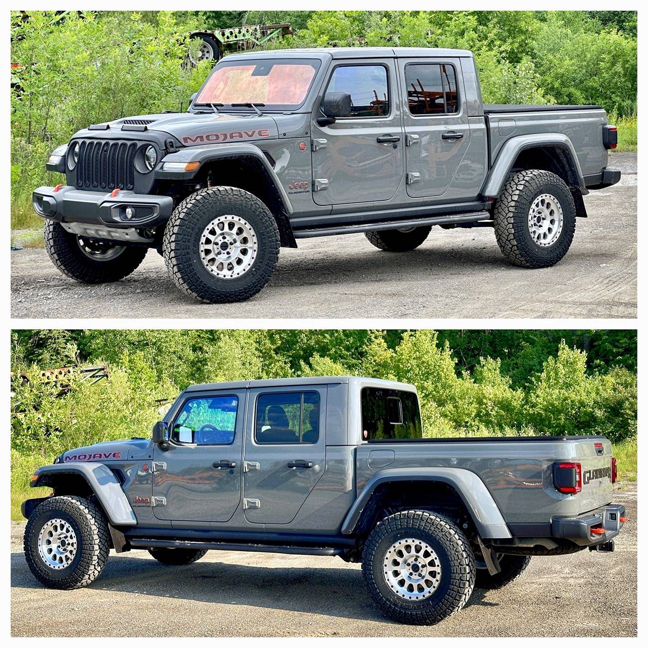

Never posted after pictures! She drives like a dream! A Gladiator dream….
37’s on 18’s next.
Jeep Gladiator 2" AEV spacer and Geometry brackets IMG_2143
Jeep Gladiator 2" AEV spacer and Geometry brackets IMG_2125

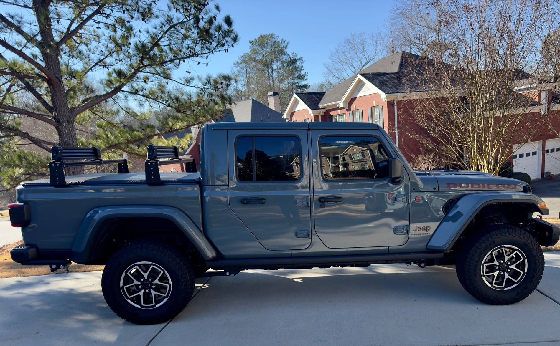

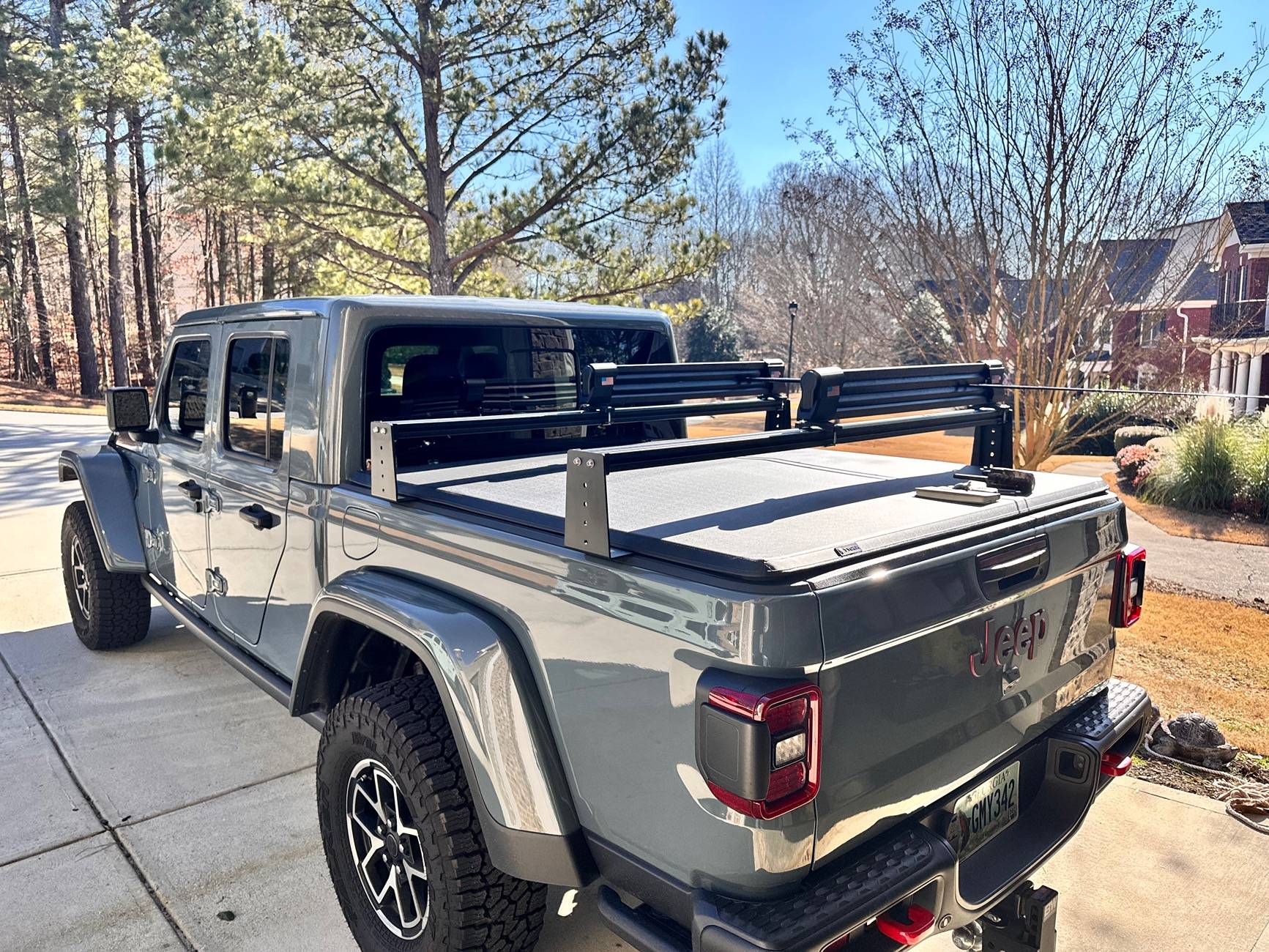

Billie Bar! Super happy with it!
Nice! I have a Rugged Ridge Armis hard roll-up tonneau and this looks like it could work with it. How is yours mounted? Do you have a trail rail or some kind of rail system or is yours just straight up bolted in.
Your Gladiator looks awesome, btw!
