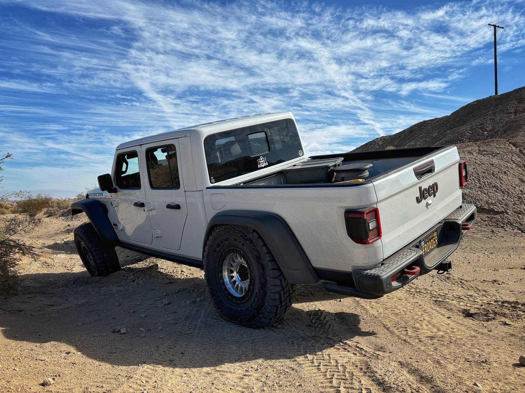

Until I get a "real" lift, I have the front AEV 2" spacers only, and no geo brackets with 37s. I wanted to get rid of the rake... I don't notice a difference in handling from stock (bumps steer or wondering) without them. This is my daily driver/weekend warrior as well.
Jeep Gladiator 2" AEV spacer and Geometry brackets IMG_2778

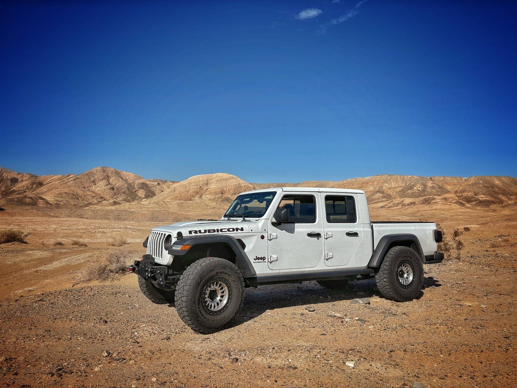

I only installed the front and left the back completely stock.
I will say though without the spacer in the rear, when it’s completely flexed out my rear tires (37s) barely touch the fenders. I also have the Rubicon so they are the high clearance for stock fenders.
Jeep Gladiator 2" AEV spacer and Geometry brackets IMG_2782
