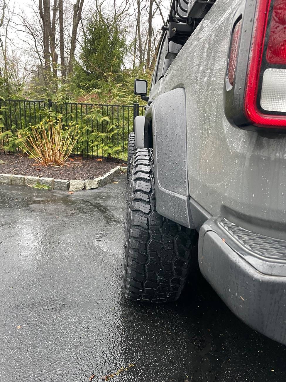

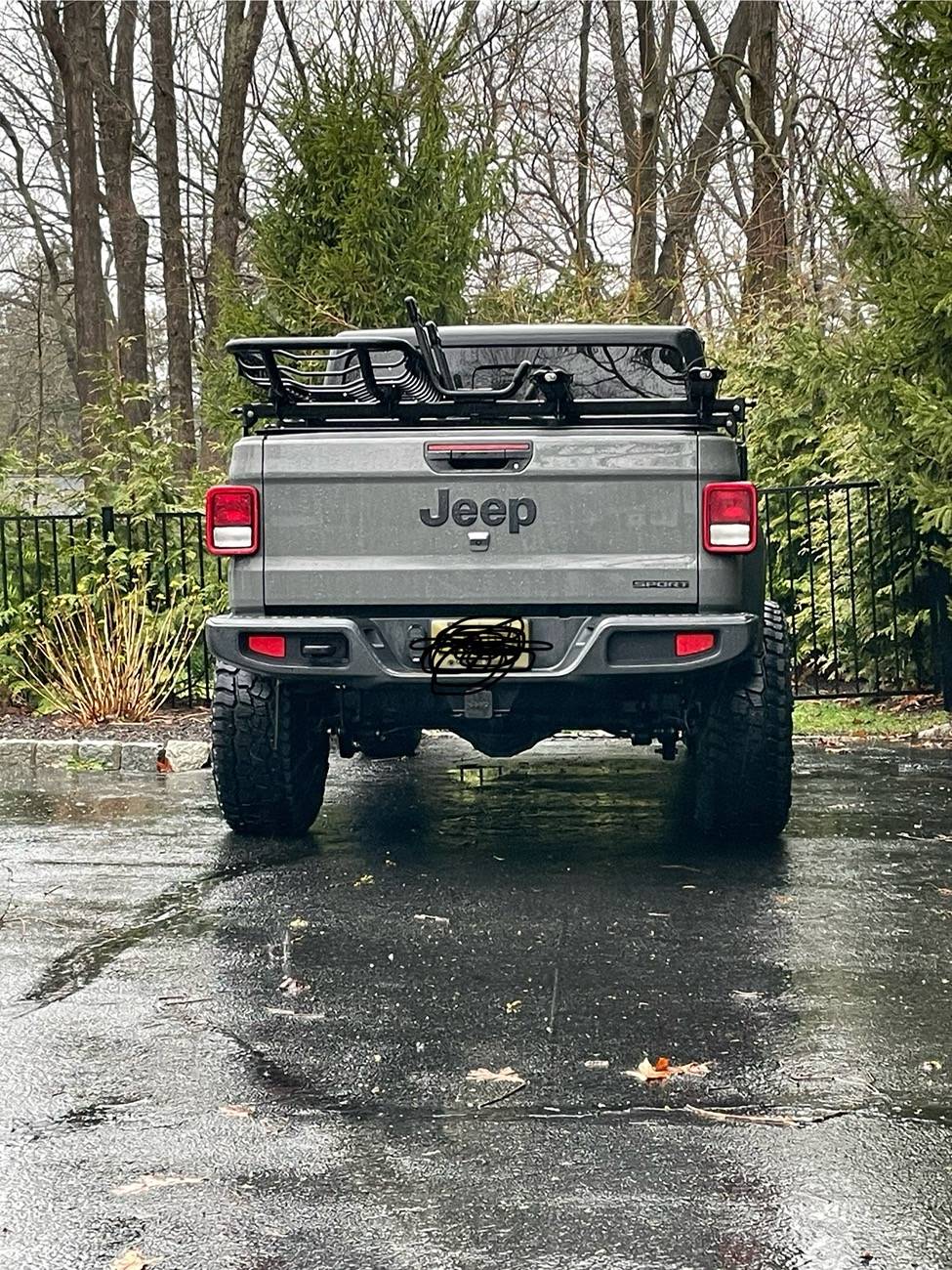

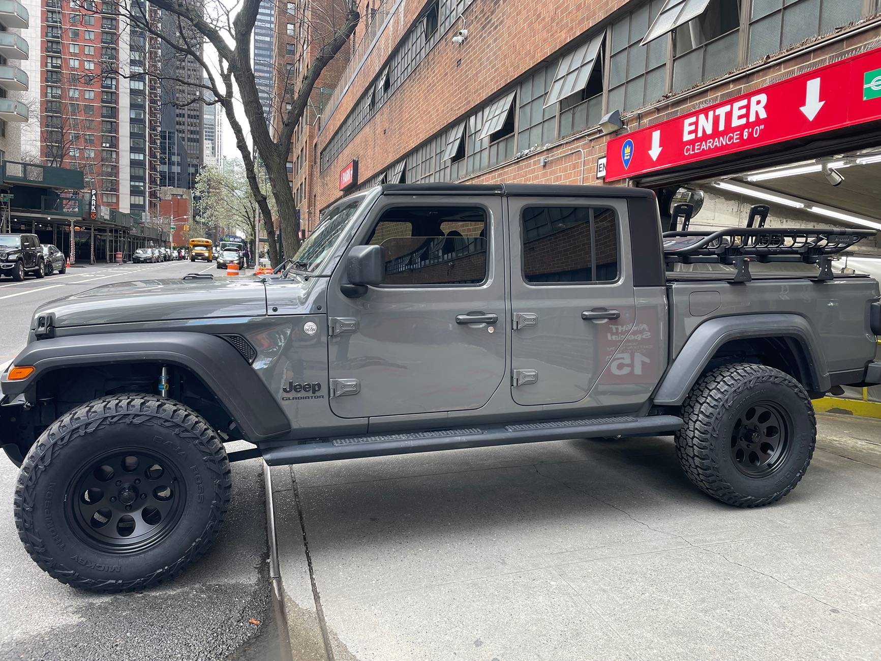

I run this kit on my 2020 Sport S w/ 35x12.5”x 17” rims. I used all geo brackets, just not the shock extender brackets. I’m about 9 months and 6000 miles in and very happy with everything. As I think others have alluded to it depends what you are doing with your Jeep. I am 90% on road and not rock crawling. I have an overbed rack but not for a tent, just ski and bike racks and a small basket for miscellaneous items (not a bunch of constant added weight). I kept the stock springs, opted to swap out my stock shocks for extended Bilstein 5100, added the Bilstein steering stabilizer, added some Steer Smarts parts to correct the geometry tighten up the steering (Adjustable track bar, Sector shaft Brace). Some pics below, the result is a much better than stock ride, just enough height to do some light off-roading and still have an easy entry/exit/ for the family usable bed height for loading/unloading things. My all in cost is definitely less than a Clayton/Full AEV lift and I’m achieving the look/ride that I wanted. If you are doing serious off-roading, rock crawling then this is NOT the lift kit for you but for the price along with a couple add on items, I think it’s hard to beat what you are getting here.
