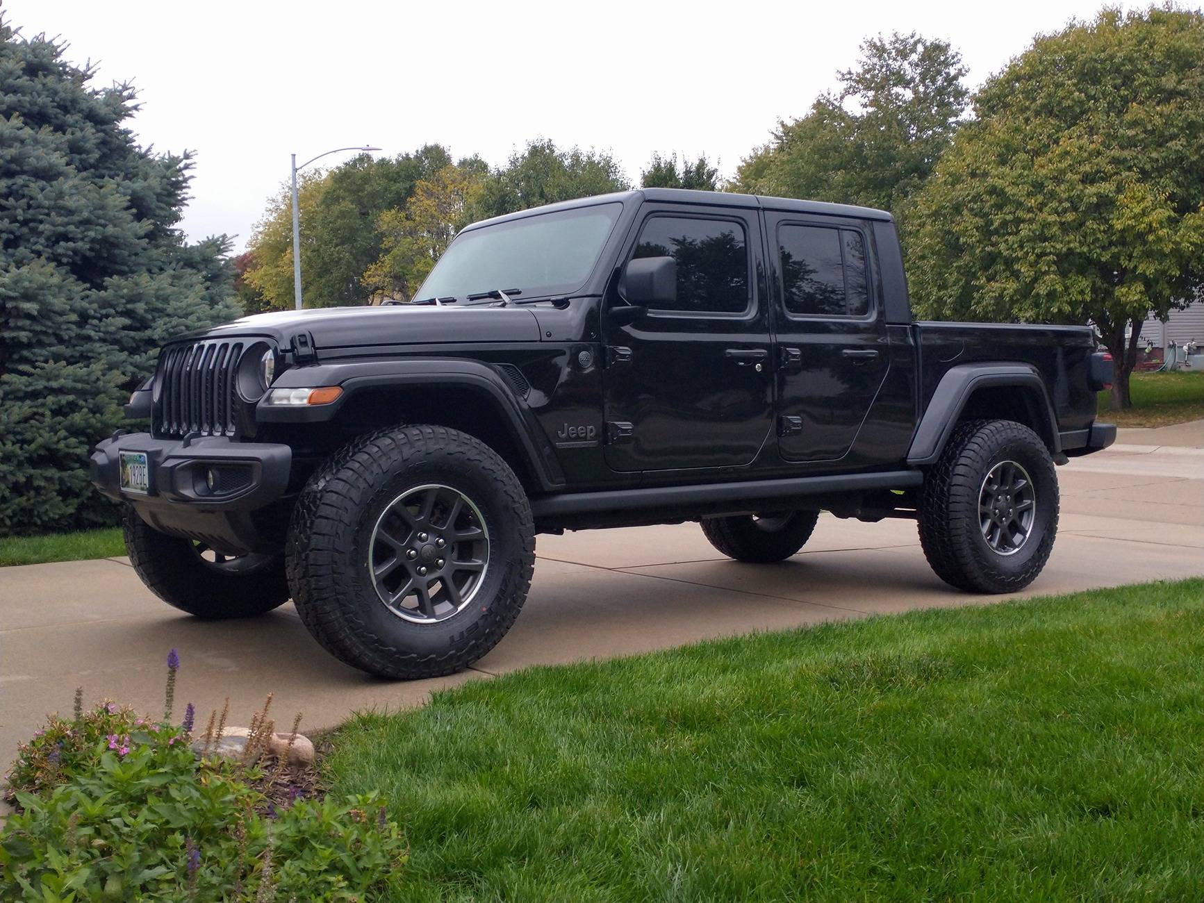

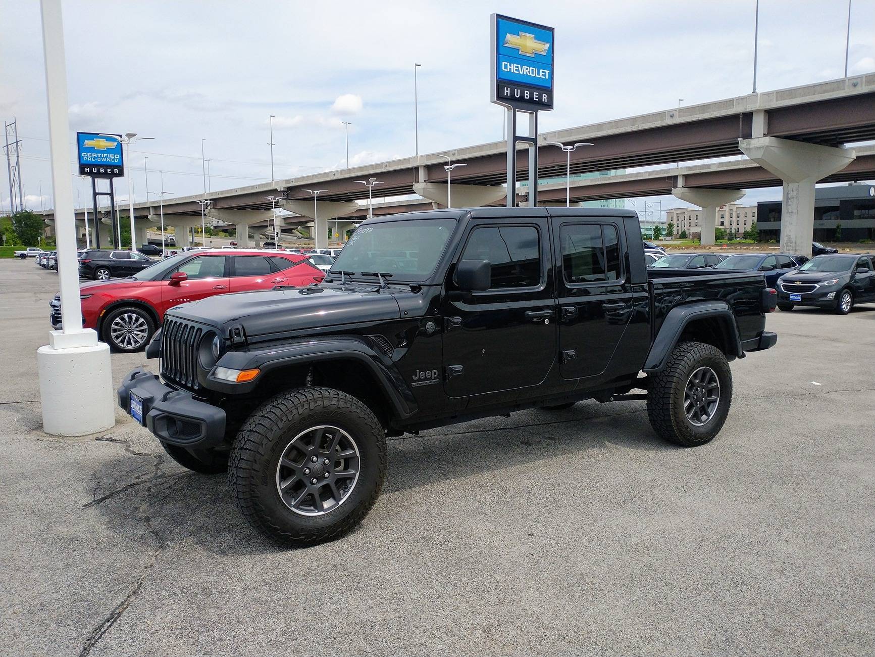

I bought mine with 35s but knew I would go to 37s when the 35s wore enough. Found a smokin' deal on a set of 5 37s. So, within a month it had 37s on OEM Overland wheels. A couple months later I got new set of wheels... happy now
Take it from my experience 37s look right on the JTs.
First pic from the dealer 35z, second pic 37s on OEM wheels, 3rd pic now
