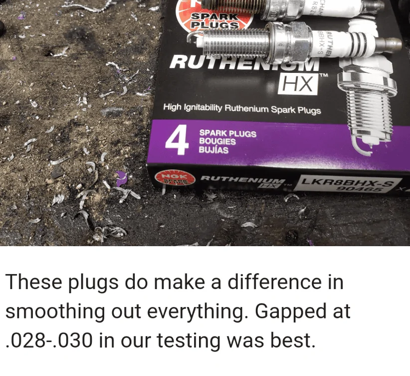

Also, when I floor it, I get power for 2-3 seconds of power than the power drops big time. I wondering if TE Motorsports didn't gap my sparkplugs correctly
Once I get everything fixed and running great, I will say what I did and how its going.
BTW which plugs did you get? I went with the NGK Ruthenium, and they were pre-gapped around .34. I left it at that.
