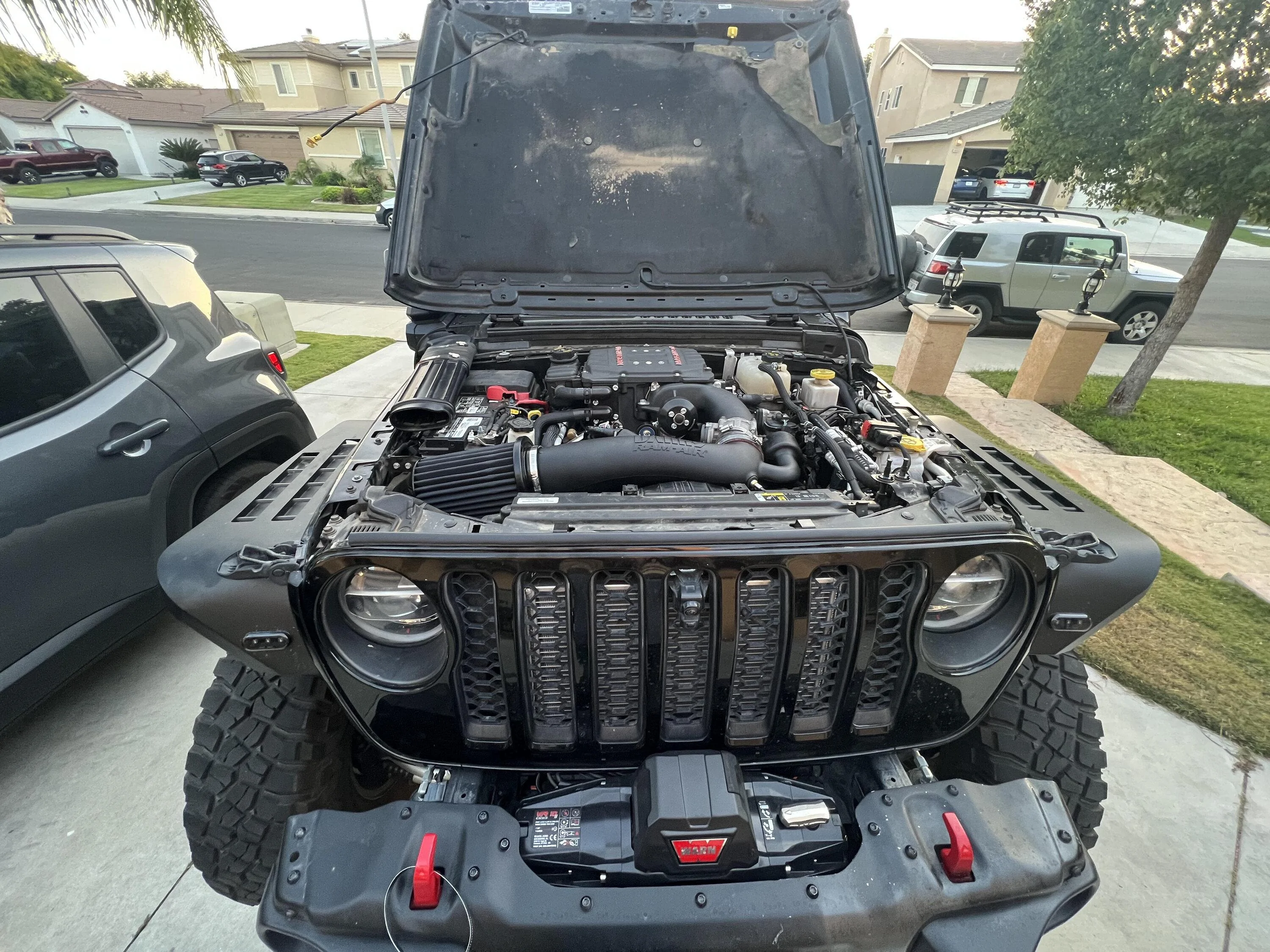

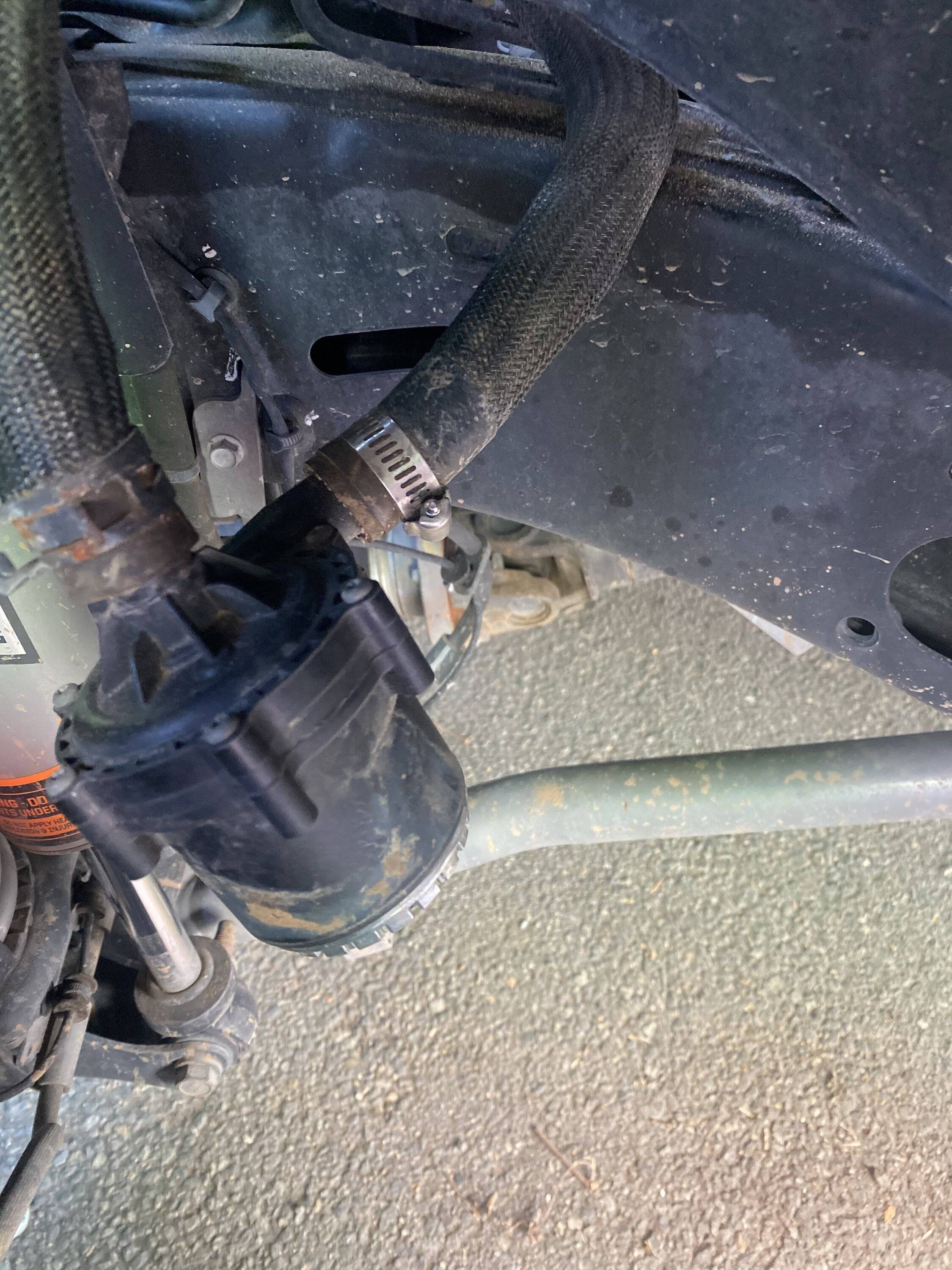

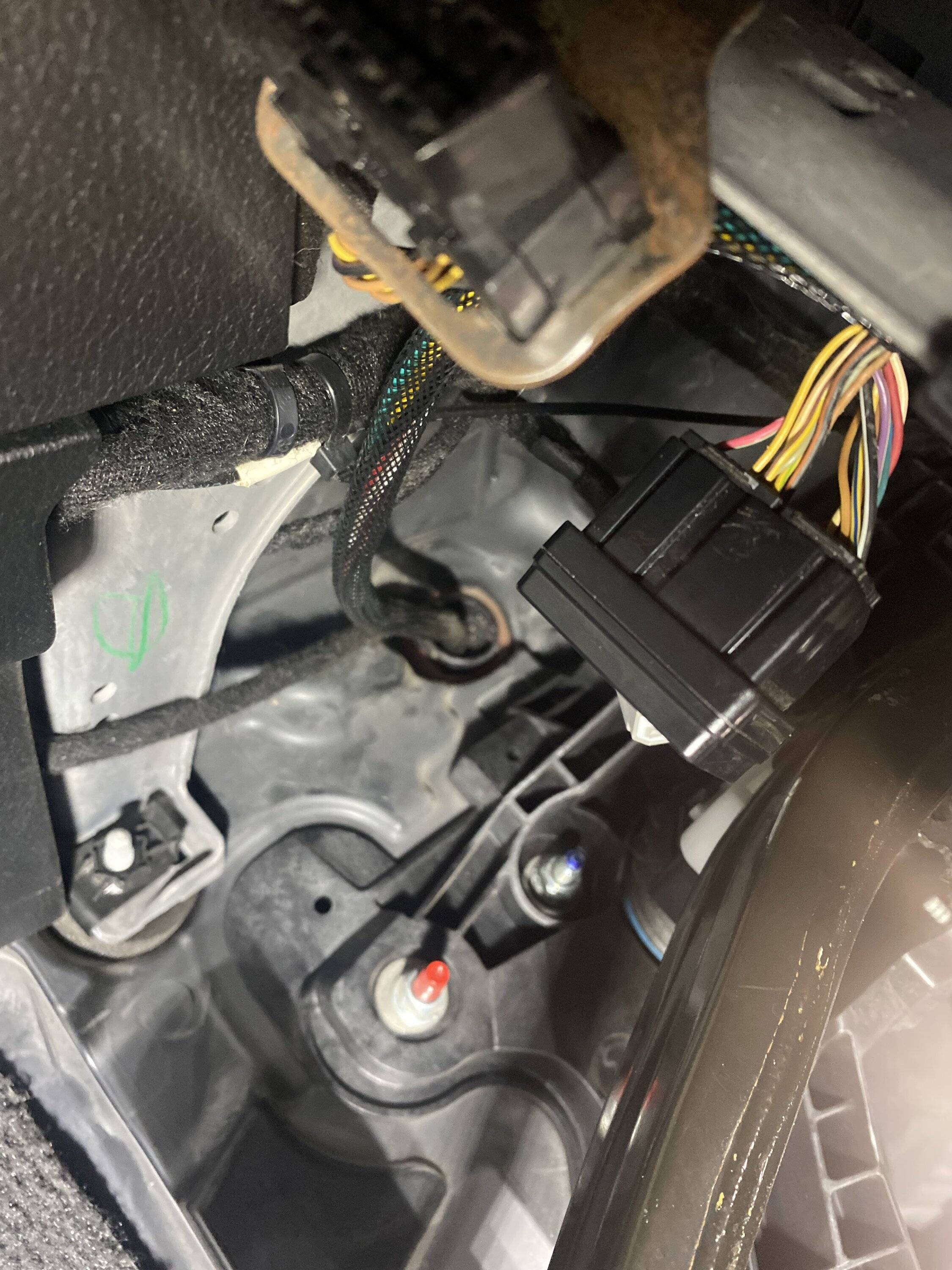

so i bought a 20 JTS with a maggie , a hp sticker on pcm , nice rubi express extreme duty kit , well it runs like shit just found tonight the coolant pump is bad ,it has a tiny no name box plugged into sgw harness what do i need to get a mpvi2+ or is there something else better helllp please

Im not a mechanic, but I'd go to Magnuson or one of their dealers to get the correct info. Good luck!

Download the installation instructions from the Magnuson site. Most likely there is air in the intercooler line. The pump willl not run unless it is properly burped.

bleeding is easy just jump the relay or un plug it and give power and ground i got a 20 vw coolant pump off Amazon
