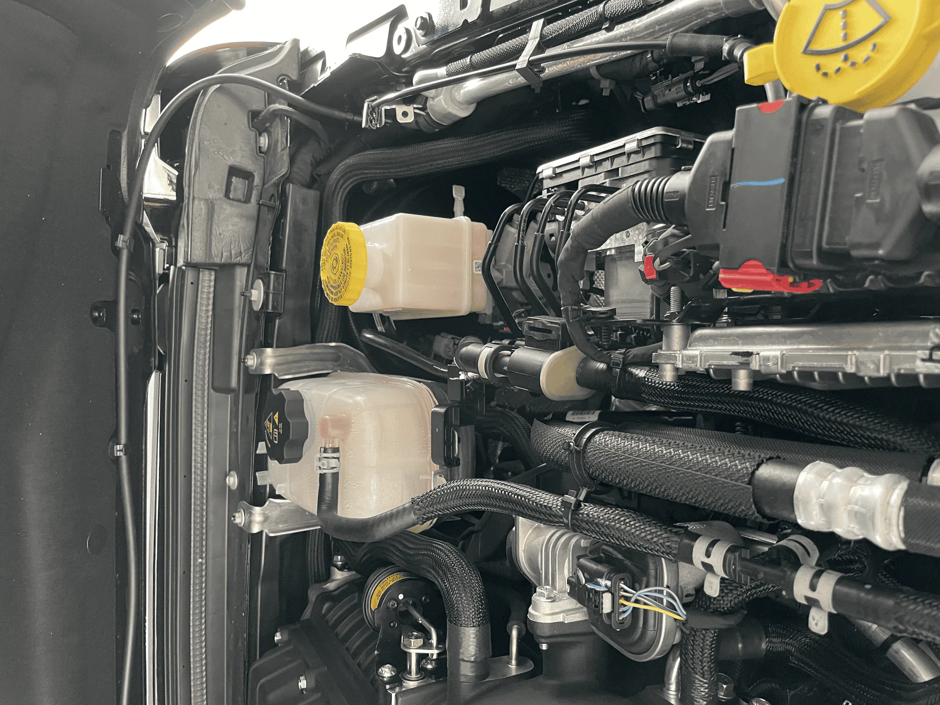

3. Relocation of the fuel tank purge valve. Where magnuson puts the valve, it can resonate on the firewall. Using some fuel vent line you can move it heare and it alleviates the noise.
Curious about this mod. Do you recall hose size? I assume you added it where the oem push clip was added to the Magnuson hose.
I couldn’t figure out what this entailed either, but seems like I’m getting an occasional rattle. Usually after driving 10-15 minute and then coming to a stop/idle. It’s kind of a low frequency thudding, maybe 5 per second.
I’ve also heard it mentioned that it sounds like a woodpecker knocking noise. I wouldn’t know. Ya know, since I have GPEC5 and had to pull the whole damn supercharger back off.
It is a ticking noise that usually happens at low speeds or when idling. It becomes very annoying wheen wheeling. I asked my installer to move it but they didn't since it wasn't in magnusons instructions. To move it now would require pulling the whole sc.
