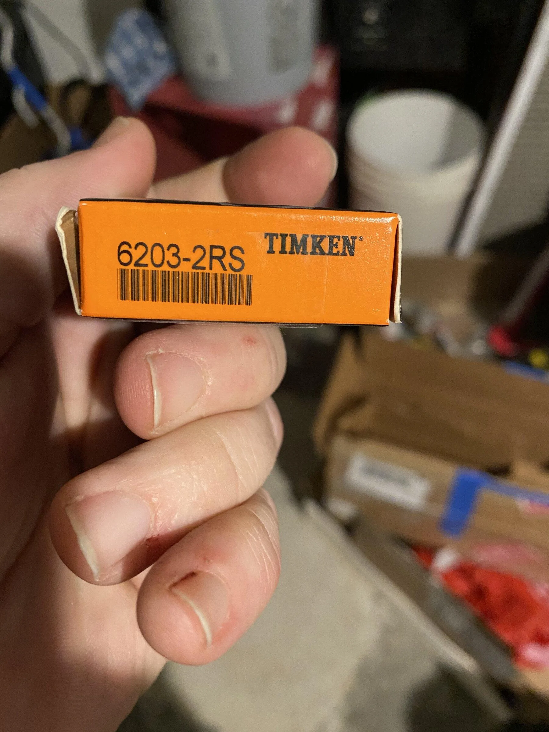

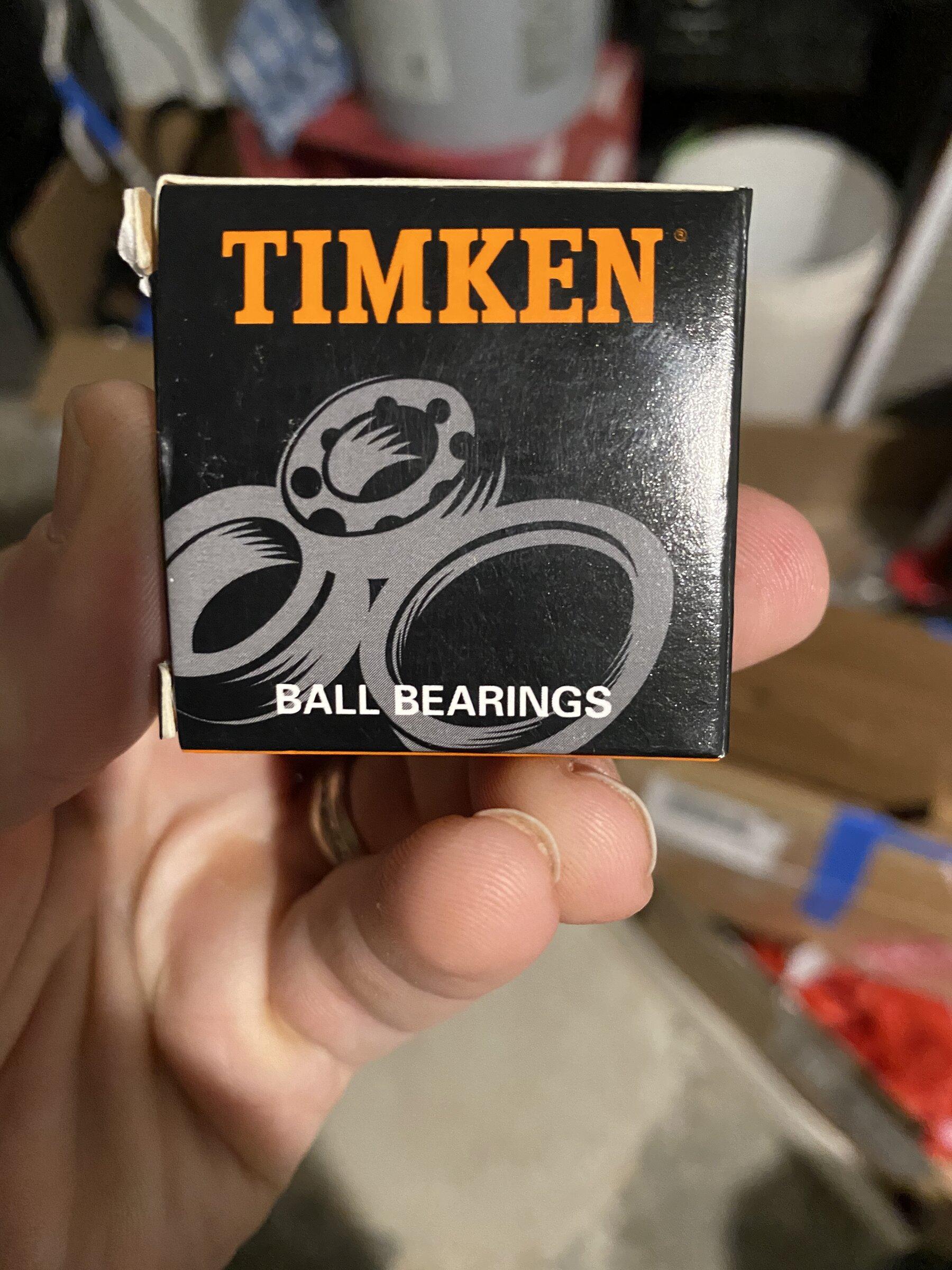

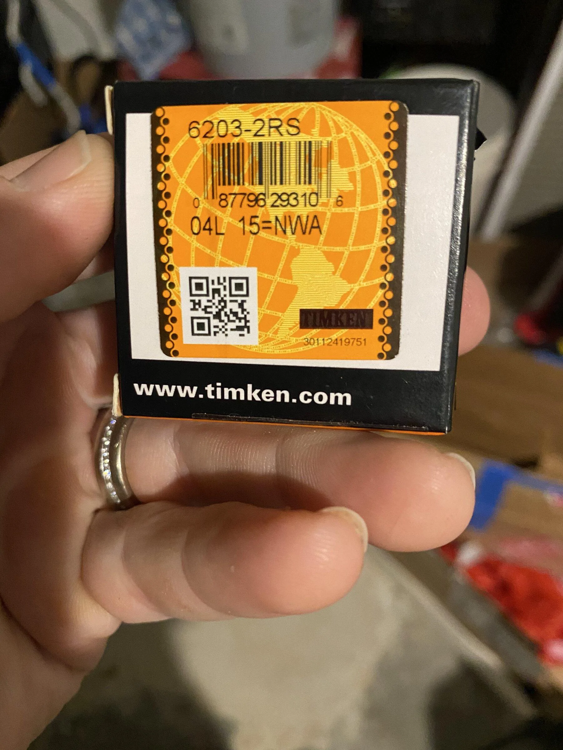

Anyone who got the Timken idler pulleys, or anyone knowledgeable on pulleys who might be able to answer this question. I ordered based off the part number in the picture, and I received these. Was the C3 removed from the model number? Looks like measurements are the same.
Jeep Gladiator Magnuson Supercharger Install / Modification – Crib Notes F9A10E0A-0FA8-46AF-8A19-147438E3418A
Jeep Gladiator Magnuson Supercharger Install / Modification – Crib Notes D49C5D01-8474-4BBE-8BCD-343447E9CE39
Jeep Gladiator Magnuson Supercharger Install / Modification – Crib Notes 3B294659-1002-45AB-A99B-FD55D5A373C0
ETA: I answered my question. The C3 is a designation in regards to radial internal clearance. C3 is a designation for “loose.”No designation like the one I received means “normal.”
