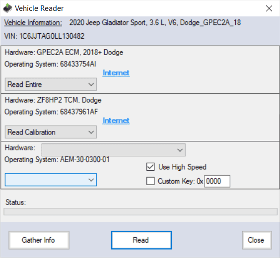

A little info on reading and flashing files.
when you went to read your file you need to hit gather info as I have in the picture below
When you do that it will give you the option to read the engine and transmission tune

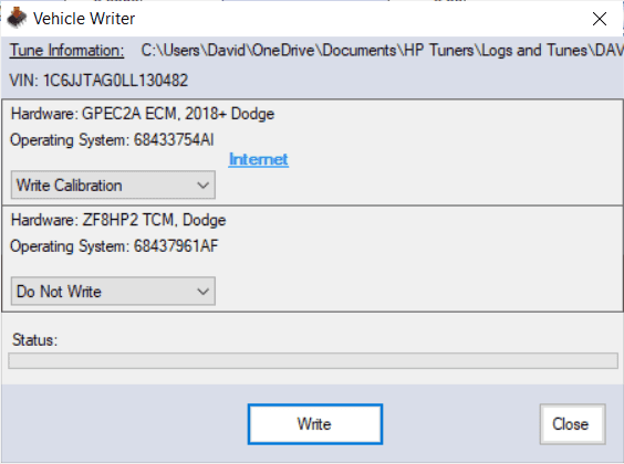

Once you have it read, you can then follow the Instructions above to copy the tunes I have supplied
Then you can flash the new engine and transmission tune. I flash them one at a time as the combo flash sometimes hangs up.
