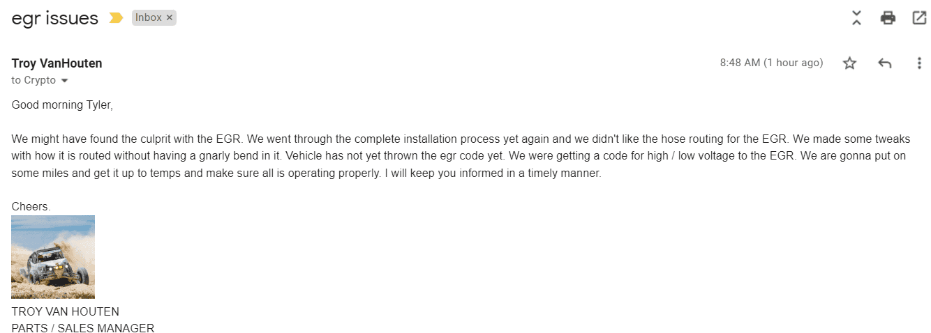

After @DAVECS1 said it was a install issue and Magnuson Support saying it was a Install issue, after ordering a new EGR valve and gasket. I get this email this morning. @DAVECS1 was right from the beginning. Magnuson Support is great, they did everything they could to put TE Motorsports in check to get my car right.
This is a great forum thank you everyone for your help.
