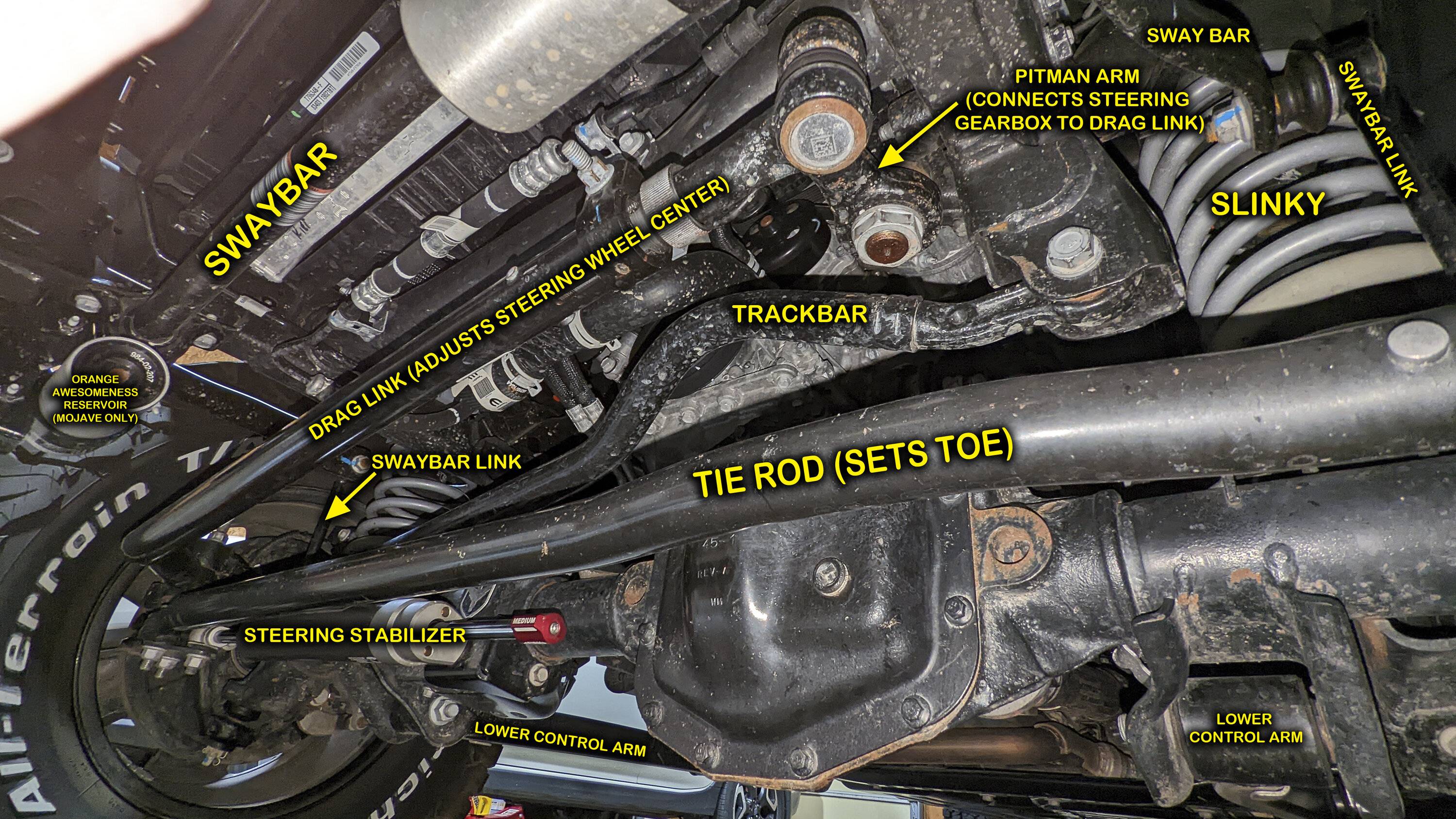

So the dealer got it snug, and when I went to check it after a few trips down the road it became slightly loose again. Would you suggest a brand to replace the pitman arm of outter drag link?

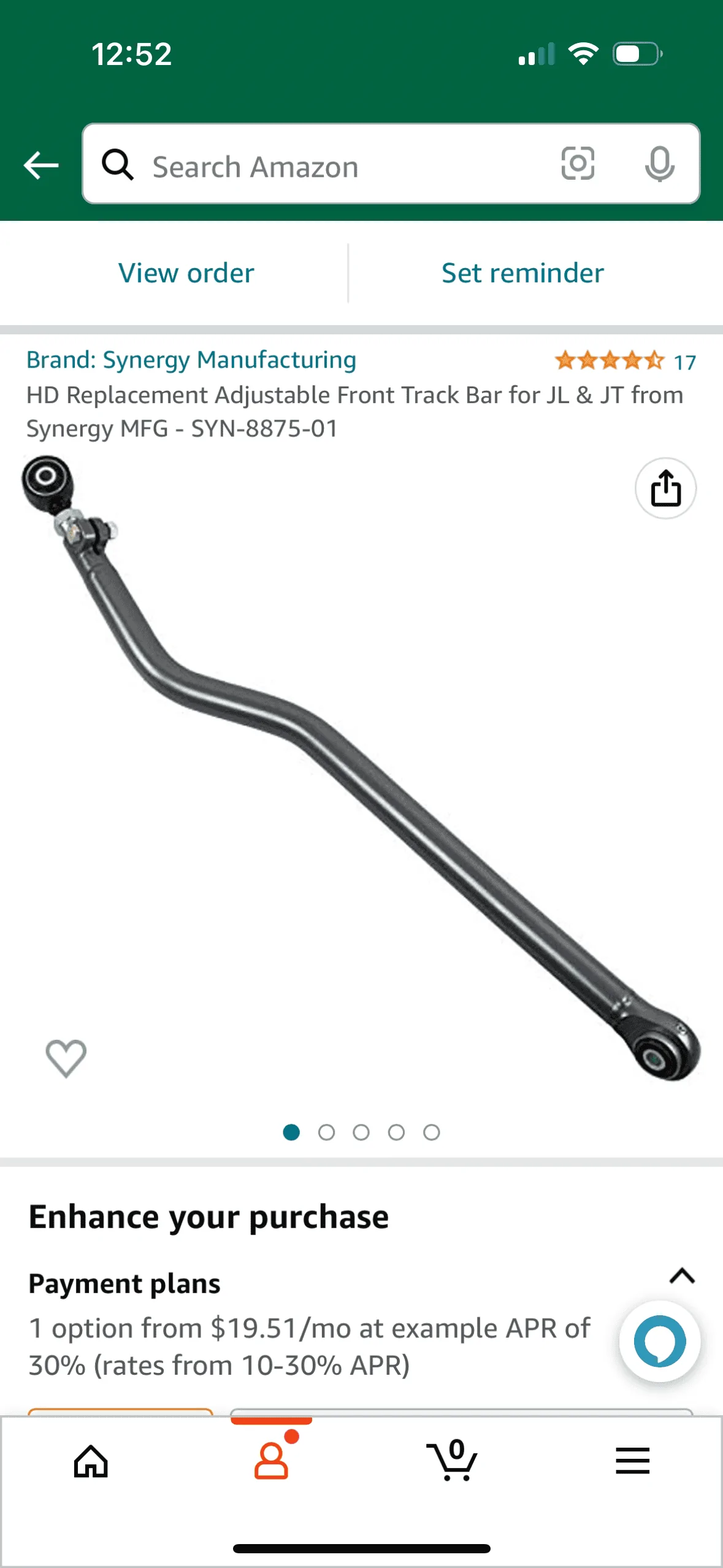

when the dealer installs the synergy mfg track bar Thursday, with a new track bar if I ask them to tighten the pitman arm will this keep both in check?
I'd make sure that the bolts holding the steering gearbox are properly torqued and that there's no play or flex in that or the pitman arm.
I'd install the Metalcloak brace either way, for added strength and security.

I understand yours is on point. I want to clarify what putting a MC brace will help on yours.
Would installing metal cloak to get the drag link to affirm tightness and prevent any more looseness
HNY
It will add support where it's needed on the bottom of the gearbox spline and Pitman arm connection on the drag link. If your actual drag link joints are loose and worn then replace the drag link, end to end.
A small amount of movement when you rock the drag link is common, at least in the OE ones I've seen.
I checked one on the dealership showroom floor and it moved the same.
