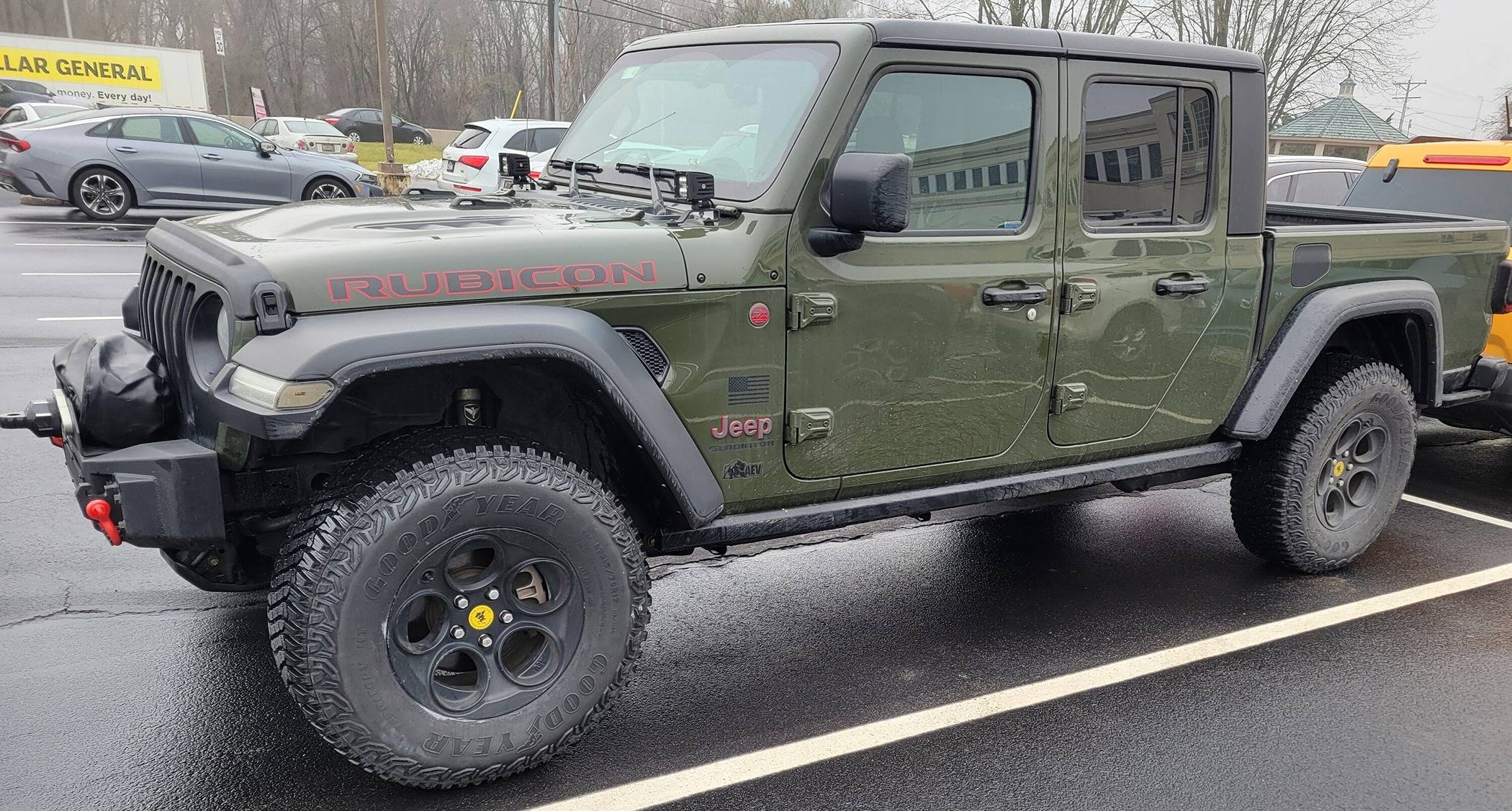

BTW, I run the same AEV wheels as in your Avatar pic. Ported over the factory TPMS sensors when I went to them and they synced right away.
