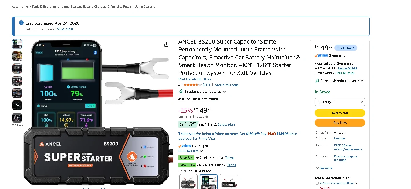

I have replaced both batteries but my jeep gladiator will sometimes die when coming to a stop. (Start Stop???). After around 5 minutes or so, something resets and it will start again. Then in a week or so it will do it again. Could it be the Power Control Relay (PCR). It is very frustrating and I need some help. It’s a 2021 with 30k miles. Thanks for any help you can provide
hi Guys,
I am using this for now and works perfect....
Jeep Gladiator 2021 Jeep Gladiator Issue 1780667663550-g
