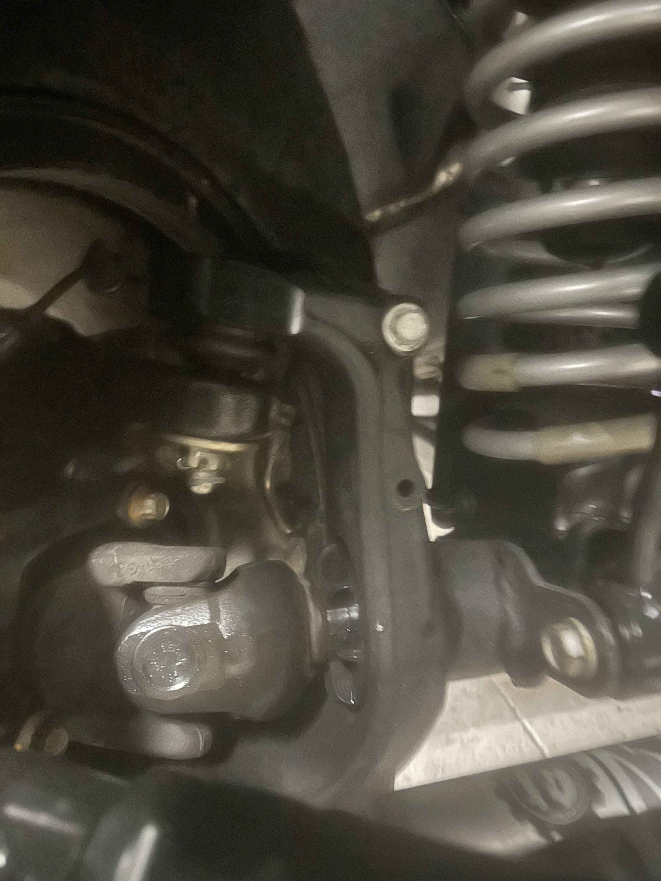

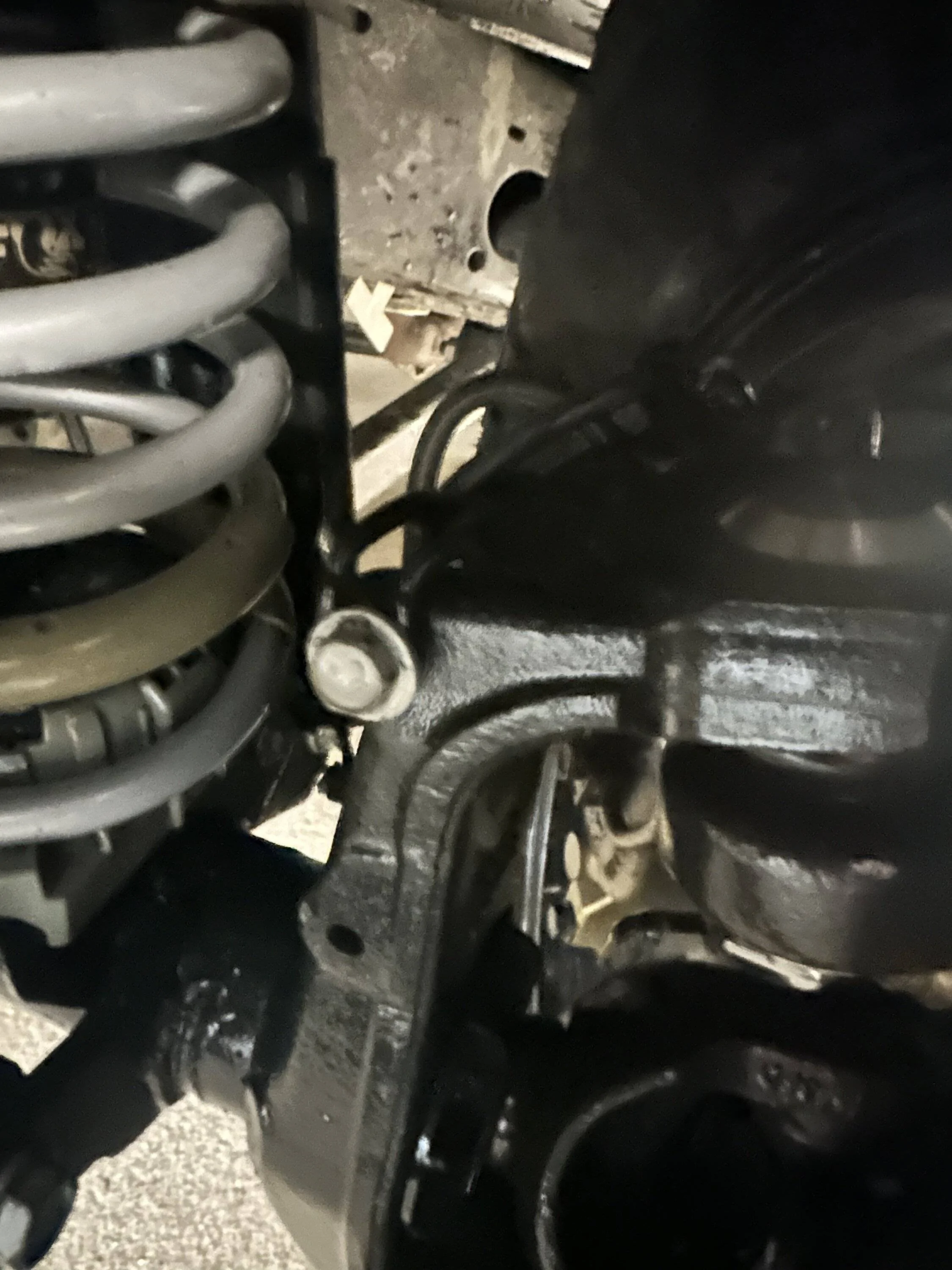

This single bolt shown is the one that I have to continously tighten. Keeps getting loose. Not sure if this is a bolt for the sway bar however when I do tighten it up, the ride is less bumpy and helps the driving experience.

Do you know what this bolt does? For some reason this bolt becomes loose on its own and causes some shakyness while driving until I re torque it.

That's just a bolt that holds the brake line bracket in place.
