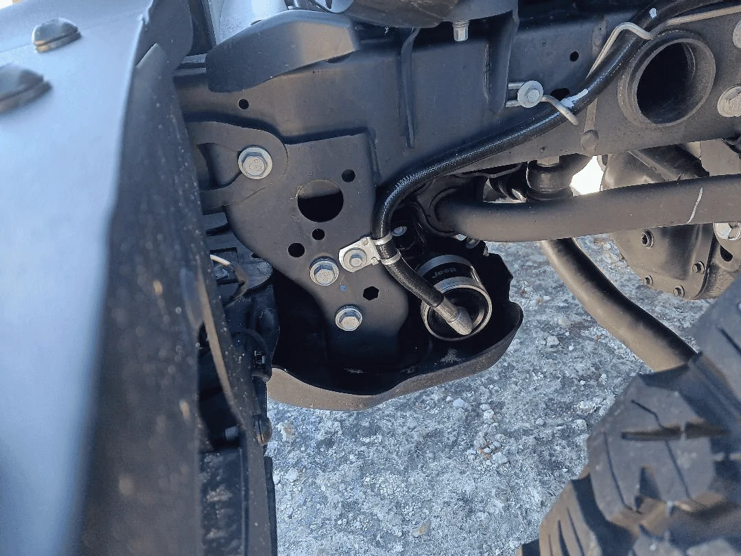

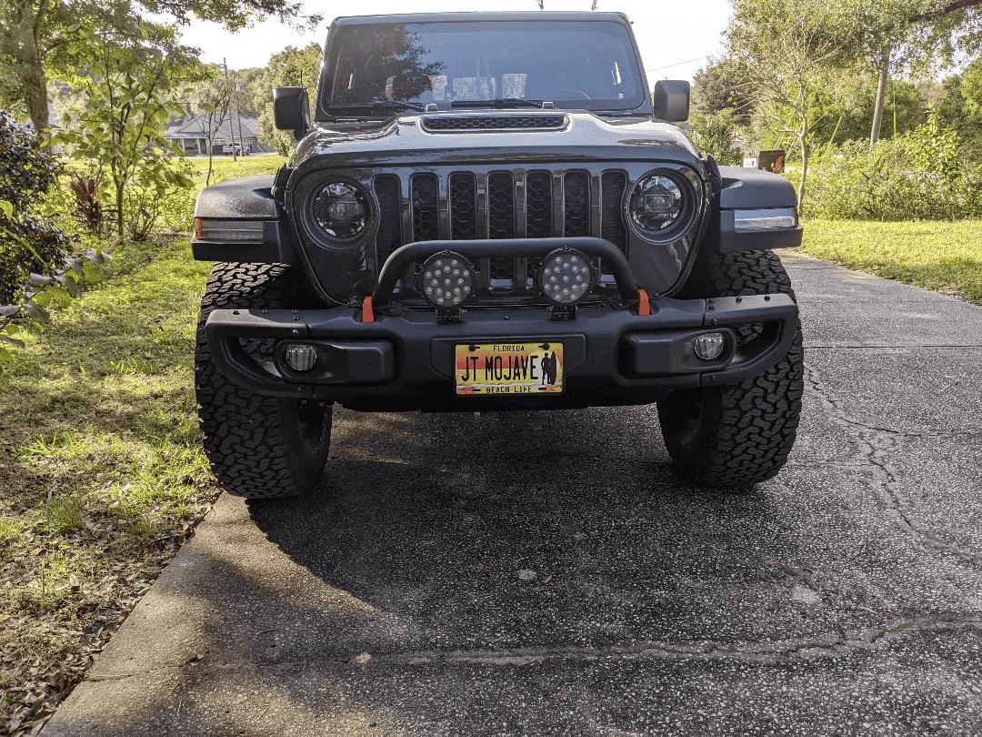

It will work as others said. To avoid any modifications just get the steel bumper skid plate with it. Unless you like the silver painted skid, then modifications are needed.

I did the same as KevinC, Rubicon steel front bumper and Rubicon steel skid plate. Works perfectly.
Note: Make sure you get the steel skid plate for the steel bumper. Apparently they make a Rubicon steel skid plate for a plastic bumper - basically a Mojave Skid plate but black instead of silver...
