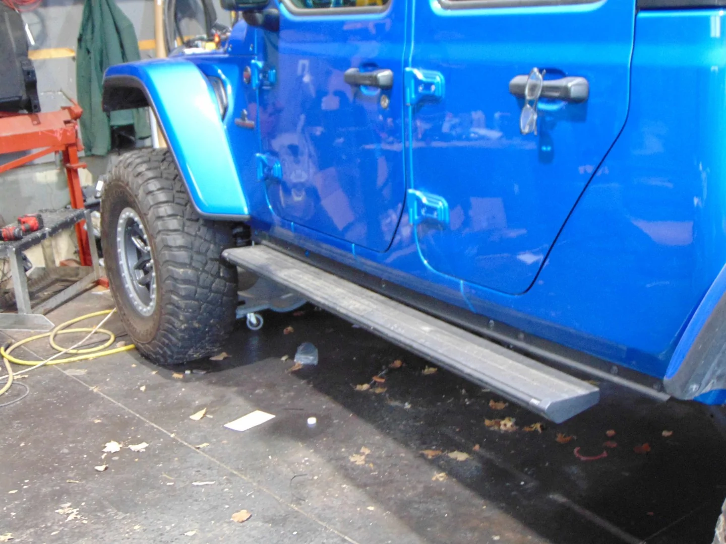

And I got busy removing the old RC electric running boards. You know, the fact that they survived and never stopped working is a testament to their quality! Kudos to Rough Country!

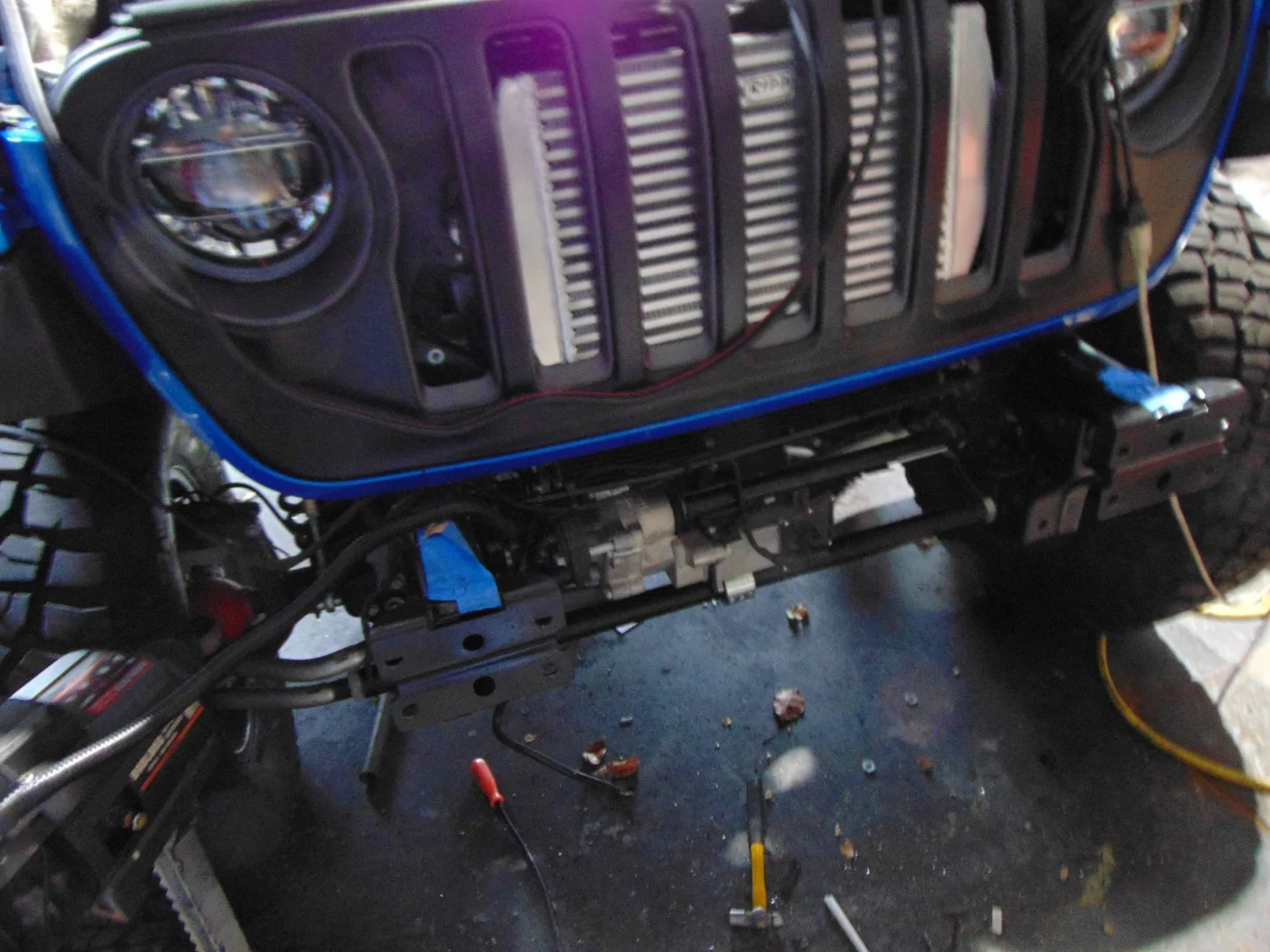

I think the new bumper is arriving today or tomorrow, so time to delete the sway bar!
Jeep Gladiator 2022 AEV Gladiator Rubicon build DSC03357 (Large)
Jeep Gladiator 2022 AEV Gladiator Rubicon build DSC03358 (Large)

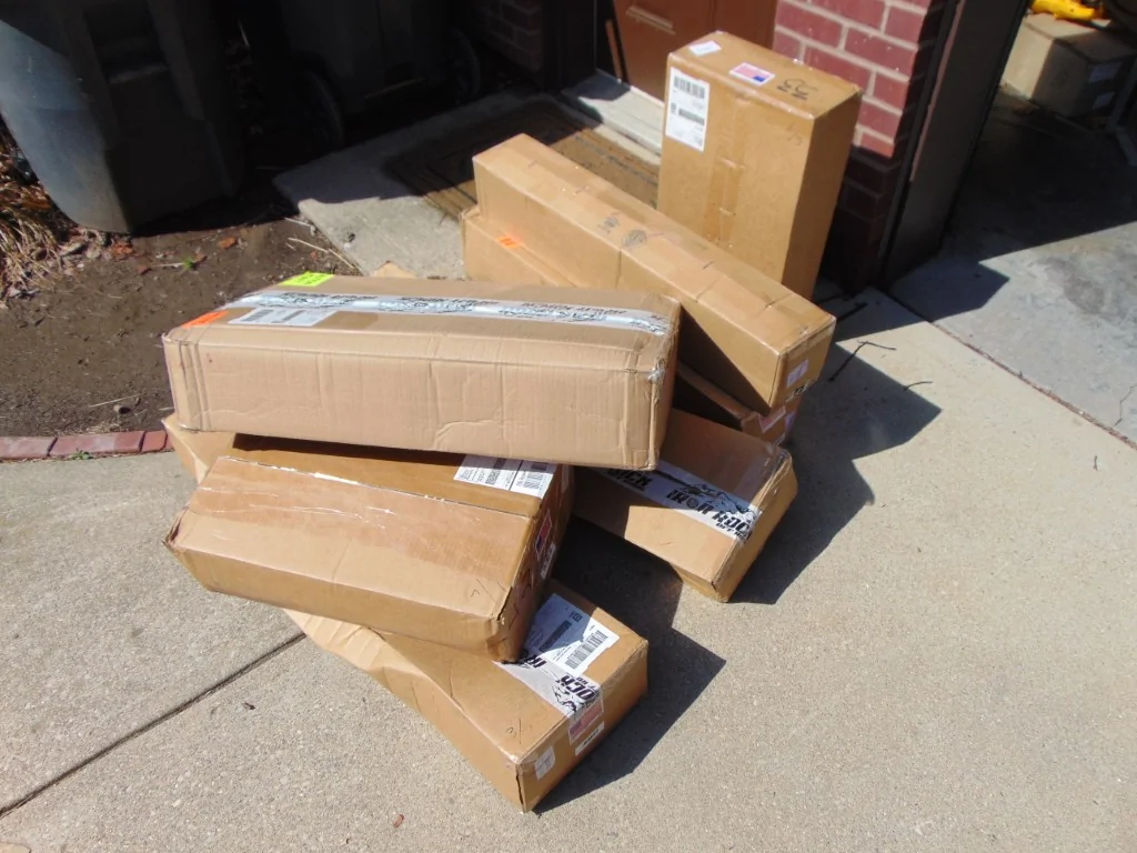

Well, I was right, the bumper showed up, along with everything else!

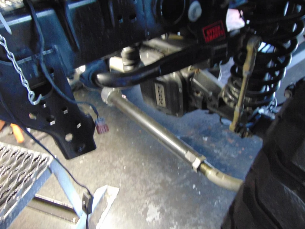

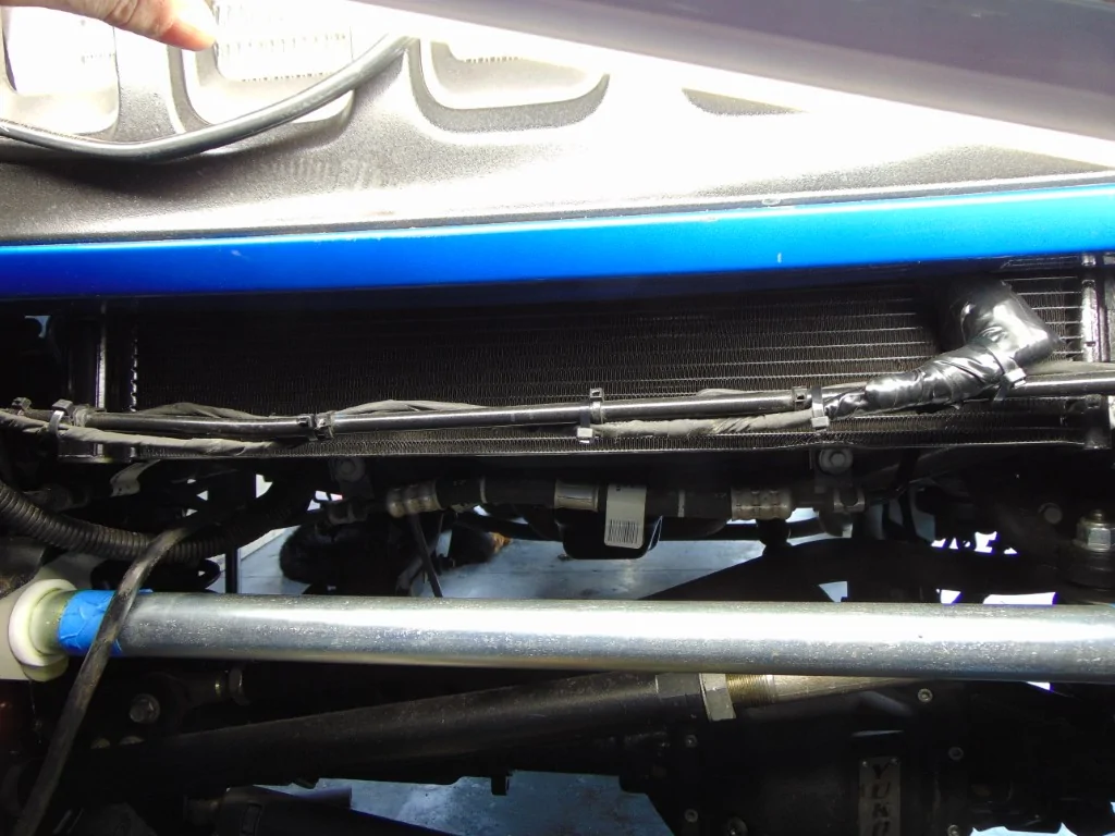

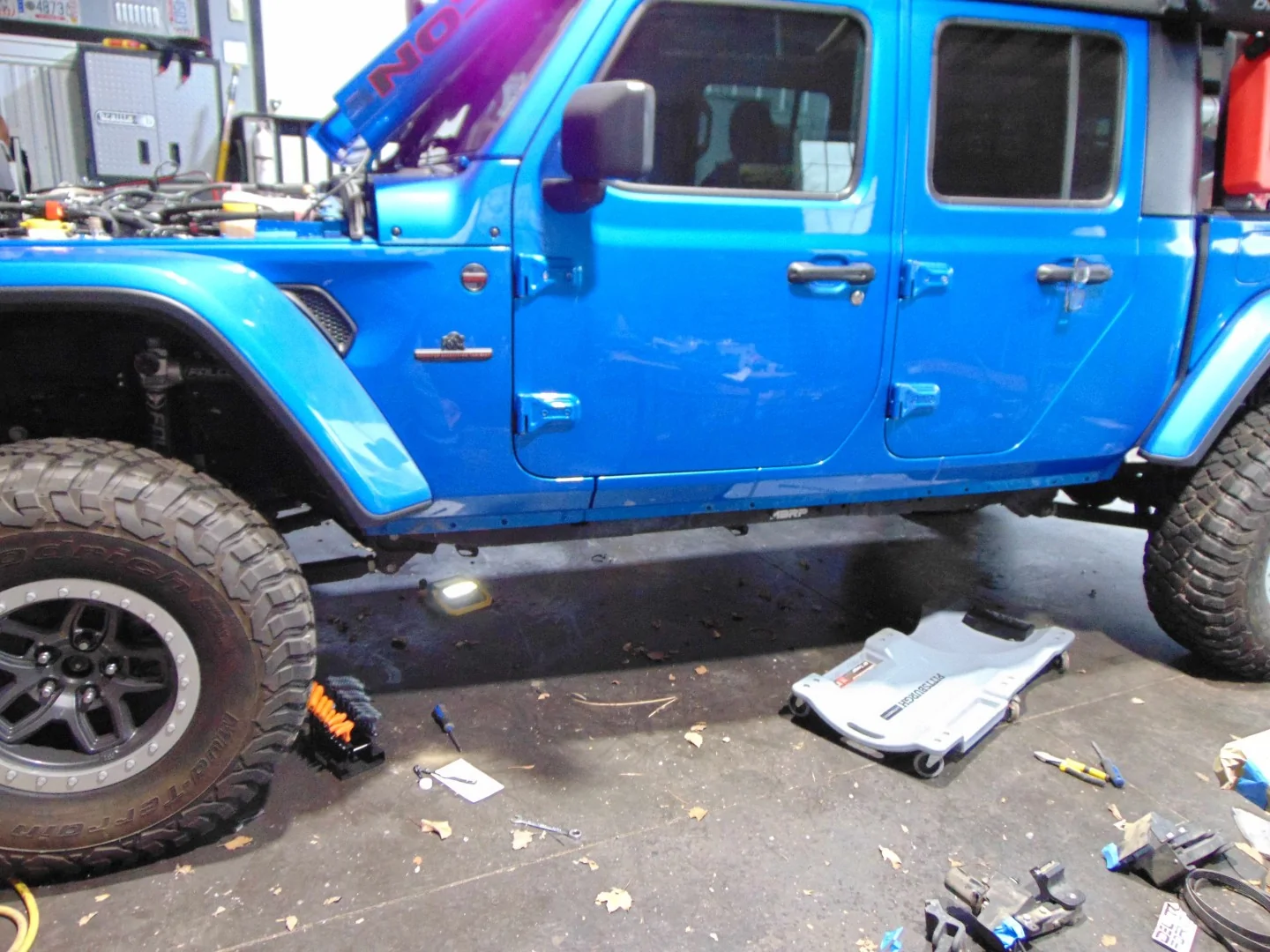

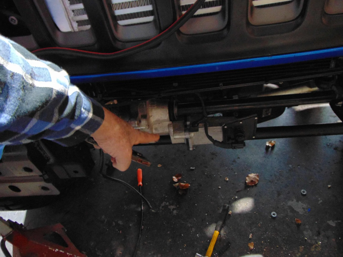

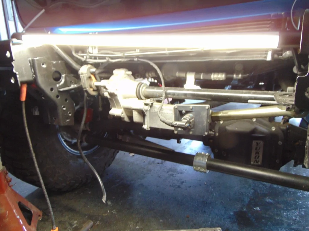

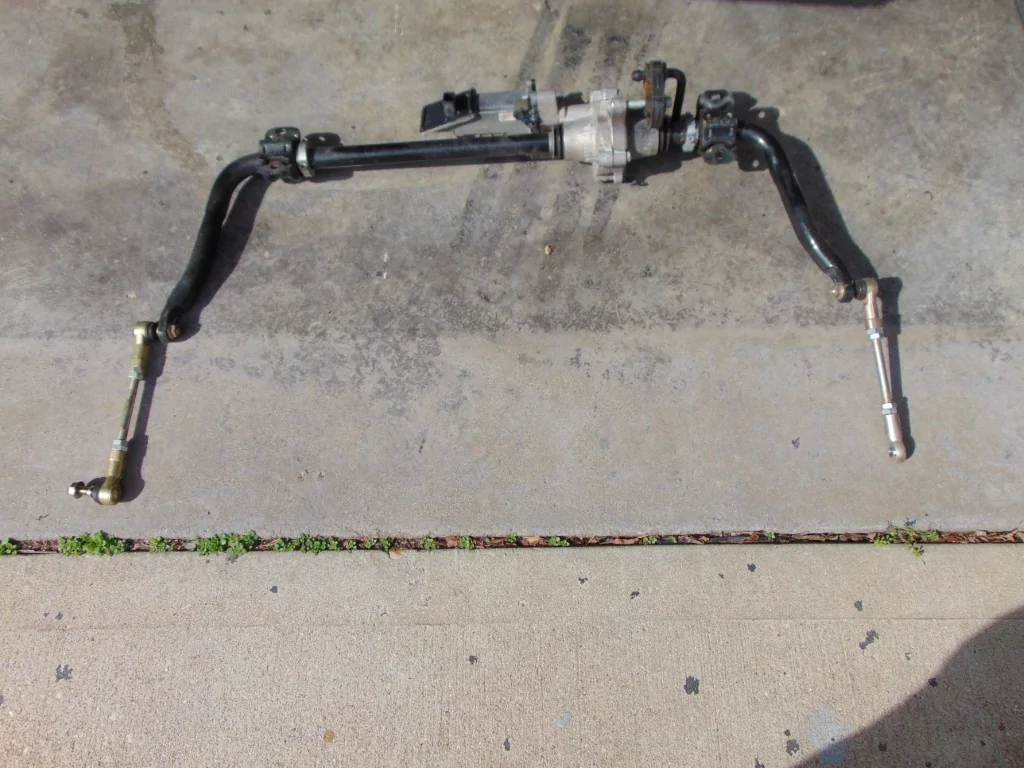

So with the bumper install in mind, I thought I'd take a couple of minutes (hours) and get that new sway bar installed. First, I pulled the factory disconnecting bar:
Jeep Gladiator 2022 AEV Gladiator Rubicon build DSC03367 (Medium)
Jeep Gladiator 2022 AEV Gladiator Rubicon build DSC03368 (Medium)
Jeep Gladiator 2022 AEV Gladiator Rubicon build DSC03369 (Medium)
Jeep Gladiator 2022 AEV Gladiator Rubicon build DSC03370 (Medium)

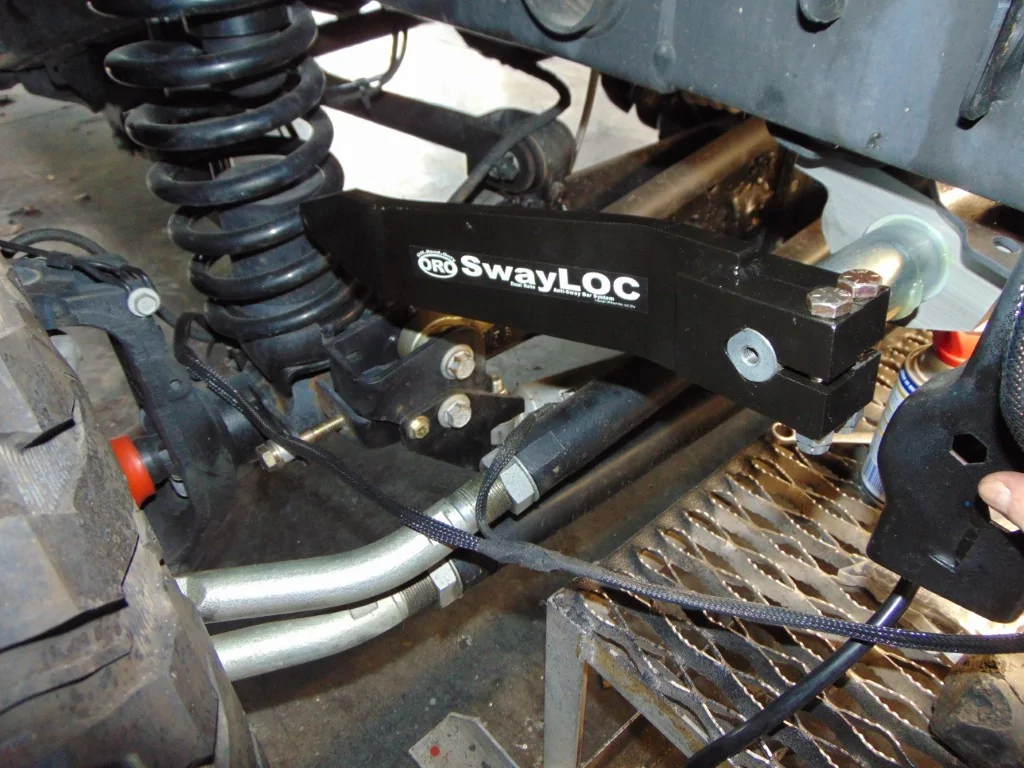

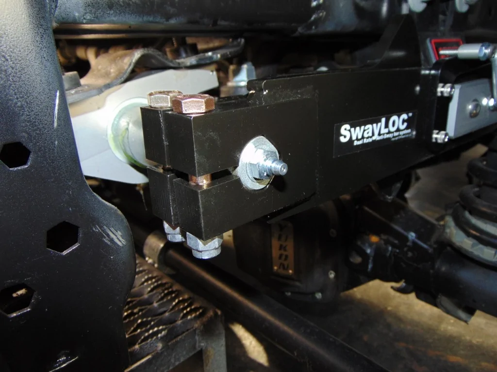

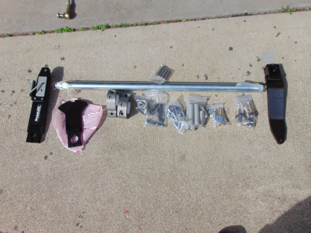

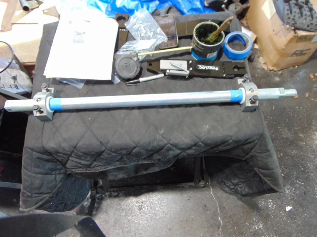

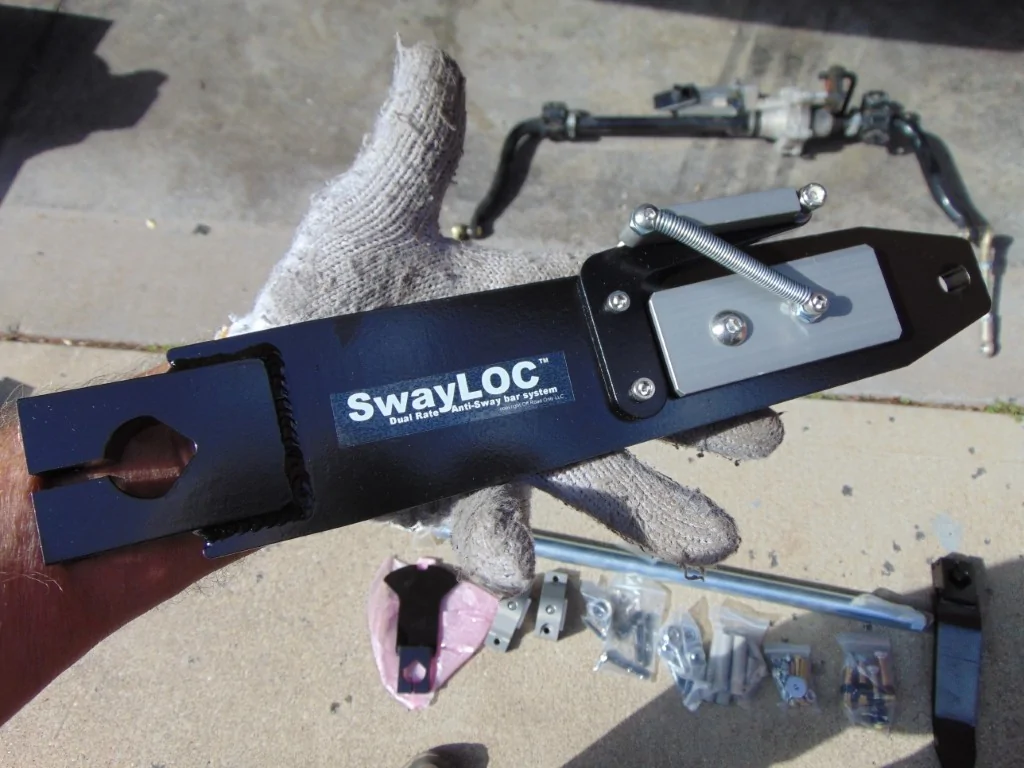

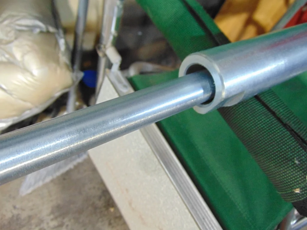

Then I started piecing together the new Off Road Only trick, twin bar.

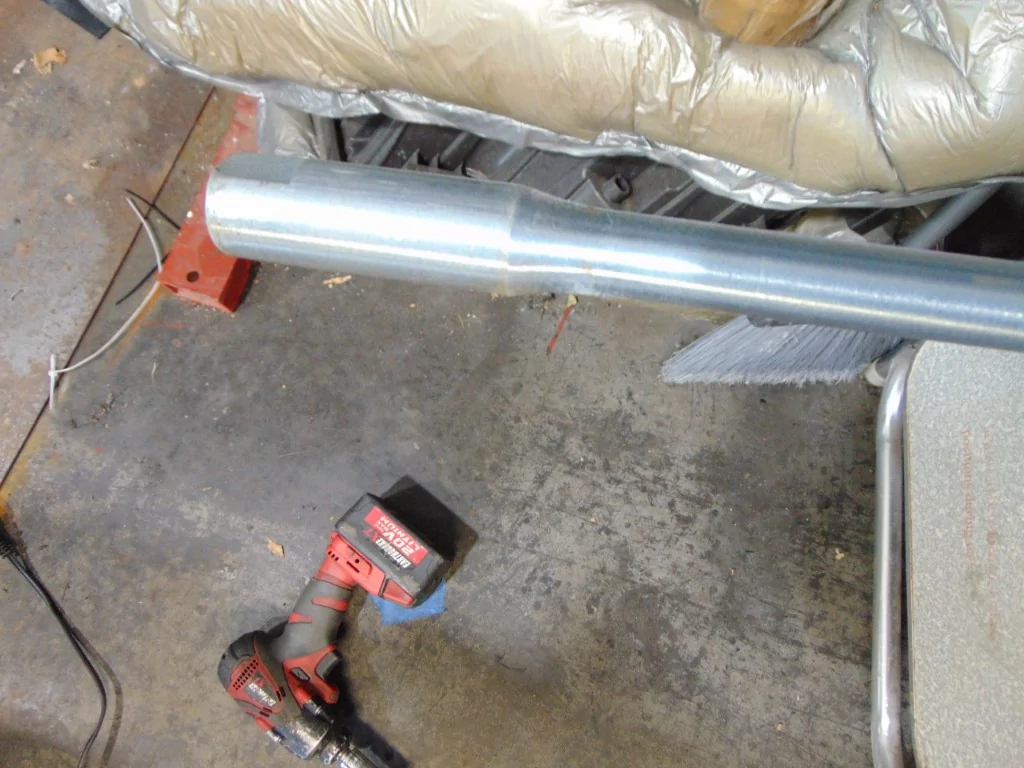

The sway lock concept keeps the thinner inner bar connected at all times, and with the flip of a lever, engages the thick outer bar, which actually improves on-road handling

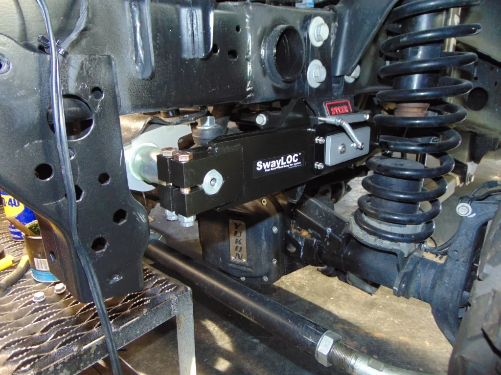

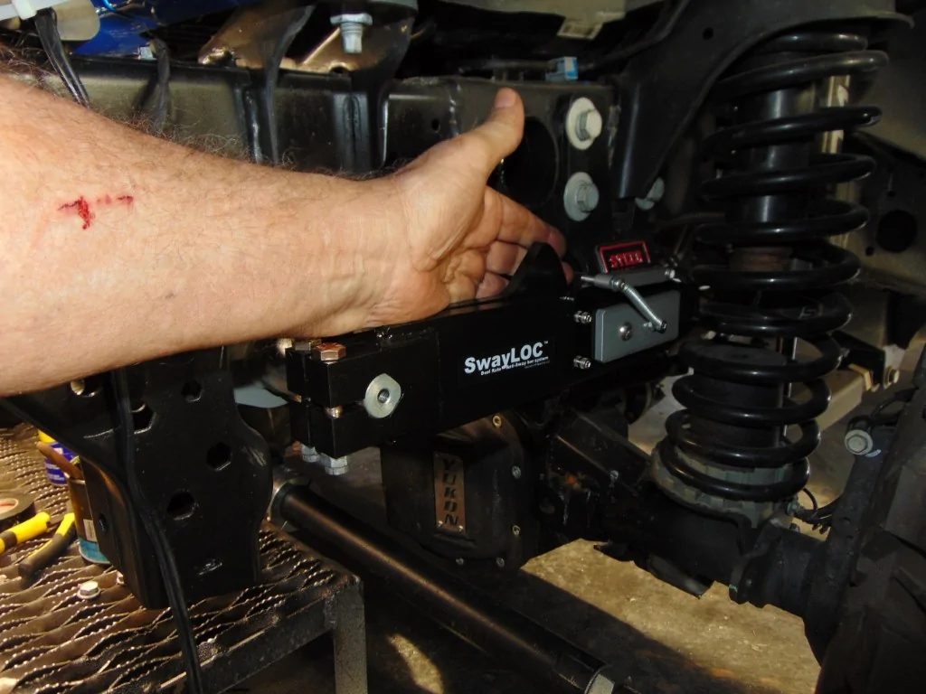

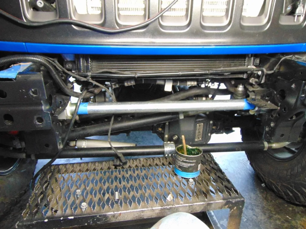

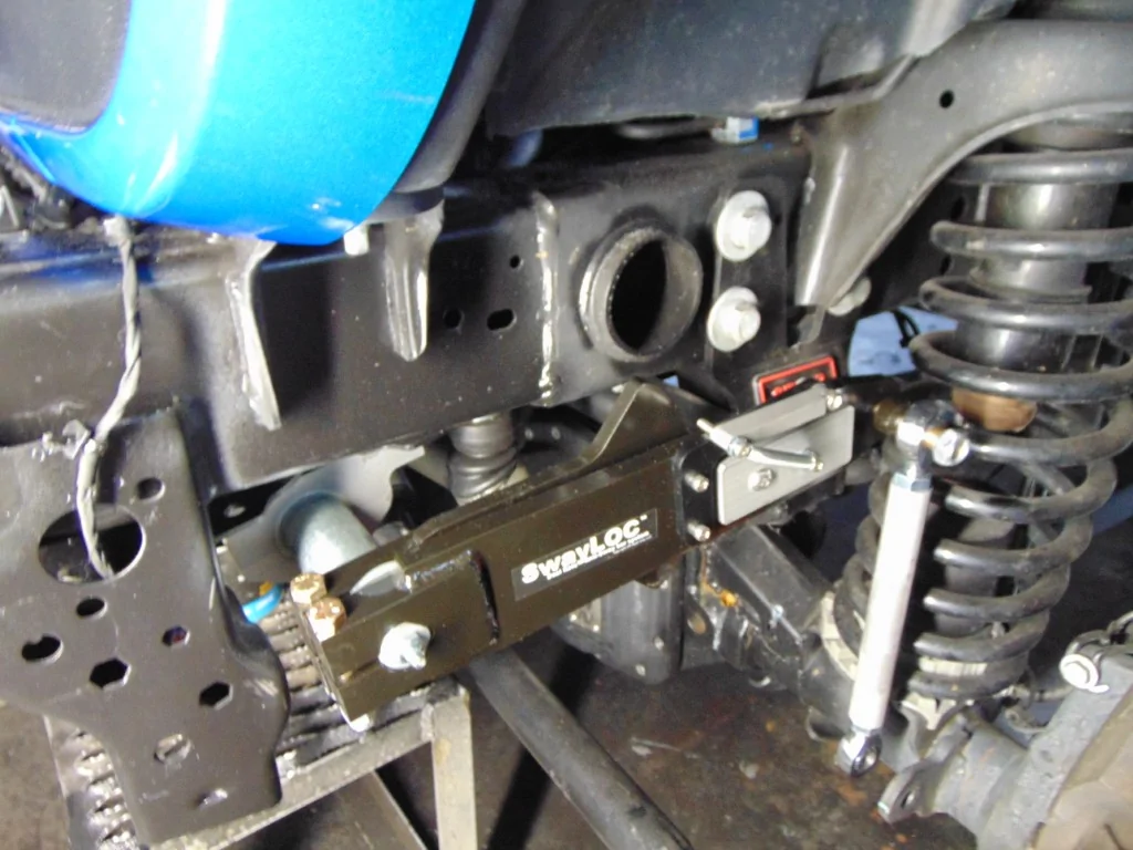

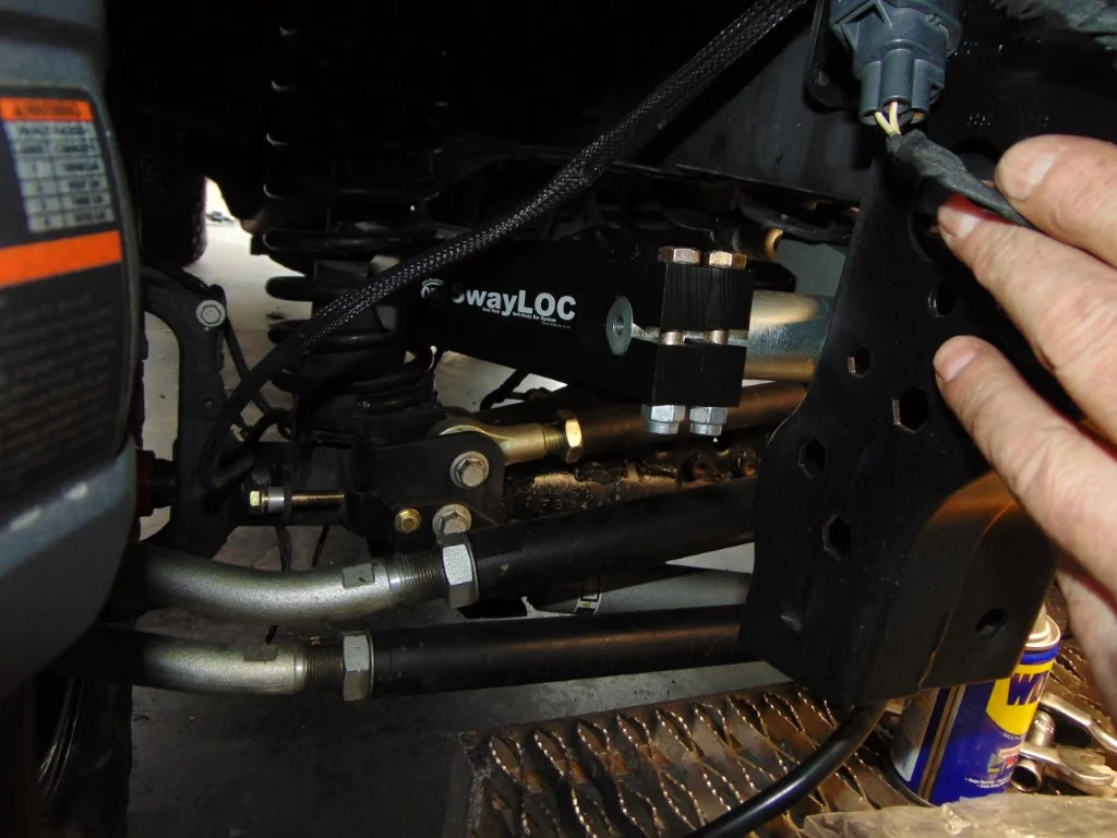

As per usual, I greased everything prior to assembly. I then pieced together the bar and mounts on the bench, then bolted that into the stock position.

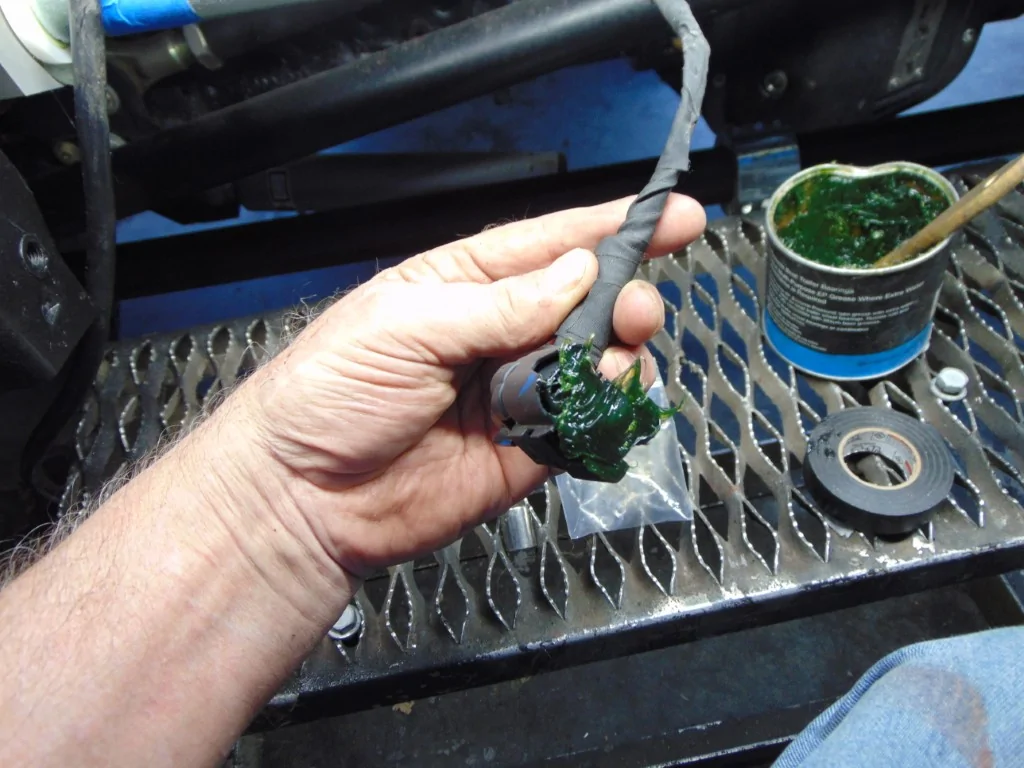

I packed the factory Rubicon disconnect connector in grease, then placed that inside a plastic bag, then taped all that up and zip-tied it out of the way.

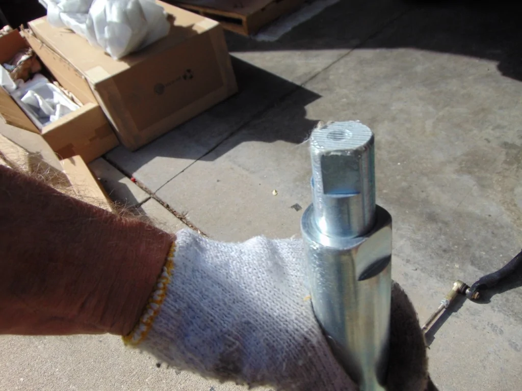

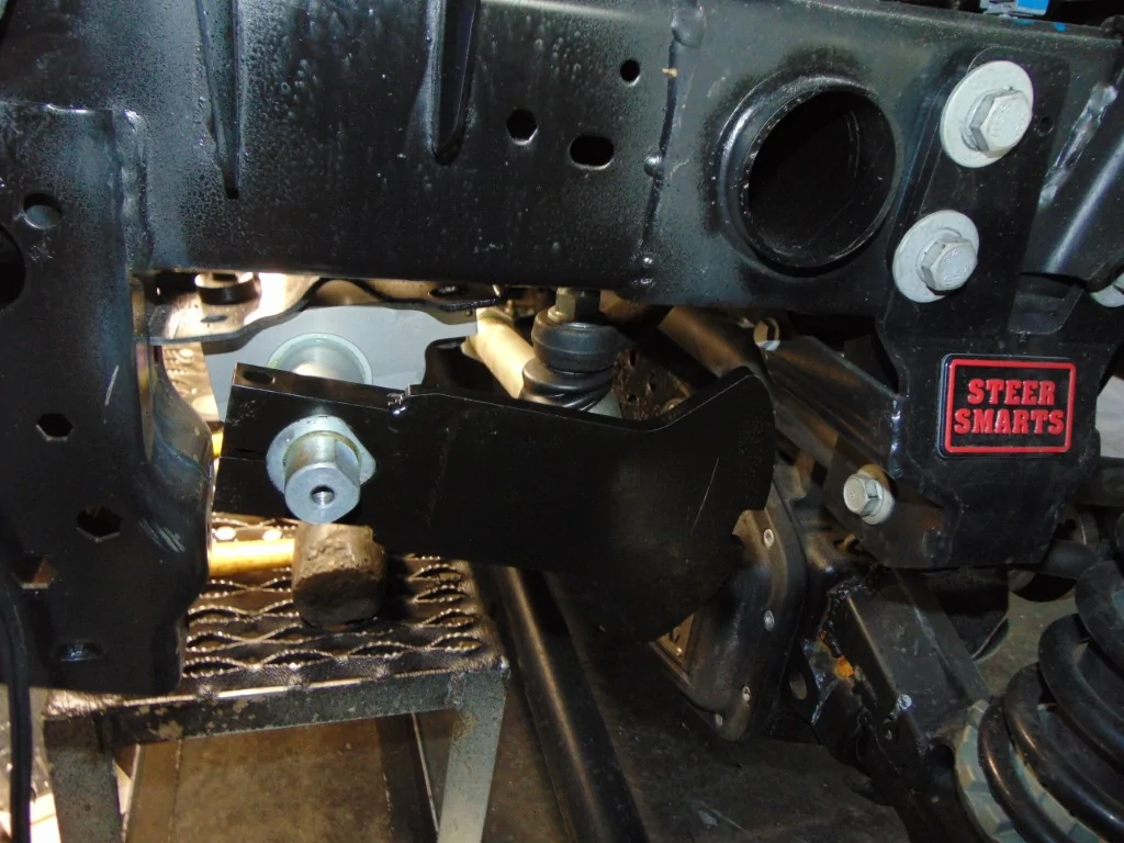

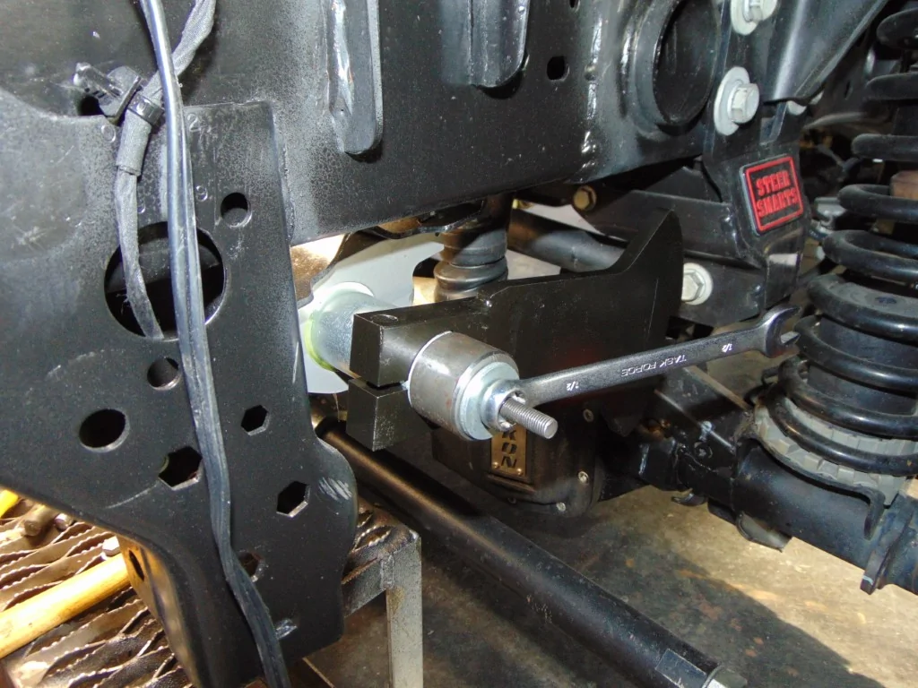

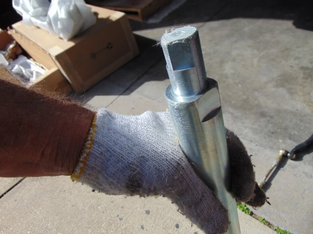

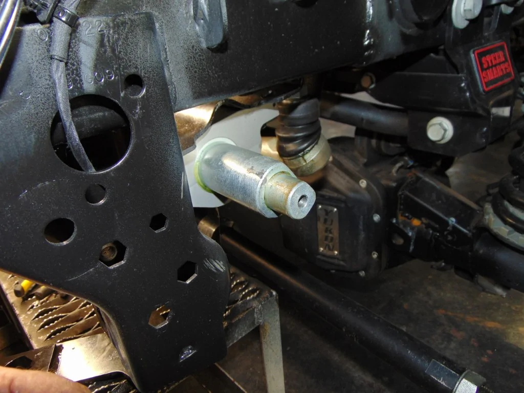

Then using a supplied puller, I pulled the right side arm onto both the inside and outside bars.
Jeep Gladiator 2022 AEV Gladiator Rubicon build DSC03382 (Medium)
Jeep Gladiator 2022 AEV Gladiator Rubicon build DSC03383 (Medium)
Flyin6
Flyin6
Jan 2, 2023
1,585
2,427
Kintuckee
22AEV JT370, 24 Ram 3500, 22 Caddy XT6
Aviator, rotary and fixed wing, Writer
It works quite well. You thread a stud into the end of the bar, then place a washer, then a nut to capture the assembly. Just turning the nut with a wrench pulls it all together quite nicely.
On the drivers side is the fixed inner.
Jeep Gladiator 2022 AEV Gladiator Rubicon build DSC03384 (Medium)
Jeep Gladiator 2022 AEV Gladiator Rubicon build DSC03385 (Medium)
Jeep Gladiator 2022 AEV Gladiator Rubicon build DSC03386 (Medium)

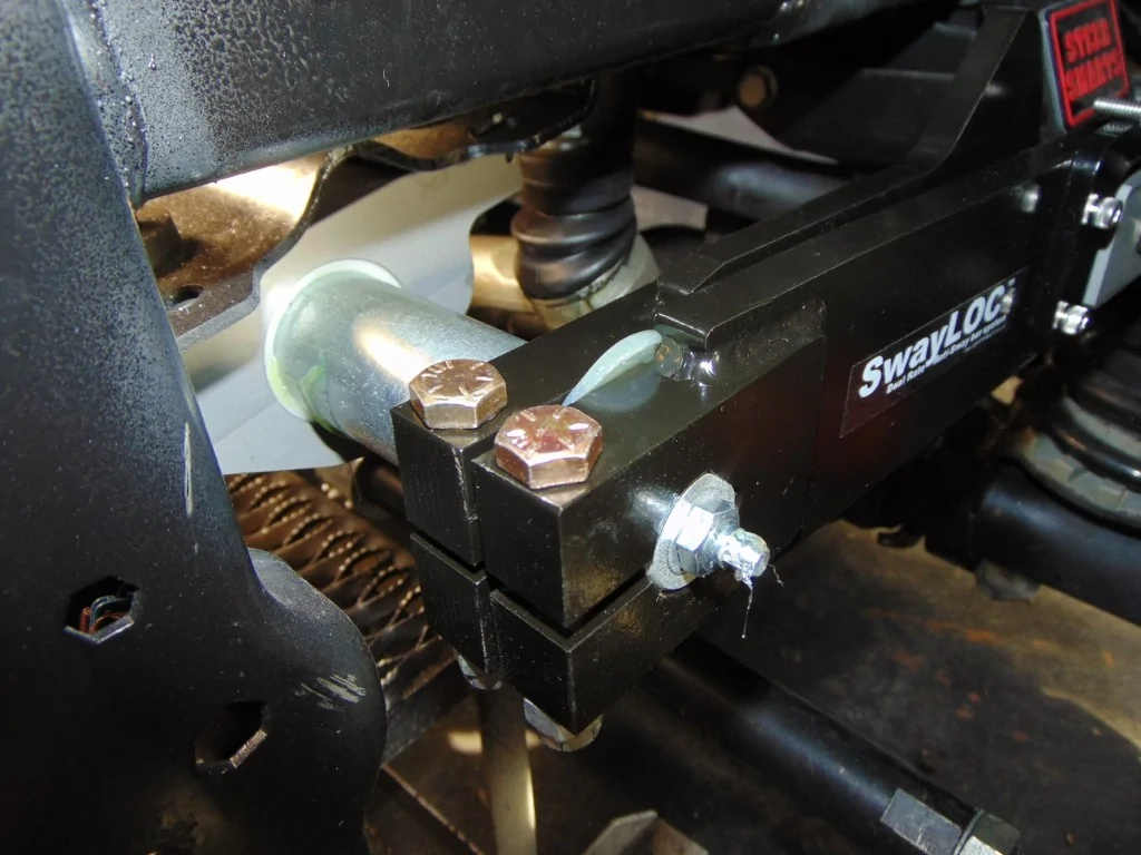

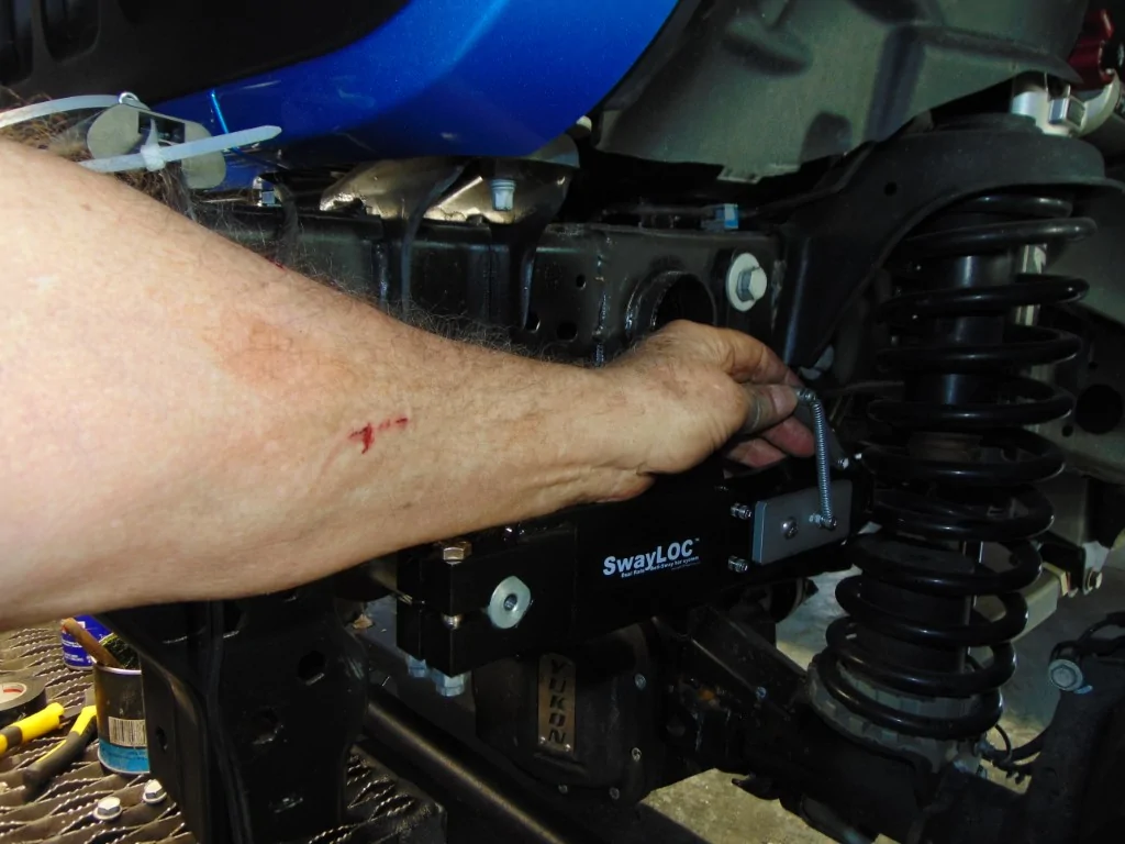

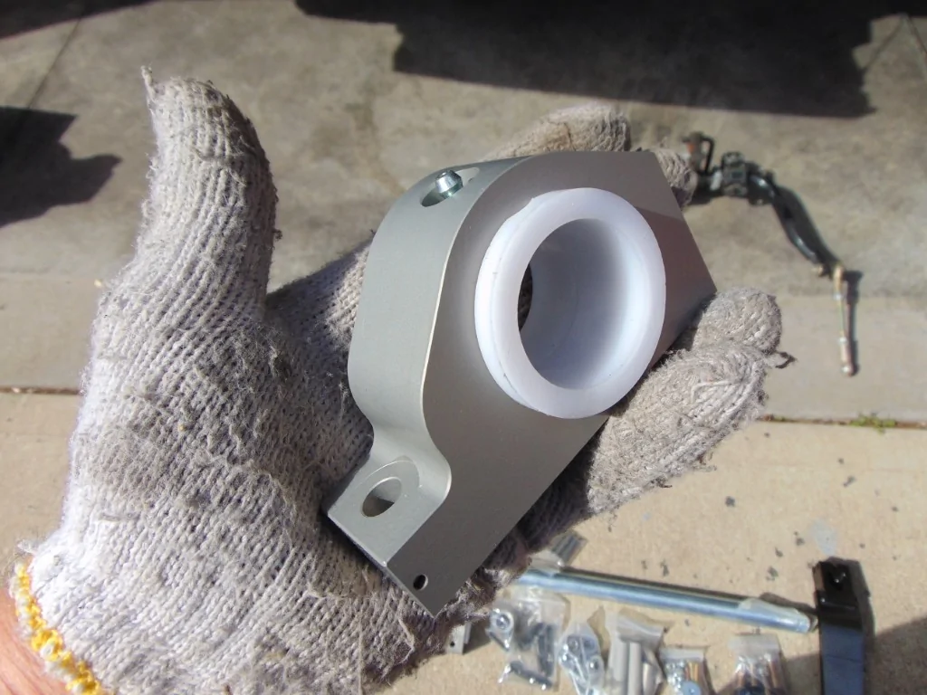

Then the outer arm, which contains the locking device, is assembled.
Jeep Gladiator 2022 AEV Gladiator Rubicon build DSC03387 (Medium)
Jeep Gladiator 2022 AEV Gladiator Rubicon build DSC03388 (Medium)

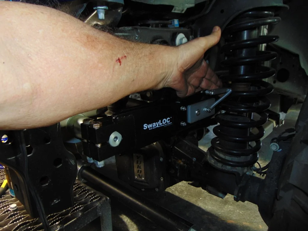

Showing the lock/unlock lever

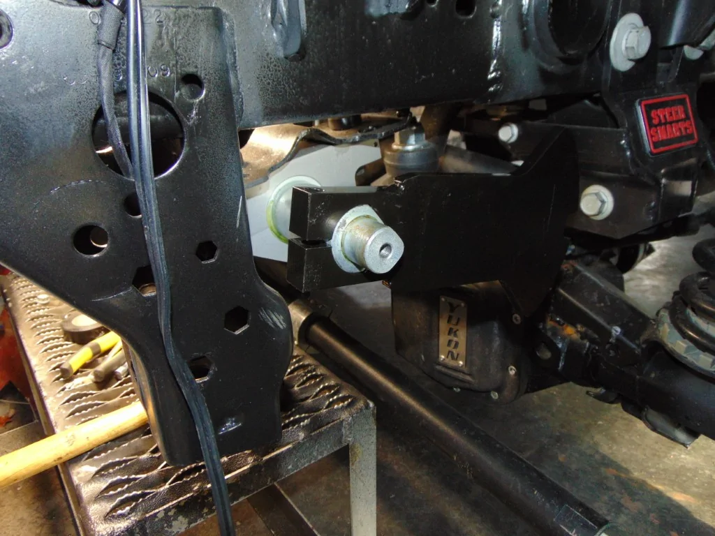

I screwed in the grease zerk into the end of the inner bar, then lubed everything.
I will not attach the arms to the axle until I install the new springs. I purchased 4" for the front and 5" for the rear. They are onsite so that will happen PDQ.

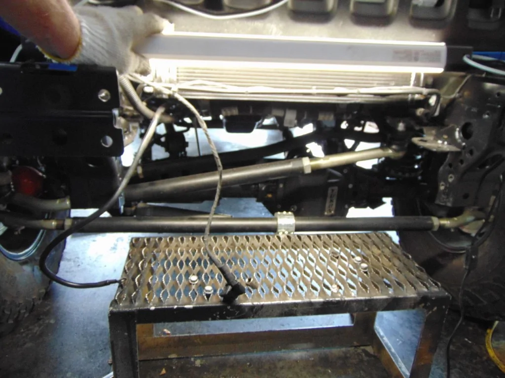

Now I am set up perfectly to install that new Gen Right aluminum bumper.

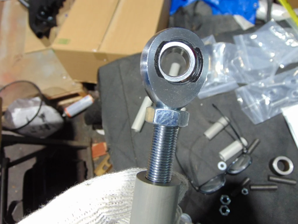

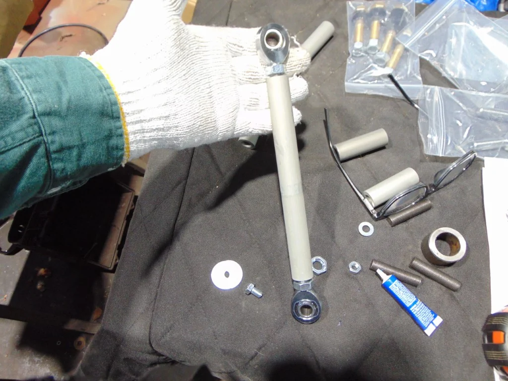

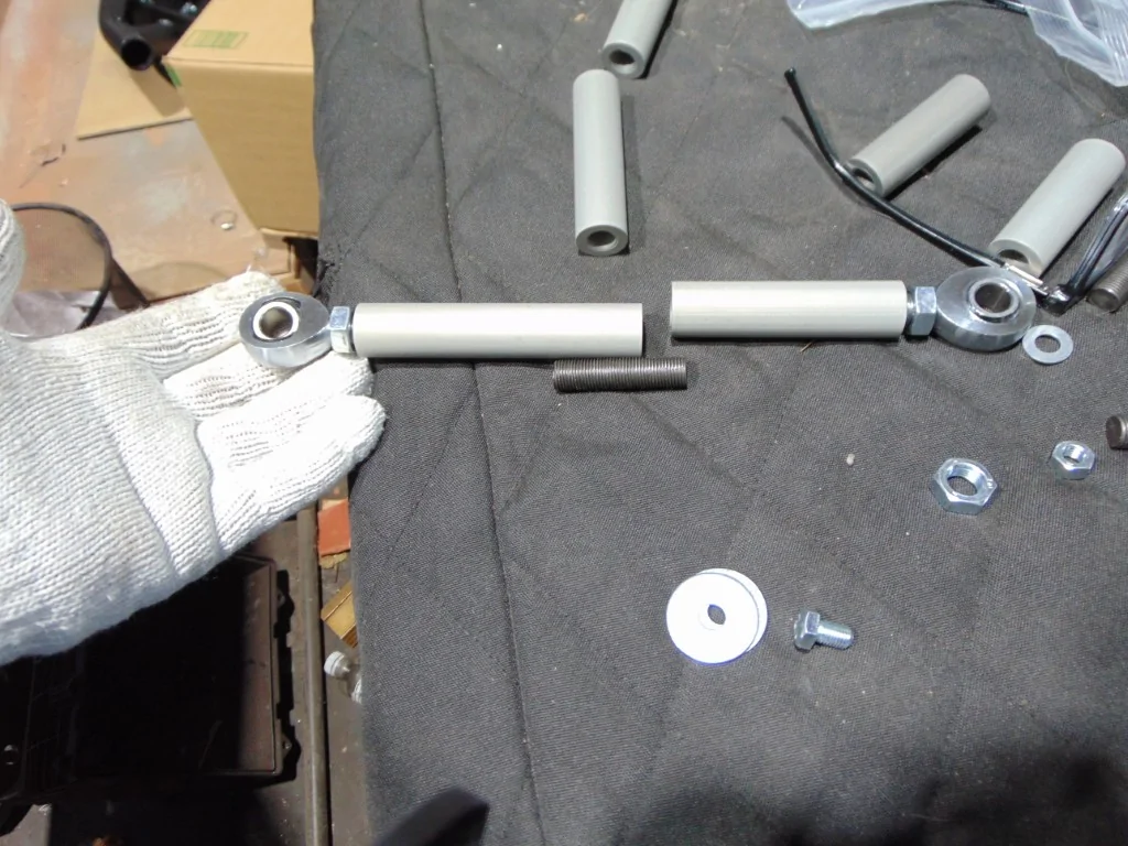

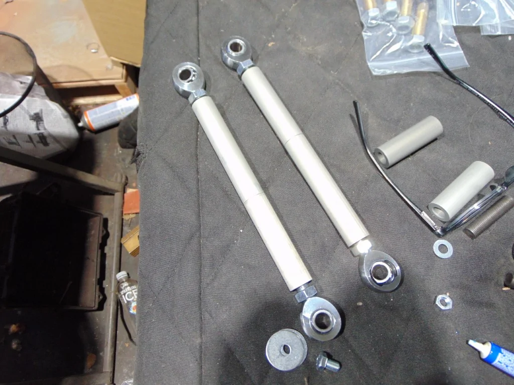

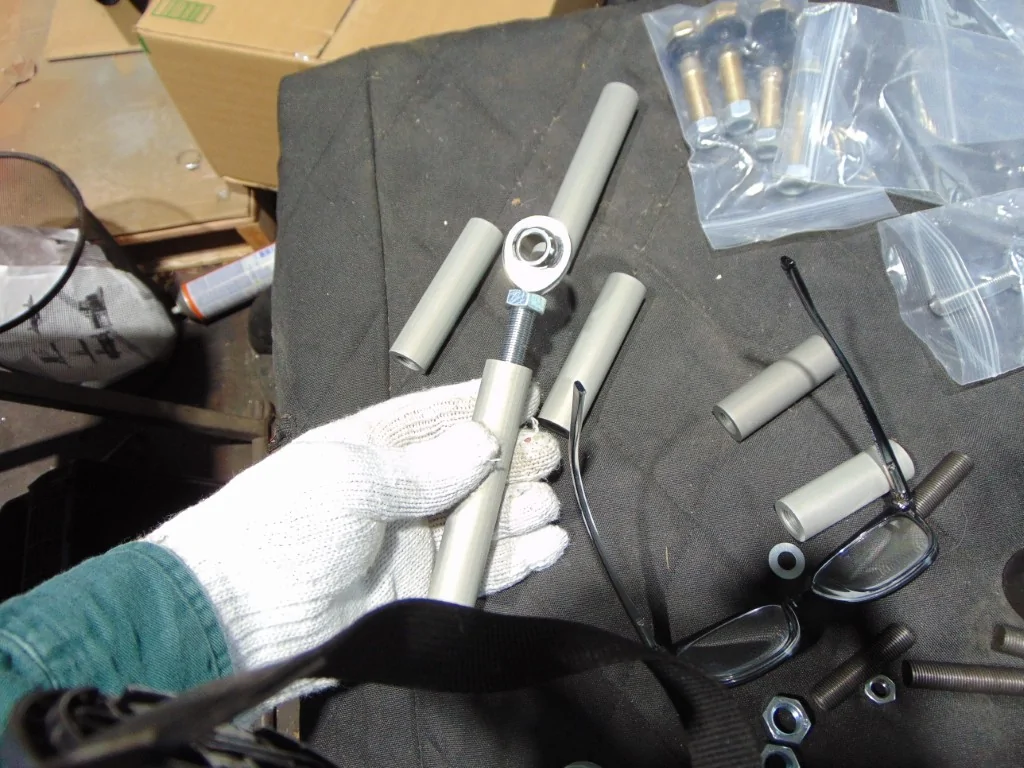

The end links are really beefy. They assemble from solid aluminium cylinders drilled and tapped to assemble the various parts into one solid assembly
Jeep Gladiator 2022 AEV Gladiator Rubicon build DSC03394 (Medium)
Jeep Gladiator 2022 AEV Gladiator Rubicon build DSC03395 (Medium)
Jeep Gladiator 2022 AEV Gladiator Rubicon build DSC03396 (Medium)
Jeep Gladiator 2022 AEV Gladiator Rubicon build DSC03397 (Medium)
Jeep Gladiator 2022 AEV Gladiator Rubicon build DSC03398 (Medium)

Based on the supplied cylinders of different lengths, I was able to build end links of the proper length.
Jeep Gladiator 2022 AEV Gladiator Rubicon build DSC03400 (Medium)
