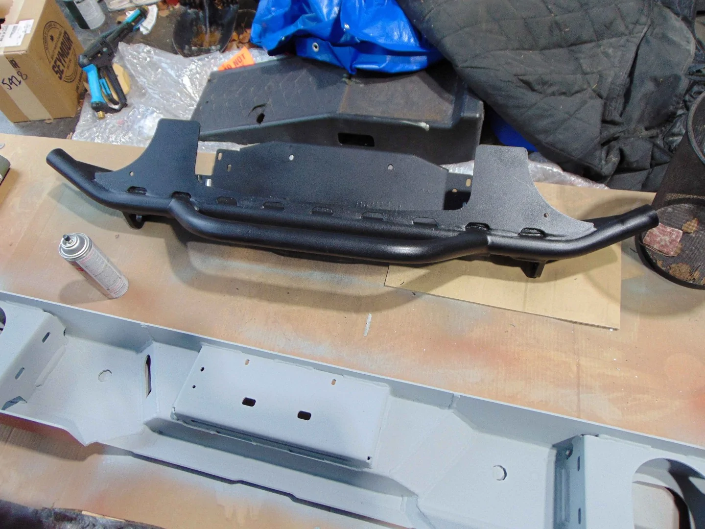

The bottom line is that I cannot live with that, so I ordered a new aluminum Gen-Right bumper.

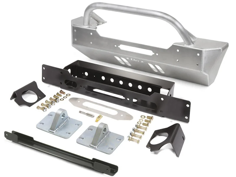

I seem to accumulate a lot of used Jeep parts for sale
I was looking at that bumper and saw that you need to switch to a Currie Anti-sway bar type set-up because you need to cut some parts off. Is that also in your build? Perhaps I missed in while wiping off drool perusing this thread.
I mentioned that in post #857.
I have an Off Road Only dual sway bar assembly. It is far superior to the stock Rubi sway bar in my opinion. For off-roading, you will have the skinny inner bar always engaged. When you close the latch and engage the hollow tube, you actually get a more substantial bar than the one the factory provides. I felt that would be a good idea with a 4.5" lift and that IKamper tent hanging out way up high. Thinking about it, you never disconnect the rear swaybar, so it makes sense to keep something hooked up in the front.

Oh right on, I’ll check that option out!
