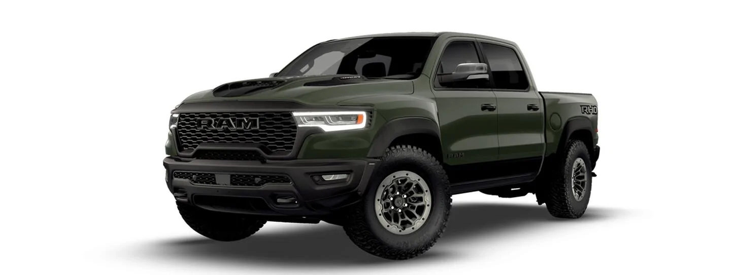

Just started something crazy
Ordering a new RHO!
The Gladdy is really just a fun/adventure truck. I seldom drive it, and being a 2022, still has under 20K! (But, what a 20K that was!)
My daily is a 2024 Ram HD dually about 100 feet long which you cannor park anywhere. I tow my Jeep on it and put a big slide in camper that I haul to cool places to hang out in.
So I needed a daily. Was thinking forever about a 392 Wrangler. but in the end it is not a lot for the money. Cool, certainly, but practical, naw.
But this is
2026 Ram 1500 RHO

Isn’t a RHO about the same price as the 392 Wrangler now that they lowered the price about $15k?
Probably closer. Looked at a MOAB 392 @ $84K. My list for the RHO just nudges $80K.

After reading the horror stories of issues with the TT straight 6 I think I'd wait for the 2026 TRX re-release.
Perhaps,
However, that TRX is a different animal. Do I love those things? Heck yea! But 10 mpg makes no sense for someone who wants to drive it cross country.
Looked at TT huricanes in RHO putting down 606 TQ to the road on a tune!
RHO's get 14ish, same as my Jeep, with some folks claiming 17.
Big thing is the price. That TRX will easily go $25K more than the little RHO.

I’d get the 392 and keep your Ram for towing. I’m pretty sure it’ll hold It's value better too.
To be clear, I am not trading anything. I'd straight purchase the RHO, adding it to my stable. The 3500 dually stays (I have a farm)

I’d still get the 392 Wrangler. 😂
His supercharged JT is going to be real close to the 392 in both performance and capability. The RHO is a different beast entirely. I might be biased as I spend a lot of time in the desert at speed, but you'll never get a JLU to handle rough terrain and/or speed in the dirt quite like a trx/rho/raptor. Wheelbase is too short being the biggest issue. We run too many tight trails to justify anything that wide, but once we move to our AZ property/retire there will definitely be one in the stable.
We are both talking with personal preferences and uses. I don’t like daily driving a full sized truck. A RHO/TRX would be even worse for parking with those wide fenders. Plus a 392 Wrangler is just cool and as much as I do like his Gladiator, it’ll never sound like a 392. Nor will the hurricane. They’re oddly quiet and still a 6.
