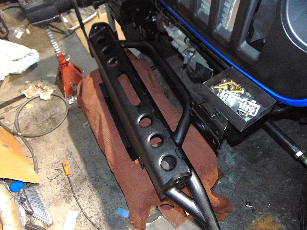

I'll get after exploring the SC thing in a bit, but first, I need to get it all put back together again.
That means the front bumper and the winch.

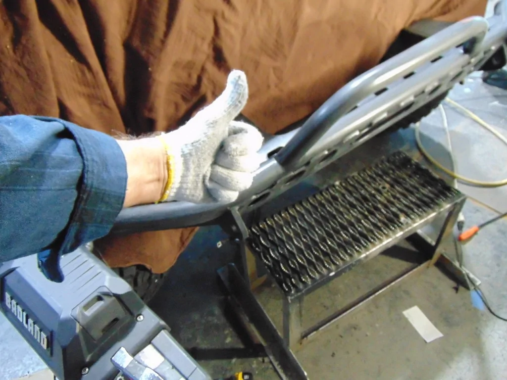

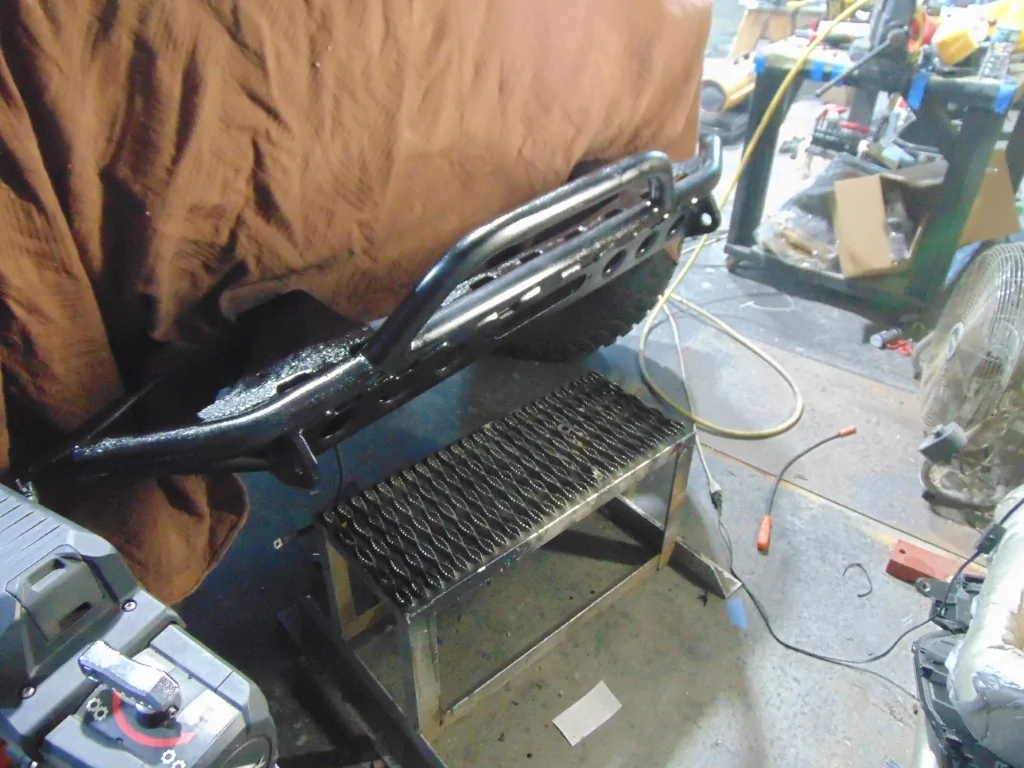

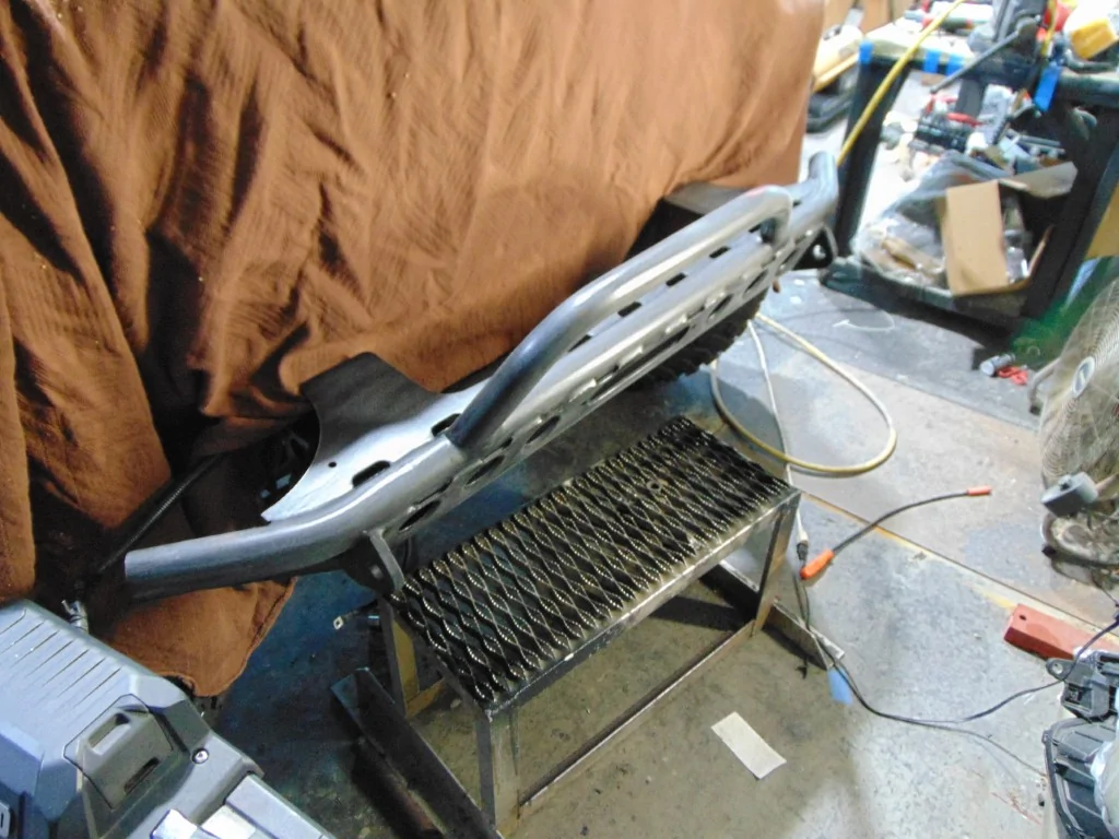

After giving it a good fit, I wasn't completely happy with the finish, so I scuffed it off and shot it again. As soon as it sets up and dries, I'll toss all that back together. The new paint appears to have bubbled up in spots. Not to worry, that's what it does. I guess its part of the reaction process that creates that unique finish.

I’ve never had any lucky getting a decent finish with that stuff. I used black laquer spray paint and two coats of satin clear.
I had a pretty good finish the first time, but after moving it around, I noticed some light spots. It will either work or it won't. If not, then I'll sand and do something else. Anyway, the bigger issue is just getting it put together. One more day, then I am down hard for a while.
I think it’s super sensitive to impurities in the metal. It was probably an error on my end. I think part of the reason I’m getting nice finishes now is because I’ve been taking more time with prep.
