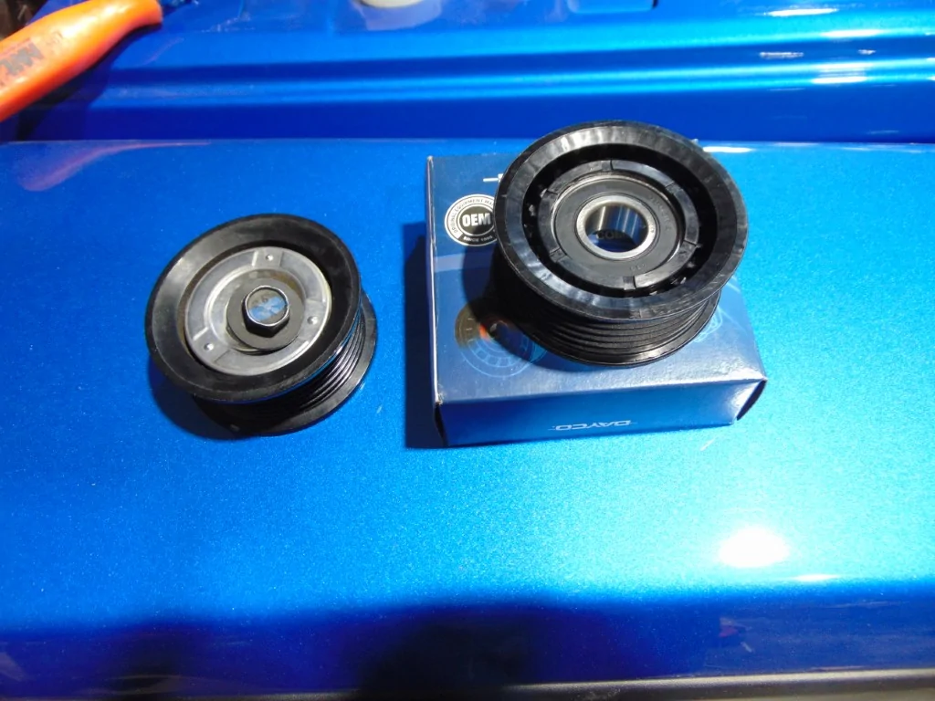

I started this morning prepping to install the new SC unit that was overnighted to me.
While waiting, I decided to replace the factory idler pulley. I think the existing one was just fine, but in the spirit of eliminating anything that could be troublesome and have caused that noise, I picked up a new one. That was a mistake. It cost me $55 and it has exactly the same play in it as the one I just took off...Oh well...

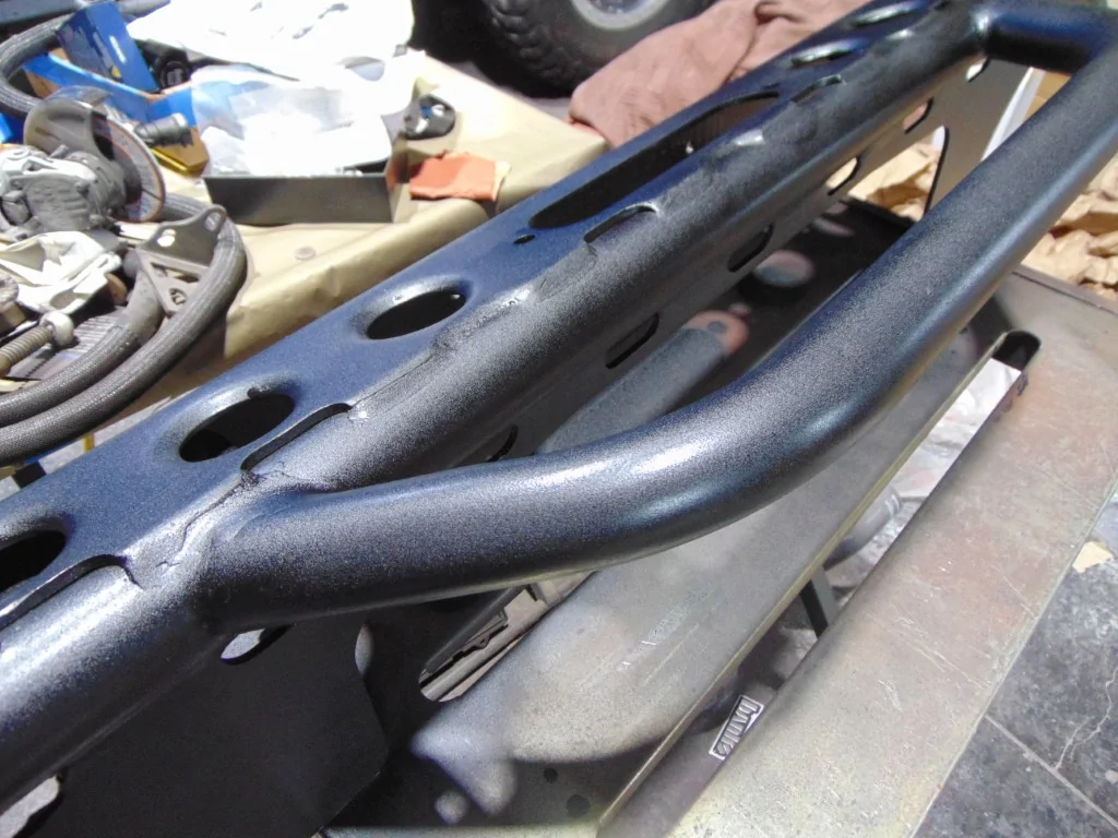

Oh, and that Rustoleum bed liner stuff is brilliant, as my British friends would say. I think I have a new favorite. It is shinier than the others I have used, with a unique texture/appearance.

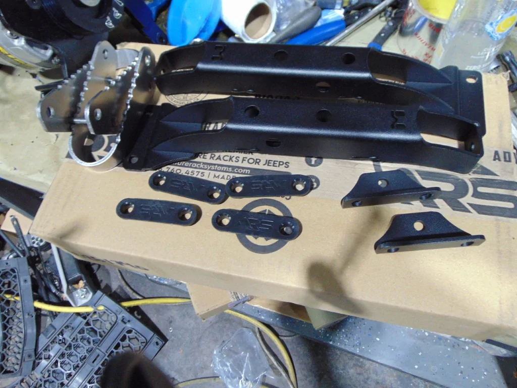

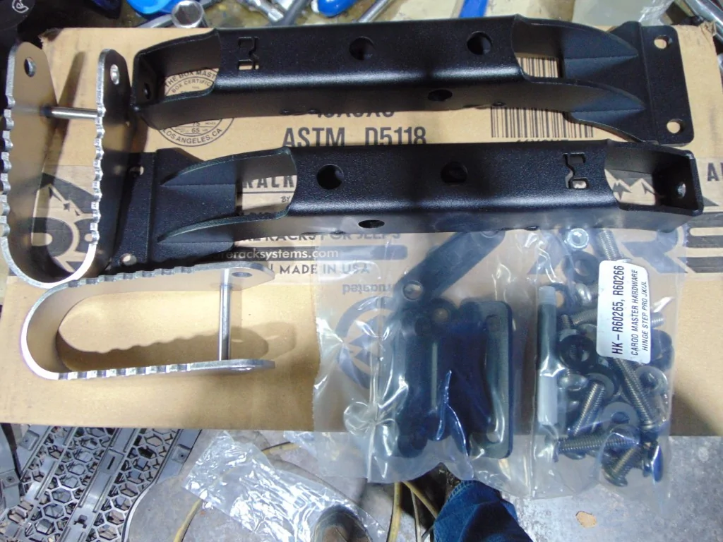

Well, the day was getting right along, and I was dressed for the occasion, so why waste any time?
I have a bit of a pile of parts I haven't installed, so what the heck, I'll pop those Metal Cloak side steps on that I have wanted to see and use.

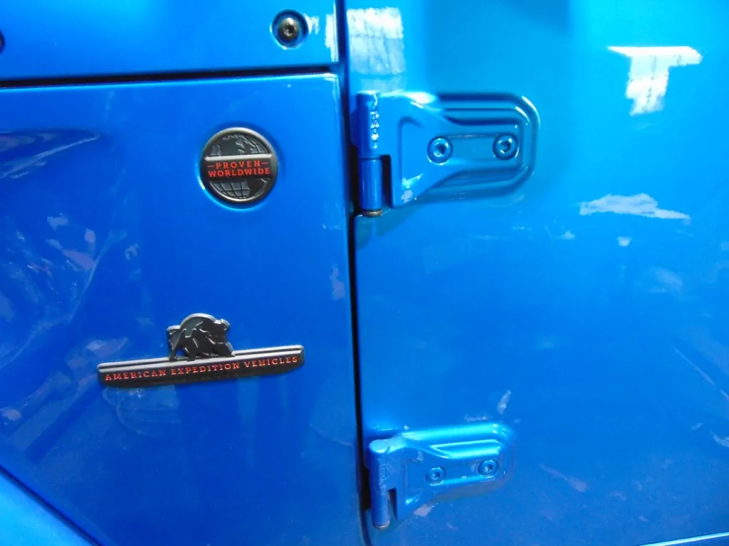

I had no idea it would turn into some sort of satanic ritual, trying to loosen those door bolts, which are #50 Torx. I mean, they would not budge. I cranked so hard on my 3/8" drive #50 that I twisted it all to heck and back.
The supercharger still had not arrived...
Do I search a YouTube video where the installer emphasizes the need for a 1/2" drive and a long breaker bar!
What??? Breaker bar? These things aren't holding the wheels or the bumper on, so why would anyone torque those bolts as if they were holding a small state in place?
And, the Supercharger had still not arrived.
Ah, screw it, I'll drive to the closest tool store, Harbor freight and buy a big one. (Mistake).
I find a 1/2" drive #50 Torx bit and get my breaker bar, and yup, if you really lean on it, it will just break the bolt free about 6 oz torque short of grenading, which mine did on the third bolt.
So, feeling the blood pressure climbing up toward the yellow range on the pressure gauge, I decide to just wait out the supercharger, which is being delivered today (NOT).
So now it's dark outside, and I am looking for the towel to toss in the ring, err, garage. What a day...
Try placing the bit it the door hinge bolt and giving it a few taps ( dont hit the door. ) also a electric impact that oscillating action may actually breaks it loose the vibration.. maybe some PB blaster( swear by that stuff.) 🤔
Dont just tossing ideas out it's probably steel to aluminum corrosion.
I took the socket and taped on it with a small ball-peen before trying to loosen it, nothing...
I thought about using the 3/8" electric impact, but I don't have a socket at the moment! I use PB Blaster as well, but not on this. Maybe have to give it a squirt.
Thing is, this was supposed to be a 30 min project, not turn into another "thing."
Getting the supercharger reinstalled and running is Job 1. Tuesday morning, I get a new knee installed. I opted for the Metalcloak joint since it has the most deflection. ;-)
