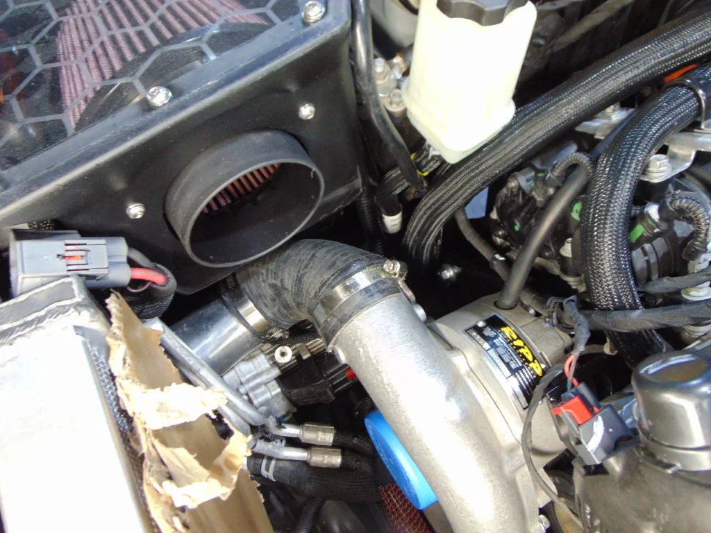

The new supercharger is installed, and the engine is running. This one sounds a little better, but it still has that loose-lash gear-kickback sound.
I found the source of the whistle, the blow-off valve.
I was surprised by how much pressure I felt at the up-pipe from the intercooler. There is a hole for the manifold temp sensor, which I had removed for the test run. Air was blowing out of that hole at an idle!
I still have to bolt the bumper and winch back on to be roadworthy, but at the moment I am deciding if I am happy with all that noise this supercharger makes.

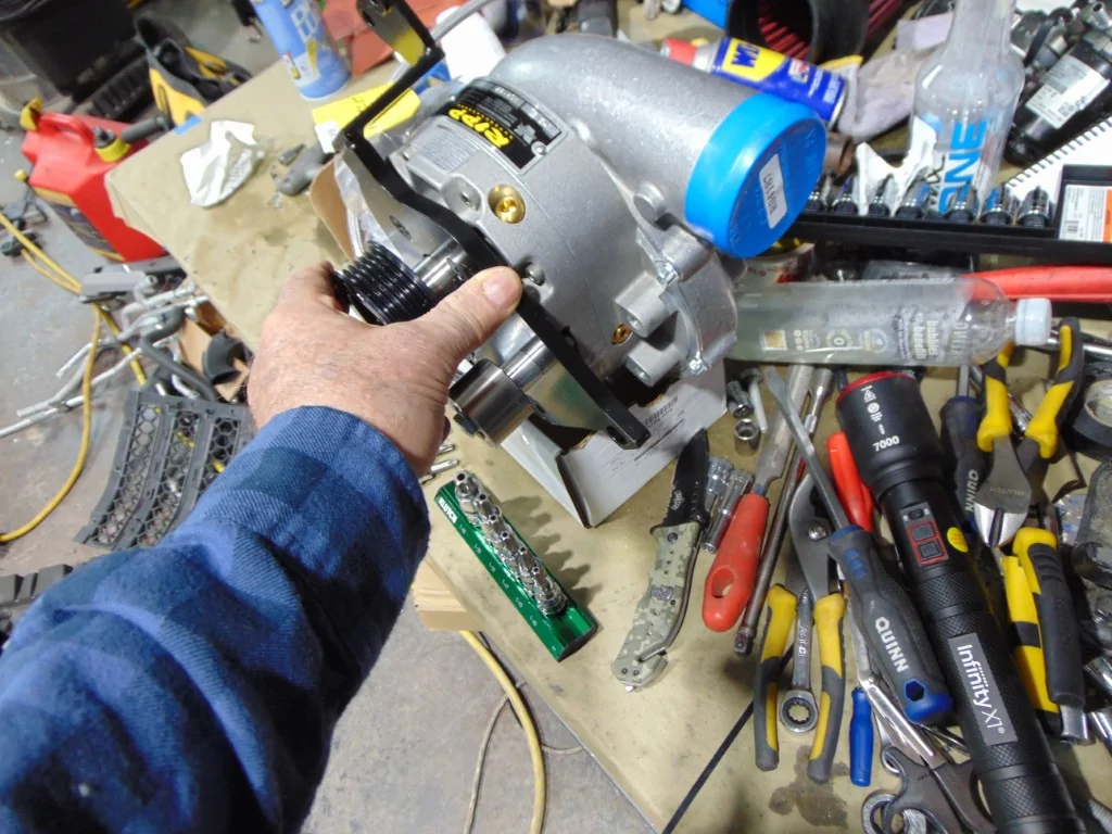

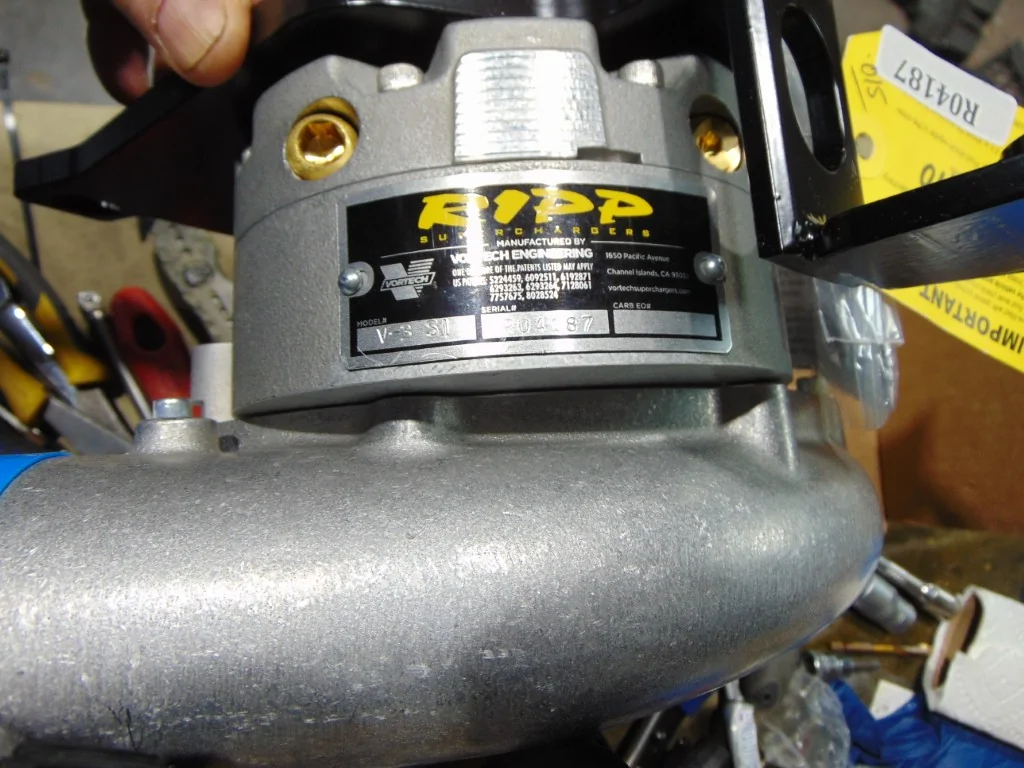

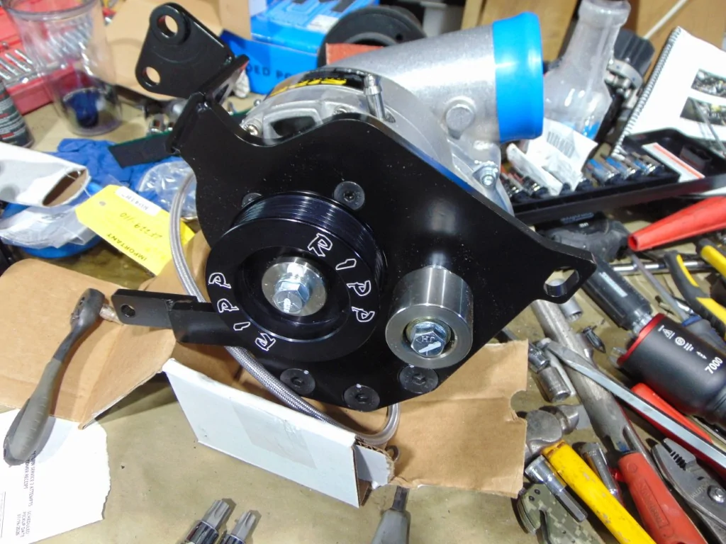

So, here is the new one, same as the old one...
Someone from this forum contacted me and suggested I prefill the blower and spin the pulley a bunch before installing it, so I did.

And here it is installed on the motor:
You may note that I changed up the routing of the heater hoses. After having them crowd me at the front of the engine, I moved them behind the blower. I think I like this better.

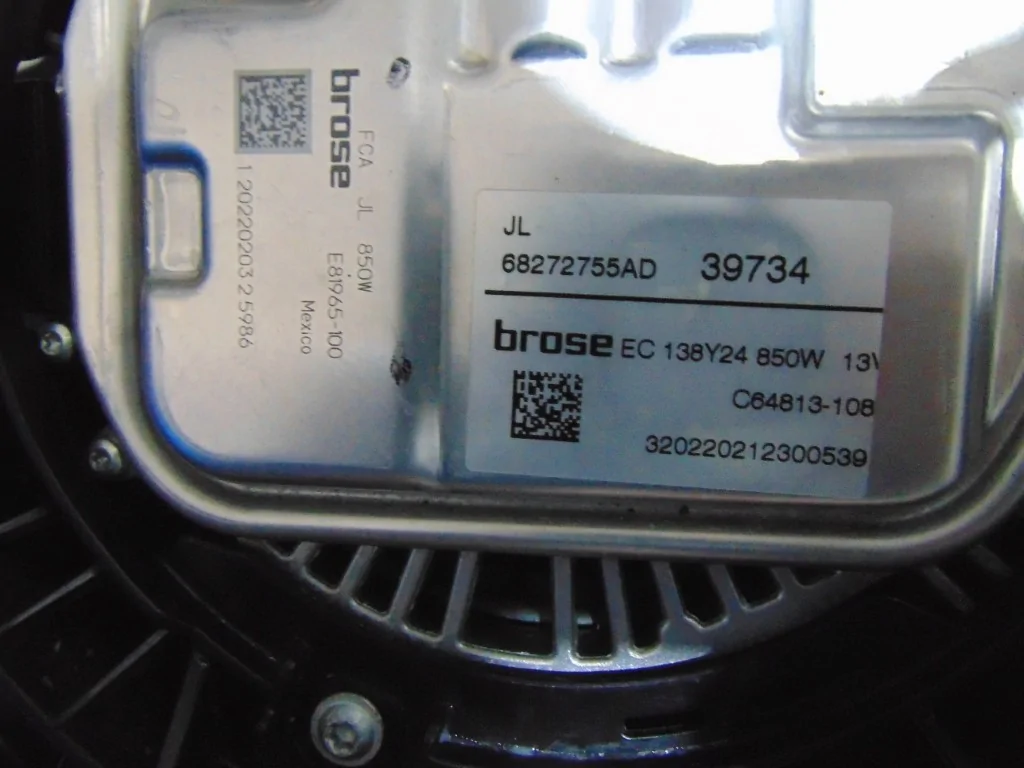

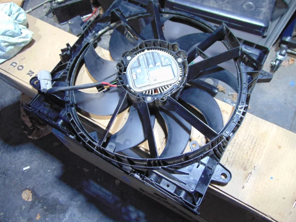

I wanted to create a record of the cooling fan, which, as you can see, is the 850-watt unit.
The fan is sitting on my next project, which I will tackle as soon as my new knee heals properly

Here it is running just fine. The head unit definitely lets you know it is there. I never thought the thing would be this noisy, but it is. At idle it is making boost, you can feel it flowing out of the up pipe when I pull the temp sensor out. I guess this is what it is going to be. I am hoping it will wear in and quiet down some.
