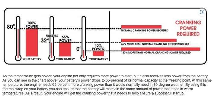

As for battery blanket vs heating pad… I used a battery blanket from day one during cold weather in central & north Alberta Canada and had to get my batteries replaced on warranty in January at 54,038 Kms (33,578 miles) this year. To put this into perspective, I’ve owned my truck for two years as of August this year, and today I have 77,150 Kms (47,939 miles) on it. I drive a lot for work and bought the diesel in the hopes of getting longevity out it’s Eco Diesel engine.
As I mentioned in an earlier comment, I may even add a small heating pad for the auxiliary battery. I do really like the comment about using a timer to turn it on and not have it plugged in at all hours while in my driveway, however I’m not sure that would work well for me as I’m often getting up at all different times if I’m working from my home town.
IMO, a battery heating pad heats the entire battery from the bottom as heat rises. A blanket doesn’t heat anywhere near as well and is difficult to get installed into the box as they’re fairly thick and just don’t do as good of a job.
I am not trying to change your opinion, just sharing mine for all readers. This is definitely a good conversation to follow:)
I'm not opposed to using a battery pad if the banket is too cumbersome to install. As a matter of fact, the OEM uses a non-electric insulating banket already, so adding the pad might be the way to go. Either way, having either the heating pad or the heating blanket is important when the temps get down to 0*F or below.

As for battery blanket vs heating pad… I used a battery blanket from day one during cold weather in central & north Alberta Canada and had to get my batteries replaced on warranty in January at 54,038 Kms (33,578 miles) this year. .

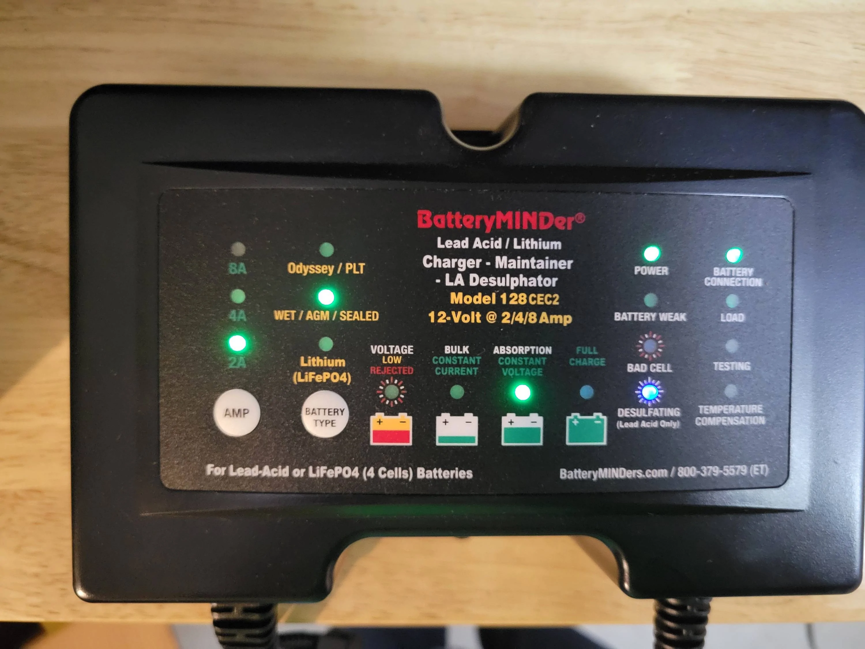

I think everyone is going to have battery issue unless they are charging and maintaining their battery. This is why I installed the BatterMINDer EZ Connector to the front bumper. I now have it charging/maintaining/desulfating several times each month. I could be wrong, but I believe that I can keep the OE batteries in good shape for a minimum of 5+ years simply by maintaining the batteries.
