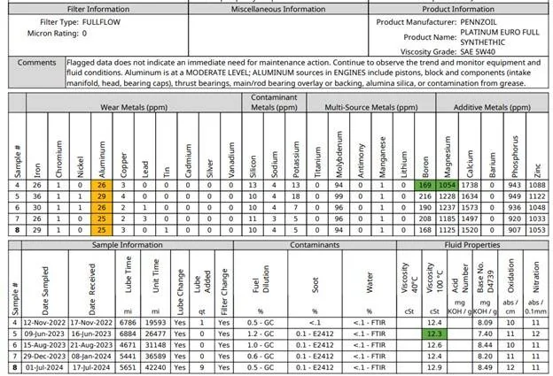

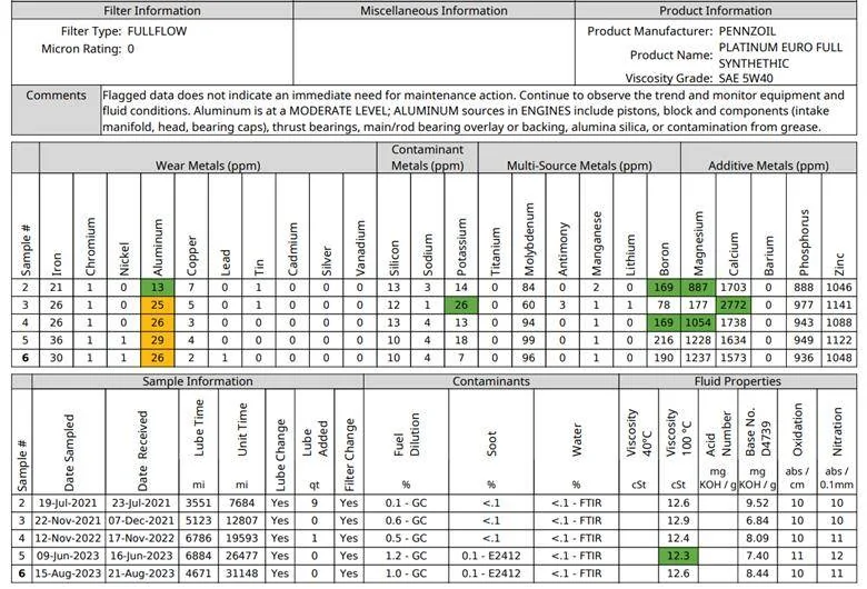

Even though I do a fair amount of idling, fuel dilution hasn't been an issue with any of my EcoDiesel trucks. UOA results have always come back good.
Can I see your last UOA?
biodiesel
biodiesel
Dec 8, 2018
2,314
3,004
New Mexico
2015 Ram 1500 Ecodiesel
The Jeep is still on the factory fill. I probably won't change engine oil until it turns 5,000 miles or 12 months, whichever comes first. The build date is 12/06/2023, but I purchased the Jeep on 4/12/2024. Technically, to meet warranty, I don't need to change the oil until 4/12/2025.

Oh I see, you did UOA on the Ram Truck? Did you post your Ram one some where?
biodiesel
biodiesel
Dec 8, 2018
2,314
3,004
New Mexico
Yes, I've posted each one in the "Official 2020+ EcoDiesel Oil Recommendations" thread. I can also post my last 5 results here:

Thanks for the posting. Looks like 2x more wear over the the latest one on the Ram 3rd gen I saw William post with MR tune (post combustion fuel stopped or greatly reduced with that tune).

Yup, in this case, good tuning will reduce wear metals on the 3rd gen EcoDiesel. With that said, I'm planning to leave mine stock for several more years.

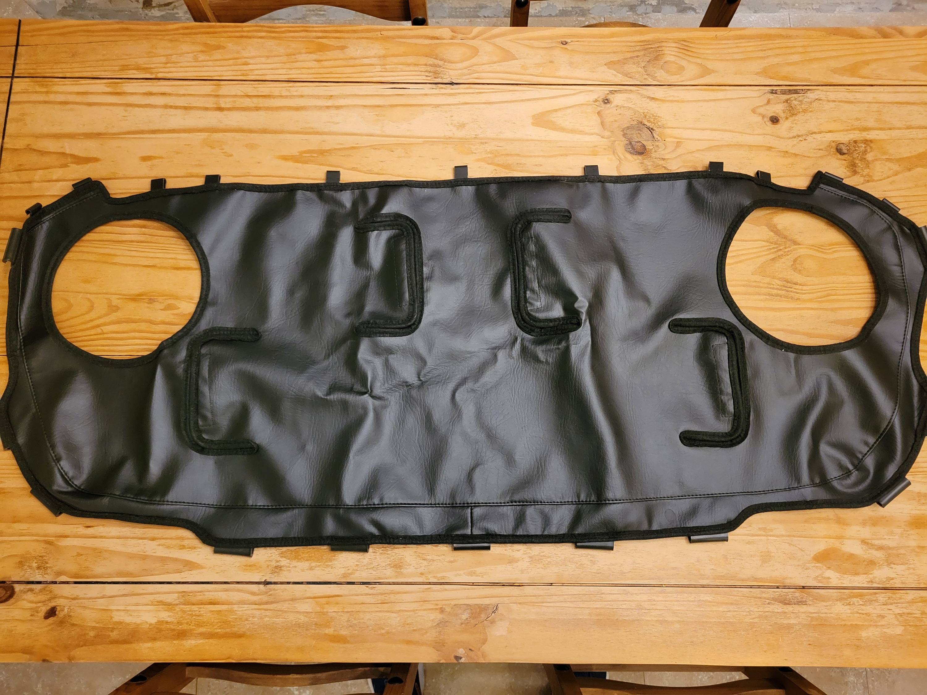

An aftermarket scan gauge will give you much more data than the factory display. Where did you mount your data monster?
biodiesel
biodiesel
Dec 8, 2018
2,314
3,004
New Mexico
The cold weather cover arrived last week.
