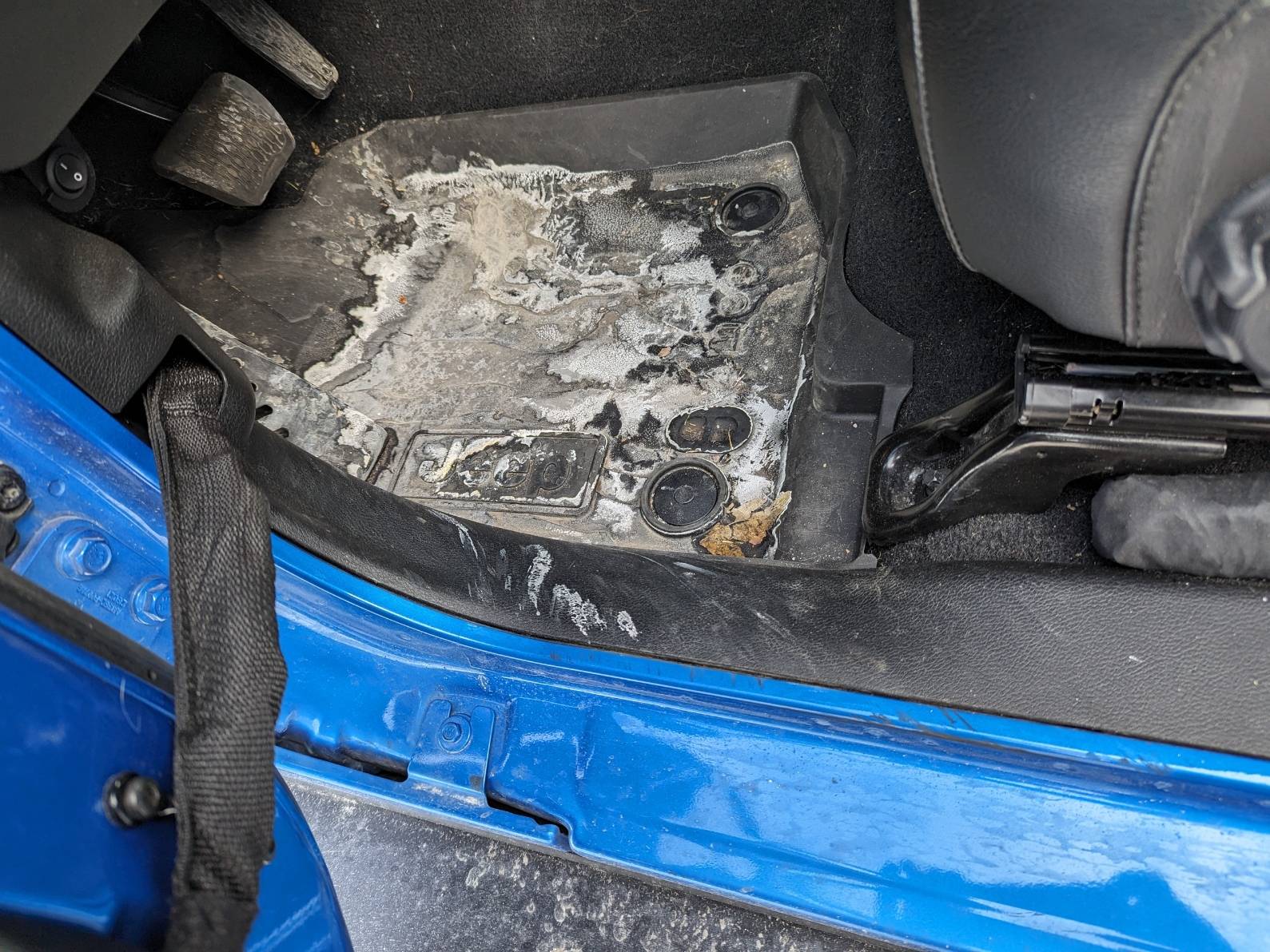

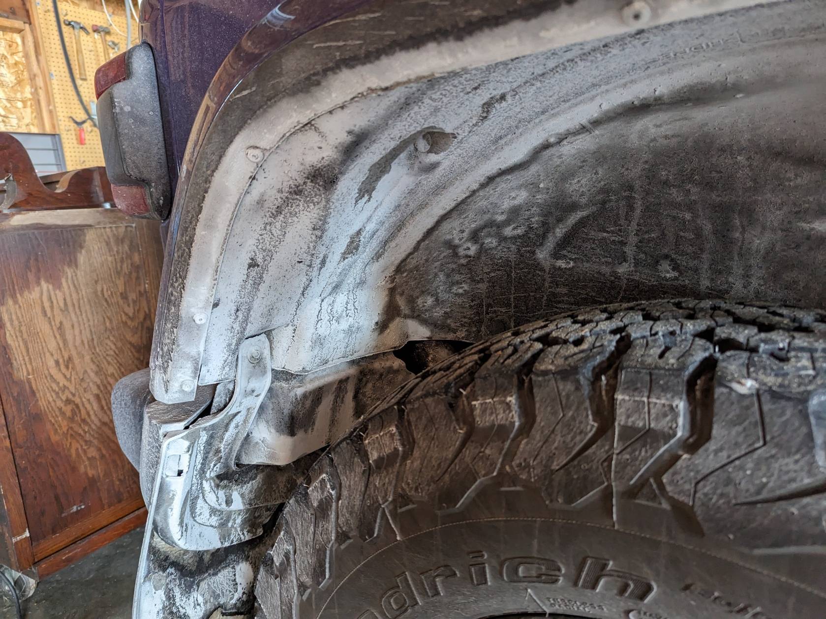

There's a number of threads on this - I've had almost all of my trucks undercoated professionally. The exceptions had issues, those undercoated did not.
Two of my classics were undercoated, 1 was not. Guess which one has issues with the truck and wheel wells.
The two with undercoating - one a 1970 (I bought out of MN), the other a 1982 - no rust.
I will continue to have any new vehicle undercoated and - will do what one is supposed to do - MAINTAIN IT.
Too many have it done and then just ignore it.
Cold doesn't matter - in fact, the colder areas may have less trouble. The salts shown below are ok until things get warm and humid, then all !#$% breaks loose. It's the climates like in the midwest that rot the heck out of vehicles, where any sort of salts are used.
Iowa owns stock in all sorts of salt companies - all sorts of nasty salts.
