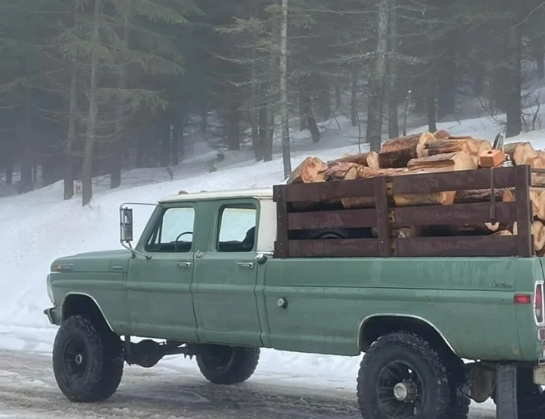

This is my 1968 F350, coated with old engine oil every year since 1974 when my grandpa bought it.
Anything oil based works, including actual oil. I use woolwax on the wifes Gladiator because it smells nicer.
All of my vehicles see all of the snow and salt.
