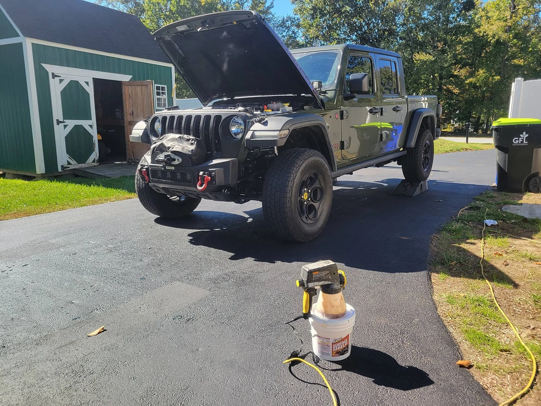

I was looking at this when I bought my JT in 2024. I wanted something I could DIY. Fluid Film has good reviews, but is supposedly a little runny and a bit smelly. I went with Woolwax, and bought a nice sprayer. This would actually be kind of fun if I had a lift, but not quite as fun on jack stands.
It does stay fluid, so picks up road dust, but on the bottom I don't really care. Minimal odor and it's not a bad smell. I was really impressed how it resisted the huge amount of salt we use here in Minnesota. I did a really thorough job the first year, and more of a touchup on exposed surfaces this year.
If you go with an outside company, I would ask if they plan to drill access holes anywhere. Personally, I would not want access holes.

Blaster Surface Shield gets my vote, but that is usually a self application process as not too many shops spray it commercially.
I’ve used it with rattle cans, how’d it go on with an airless sprayer? Never thought of that
Works great. Just use the heavy latex nozzles.
I'm in Minnesota and have been considering Woolwax. MNDOT does use a lot of salt. Did you use rattle cans or a sprayer? I appreciate your insight.

Wow, what a year up here! The first real winter we have had for a while. I am no expert, but I did go with a sprayer. Even without a huge air compressor, it seemed to work fine. I just went slower so the compressor could keep up.
I used extension tips to coat the inside of the frame where ever there was an access hole. As a rookie, I was not sure what the best settings for the sprayer were, so I might be a little thick here and there, but that's not a real problem. Based on other suggestions I warmed up the Woolwax to about 100F in a water bath. If I had had a lift I think I could have done a better job, but I went with some very tall jack stands and did the best I could.
I recoated in the fall, and was really happy to see that there was no visible rust underneath (except for the exhaust, which is a bit hot to spray with anything).
