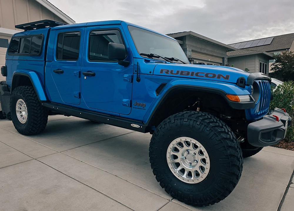

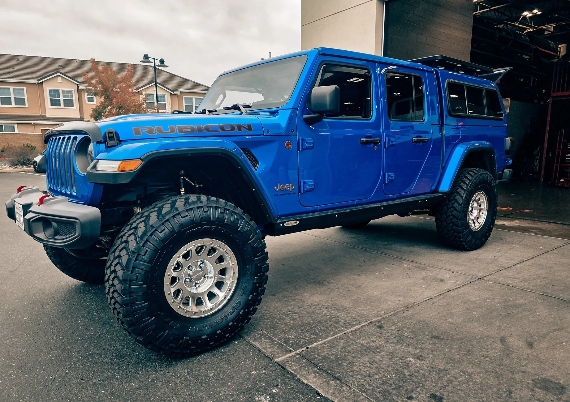

A bit of troubles in paradise to report on the wheel/tire setup, but mostly good.
1. The Method 709HD lip bolts were WAY over torqued from the factory. When trying to pull them off (to install the rock guard rings), I broke a few on 2 of the wheels.
Method is aware of this problem and are shipping me 2 replacement wheels as well as covering the mount and balance.
2. The Metal Cloak Game Changer lift and rocksport black shock combo...
While road manners are awesome, feels planted, power with the 4.56 gears feels unchanged... it also feels a bit stiffer than stock even on the softest setting. A slight increase in bumpiness was noticeable with the old tires and more noticeable with the new 38" Nitto tires. I know Nitto has a pretty hard (durable) sidewall so I'm experimenting with tire pressure to see if I can soften it up a bit more. I really like a soft ride. So far I'm at 34PSI and will probably test 32PSI next.

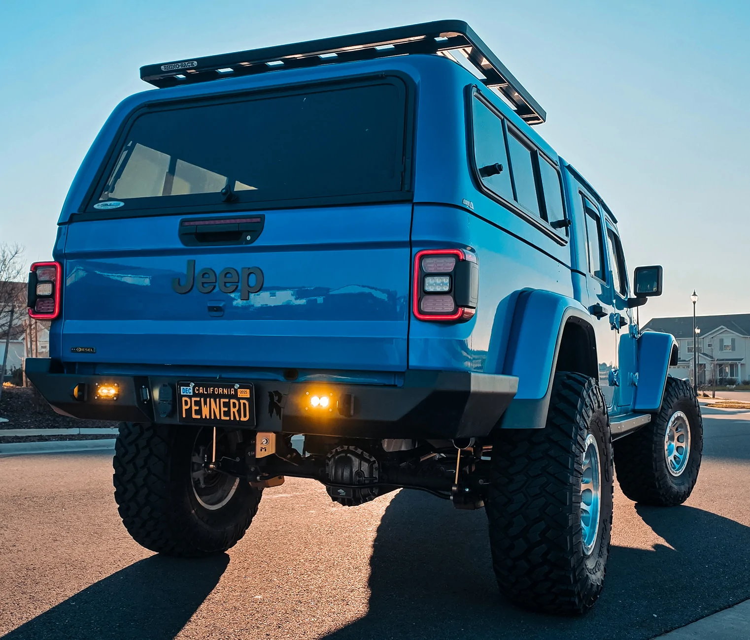

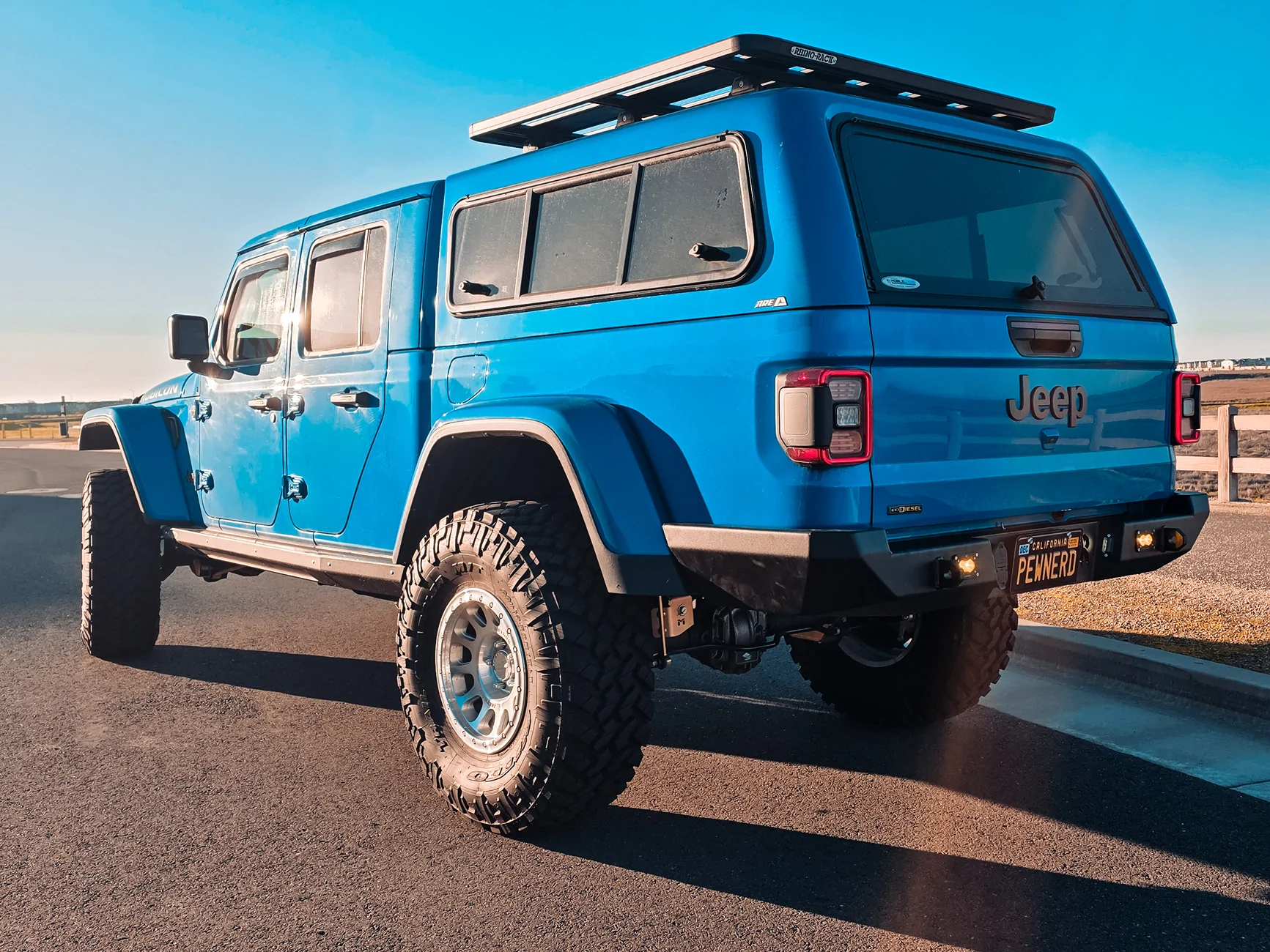

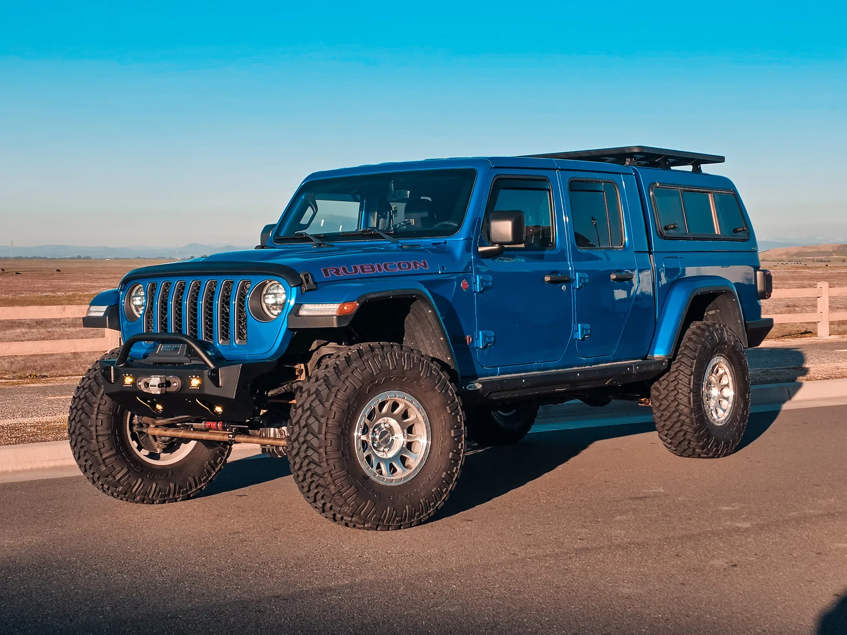

Relentless Fabrication front & rear bumpers obtained and installed!
Made the drive over Donner Pass at the beginning of the recent storm system that hit the west coast. That also gave me an opportunity to try out snow driving with the Nitto Trail Grapplers and happy to say, zero issues. There were 3 cars that spun out, one hitting the center divider. The gladiator had no issues with traction at all. Just drive like you should when you're driving in the snow.
Jeep Gladiator 2023 JTRD Build Thread - "Blue Jeep" 1767027955988-v

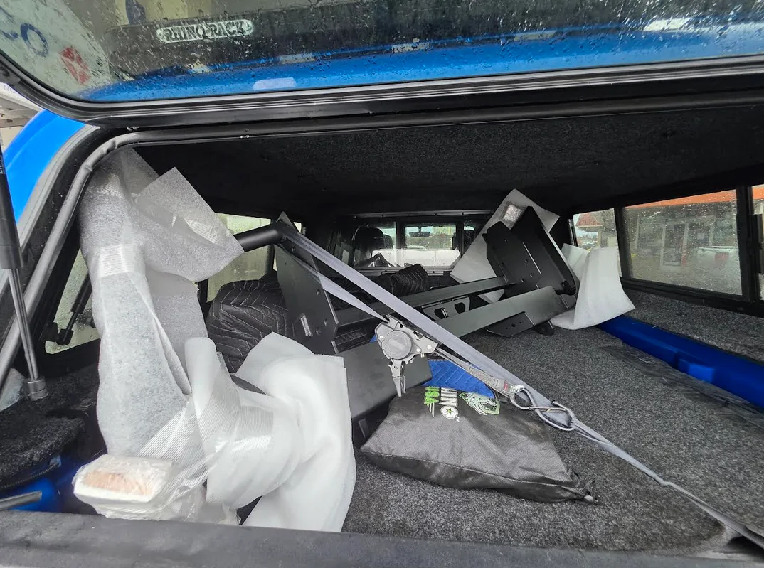

Relentless Fabrication has a pretty cool shop. It's big, with a lot of nice equipment. The entire shop is run by the owner and his wife. His wife was welding up the next batch of bumpers while he was cutting steel on the plasma cutter. So if anyone is wondering why the lead times are what they are, this is why. The entire operation is run by 2 people, which is honestly amazing if you ask me.
The owner helped me load the bumpers and we were both surprised that they were able to fit with the tail gate and shell window closed, after some creative use of ratchet straps.
Jeep Gladiator 2023 JTRD Build Thread - "Blue Jeep" 1767028135673-yv

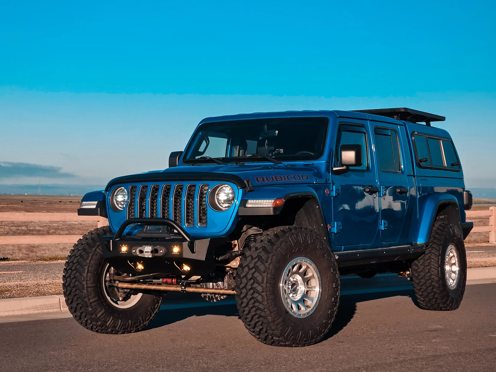

The weekend after Christmas while I still had family at my house, I employed a strong nephew to help me get everything mounted up before he went home. I did all the electrical the following day.
I love the result and couldn't be happier.

For anyone wondering, the Badland Apex 12k winch fits VERY snug... but it fits. We had to mount the bumper up loosely with 1 bolt and then drop the winch in. Mount the winch and then tighten up the bumper.
Also, Loc-tite all the things because I don't want to do it again. lol

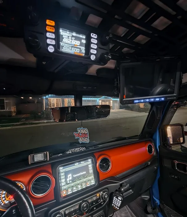

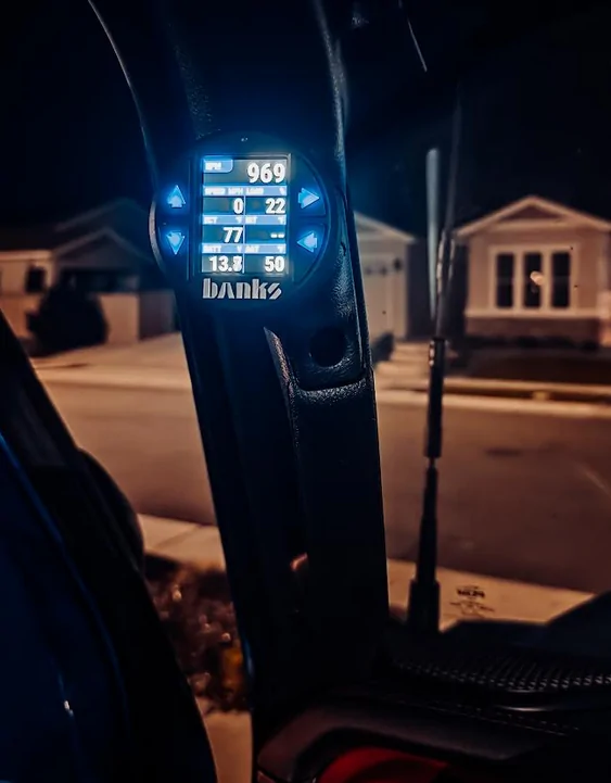

Yesterday was one of my rare free days so I wired in my rear-view camera screen, my HAM/GMRS radio, and the Banks iDash Pro.
I'm just so glad that this is done and I only have 1 more irritating electrical job to do (IIRC). lol
The radio is my trusty Yeasu FTM-300dr that I took out of my wrangler. It's been MARS modded to open up capabilities in HAM and GMRS on one 50w radio. While I'm licensed for both, I don't really use HAM and have never transmitted on HAM frequencies. Everybody I know uses GMRS for comms.

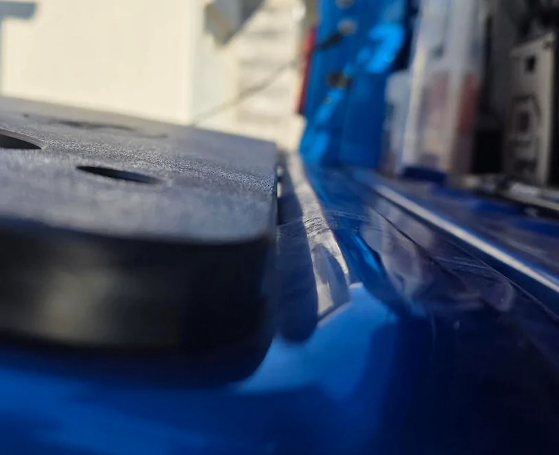

How tall does the Hooke Road tailgate panel thing sit? I've been wanting to find something that sits at about the same height as that stupid little bump a the bottom edge of the tailgate. I have to prop my bed drawers up slightly to clear that stupid bump.
ericw.
ericw.
Eric
Aug 18, 2025
374
577
USA
23 Gladiator Rubicon Diesel, JKU, Audi S7, Mercedes AMG GLB
It's a bit taller maybe 1/8-1/4 of an inch.
The decked drawers have wheels on the end but they don't contact the tailgate at this point.
