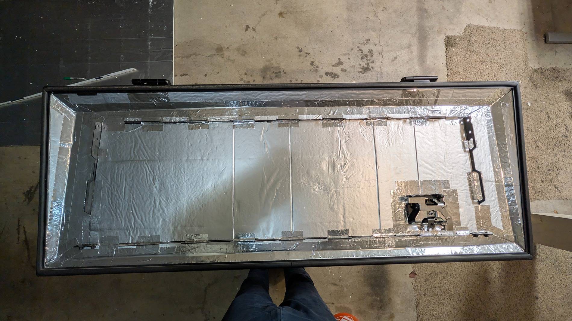

Finished up adding insulation to the doors. I used 1/2" foam insulation with a R value of 3.2 from home depot. I put the silver side in as I'm trying to keep heat in and not out. One thing to note as a lesson learned and for anyone else who comes across this thread and wants to do the same, test fit the door before putting any carpeting on. On at least the SP Gladiator doors, the top rain channel surrounding the door opening does not allow foam to be placed on the upper angled part. Don't be like me and have to fight with getting the carpet unglued and the foam piece out.

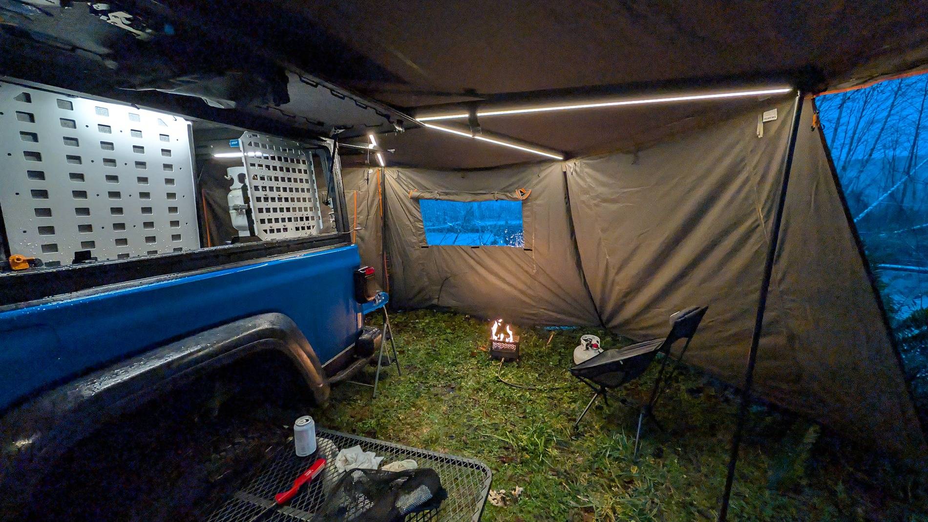

I also picked up the awning wall kit for the 270. Just having the little ignik firecan under the awning generates alot of heat and is a nice place to hang out in when it's raining.

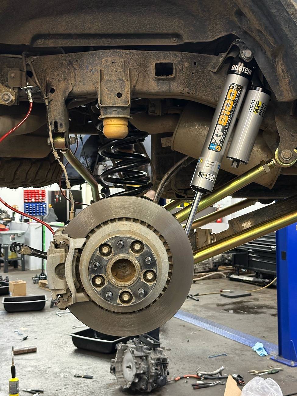

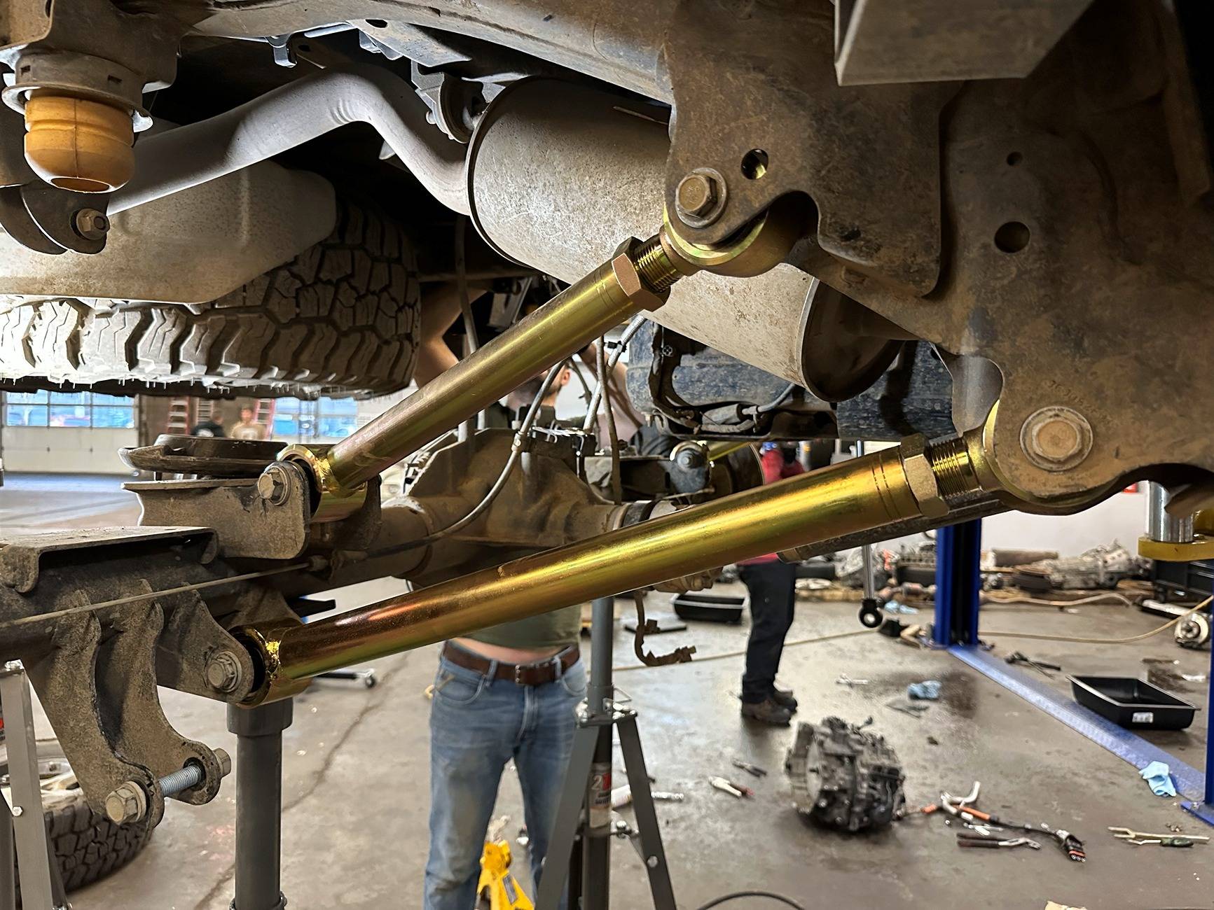

Pulled the trigger on the Metalcloak rocklander 2.5" kit. In talking with MC, the rocklander kit is designed for ~500-600 lbs of added weight in the bed, which I'm likely around. In looking at the kit contents they provide the 3.5" lift rear spring to make up for the weight instead of going with a stiffer spring like Clayton or AEV uses. Once I get some miles in I'll provide an update on how the ride is. I decided to pair the lift with the AEV/Bilstein XP8100 shocks. These are revalved by AEV for heavier rigs and are not adjustable which is fine with me since I trust they know what they're doing.
Jeep Gladiator Hydro Blue JTRD Build Thread IMG_20250103_113342(5)
Jeep Gladiator Hydro Blue JTRD Build Thread IMG_20250103_113342(4)
Jeep Gladiator Hydro Blue JTRD Build Thread IMG_20250103_113342 (3)
Jeep Gladiator Hydro Blue JTRD Build Thread IMG_20250103_113342 (1)
Overall I the stance and lift height is perfect for what I was looking for. Loaded up with all my typical camping gear I'm still just above level and unloaded there's about a 1" rake. The 35's don't look terrible either at this height.
How's the ride with the xp8100? I was looking to get some to pair with a clayton 2.5 lift and hoping they aren't too stiff.

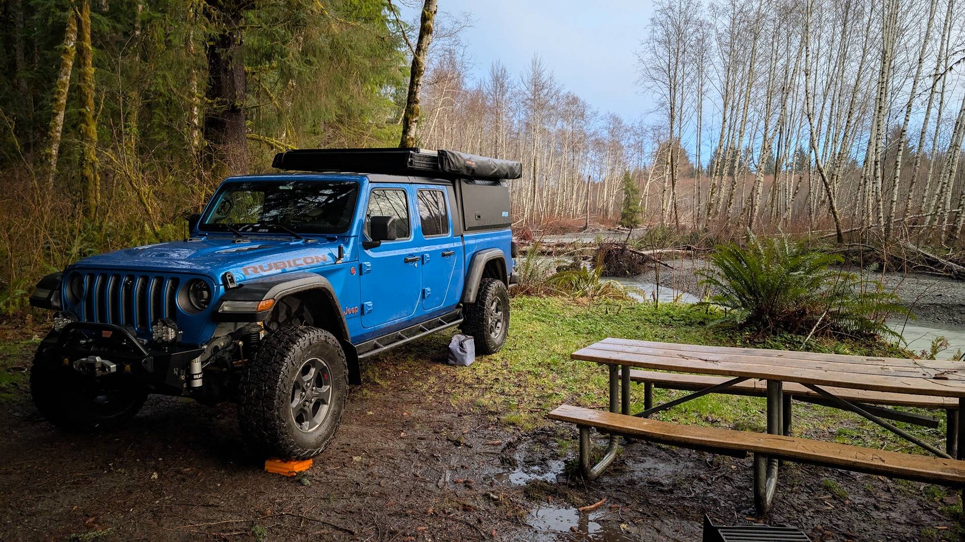

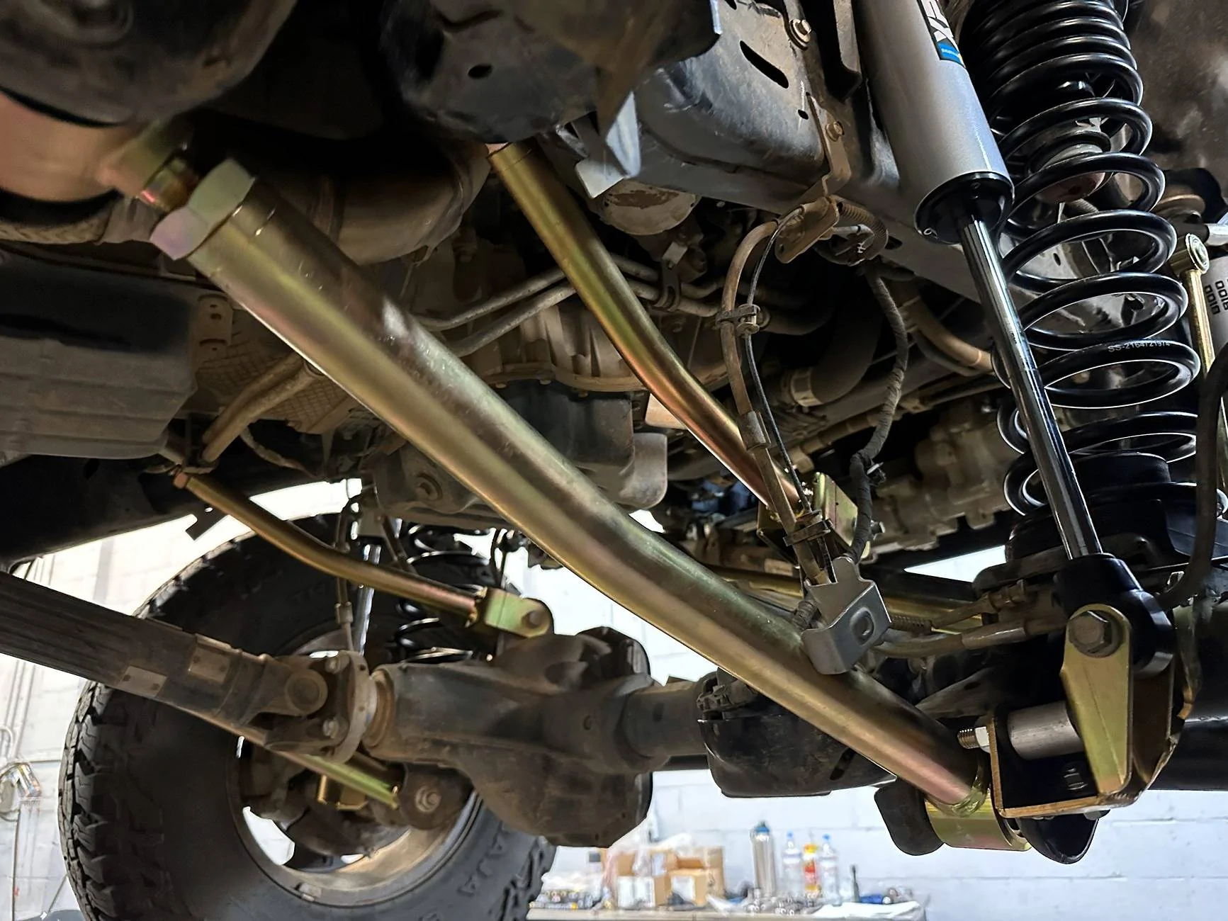

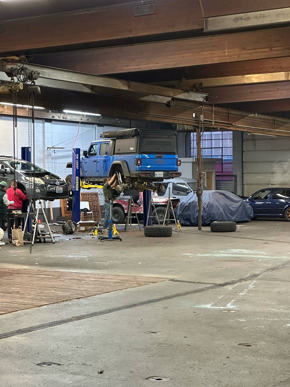

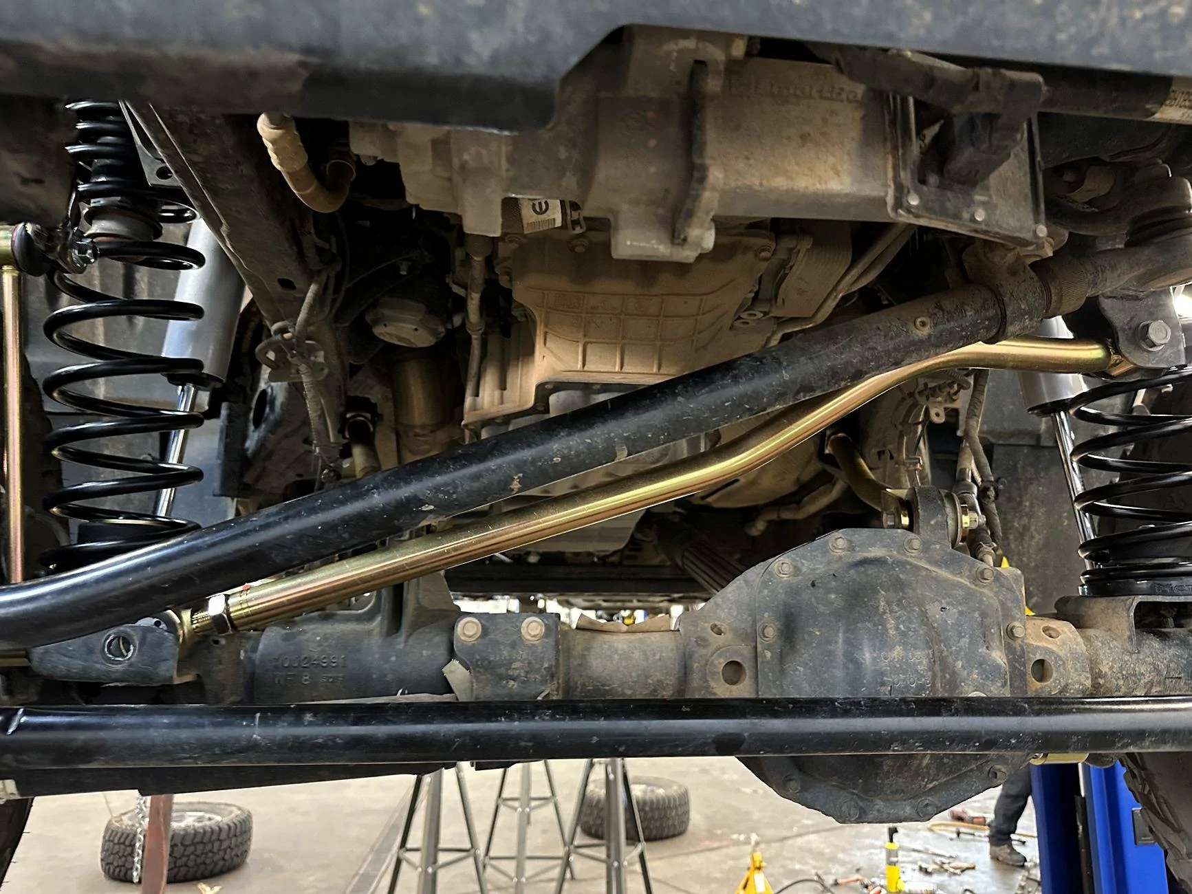

I did this a few months ago, but wanted to get some more seat time before providing an update. I was not too happy with how soft feeling the MC springs were especially when loaded up for trips. After looking around I decided the high capacity AEV springs were what I was looking for and would pair well with the 8100's. Overall, I am extremely happy with this setup now. The suspension feels much more planted and stable, there was an increase in bump harshness when going over speed bumps, but offroad aired down it is great. I also netted a bit more lift from this setup and typically have about 1.5" of rake even when fully loaded.
Jeep Gladiator Hydro Blue JTRD Build Thread PXL_20250503_015207032
Jeep Gladiator Hydro Blue JTRD Build Thread PXL_20250607_194509098
