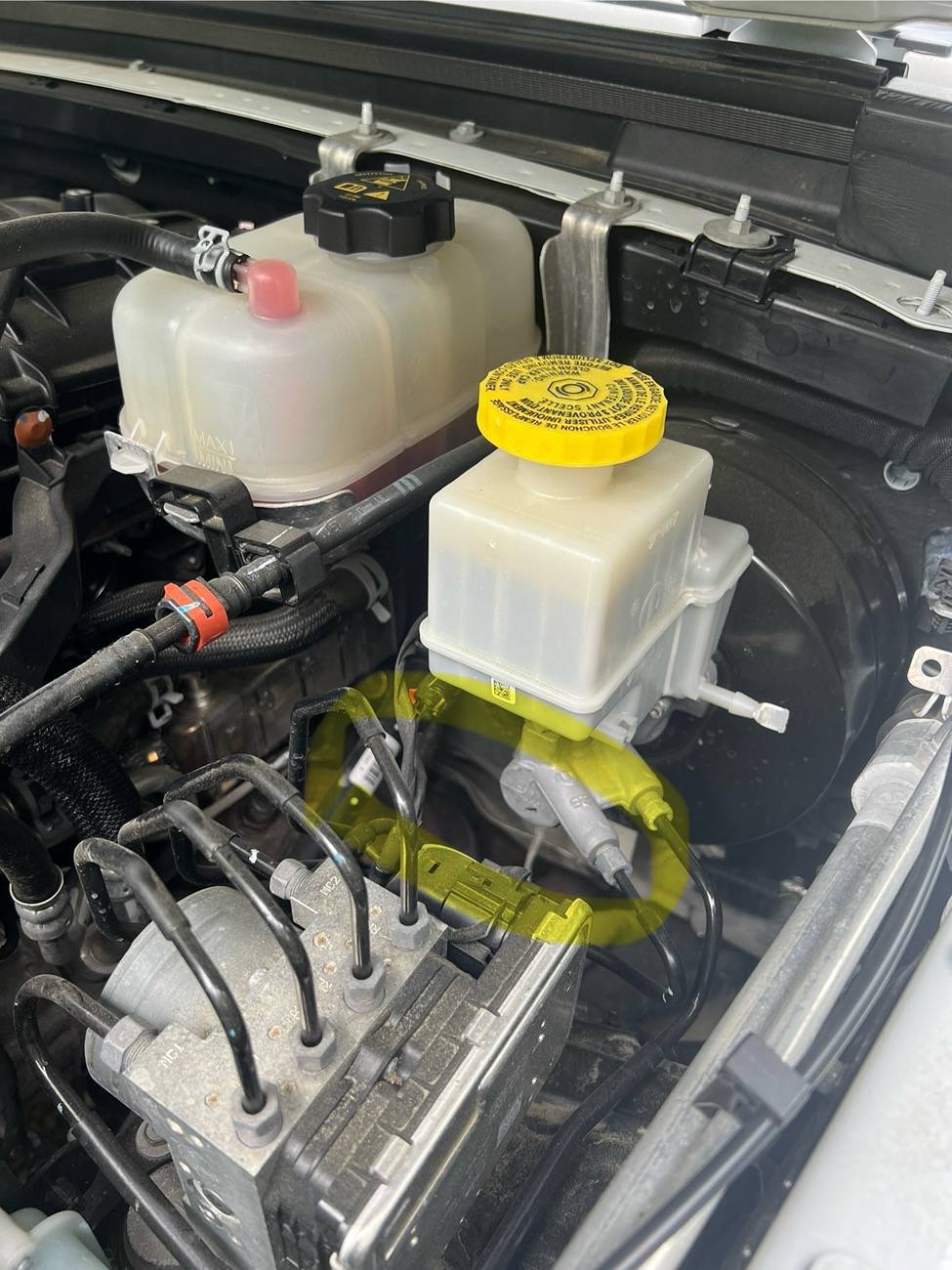

Vacuum leak around the power brake booster. You say it’s getting louder under load, driving into the wind, that would do it. Does the noise change if you work the brake pedal up and down? Whack off around 2 or 3 feet of an old garden hose and hold one end against your ear and use the other end to probe around and see if you can localize where the noise is coming from.

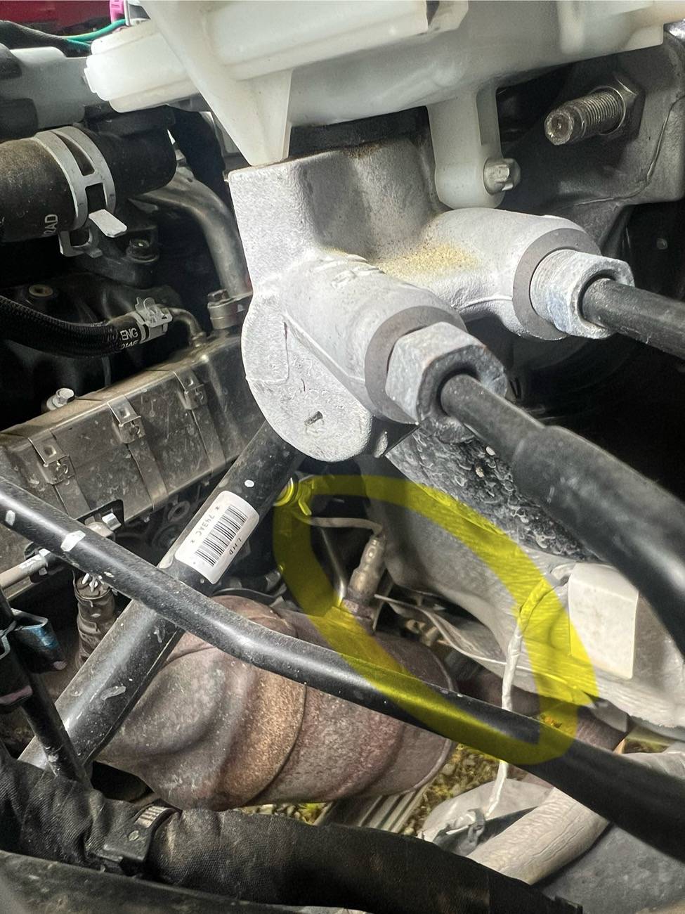

So I found a Tiktok with a Wrangler having the same noise under the exact same circumstances. Here was her diagnostic and the fix has resolved the issue. BUT I don’t have a boost 😩😩😩 What should I check? Any / all hoses for tightness?
My bad, that’s the first thing I would have thought if I hadn’t assumed it was a V6, not a turbo 4. Sounded like the Mack I drove in the 80’s that had the same thing happen on intercooler outlet
