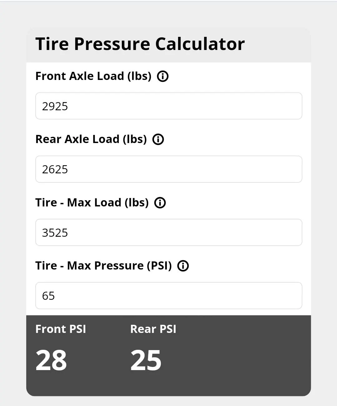

Need help , advice please.
Typically I have only ever dealt with car tires and have basically stayed with the recommended tire size/PSI listed on the door jam.
New to the big tire game, I have just stuck to what I know (atleast though I knew).
I have 37" all terrain tires
with a max load/ PSI rating of 3525 @ 65.
I have tried running them as low as 32 PSI and as high as 37. I found the low, to be squishy and the high to be squirly... so I settled around 34/35.
I'm getting close to my first tire rotation, so I started paying a little more attention. It seems my pressure might be a little high, so I started researching.
I haven't done a chalk test(yet)
I haven't weighed my actual vehicle (yet, looking fo a reputable scale clost by)
So I grabbed the weights for a 2022 JTRD from the web and estimated for the larger wheels/tires/lift and rock sliders and came up with the following numbers:
*These numbers are not verified in anyway, just best guessed according to what I could find on the internet. Please correct if grossly incorrect *
Curb weight - 5550
FAW - 2925
RAW - 2625
Using a PSI calculator, it gave me the following calculations:
Front PSI - 28
Rear PSI - 25
Those with first hand experience or tire expertise (self appointed is ok... ha ha)
Does this sound right ?
I know I need atleast to do a chalk test, but want to be more accurate, so weighing at a scale is preferred.
Should the 28/25 put me in the ball park or should I continue to run 34/35 all around until I can verify my actual vehicle weight ?
What PSI are you guys running for your 37's ?
Thanks for your help/input.
Call the tire manufacturer. I called Mickey when I thought I was running high as well. They asked detailed questions about the Jeep, including original tires and door label. They recommended 27psi cold for my 37’s. They were spot on. Its rides perfectly and wears evenly.

Kinda doing some backward analysis here. Stock tires come load range C. Load range D or 8 ply tires have a 50 psi max. You stated your tires have a max PSI of 65? That’s a lot of tire for a gladiator. I also didn’t see where you mention the wheel size. Many 18” wheels running 35-37” tires with a max pressure of 65psi are load range E or a 10 ply tire…meant for 3/4 or 1-ton single rear wheel trucks.
37x12.5x17 you are correct, it is a E/10-ply.... but
A heavier tire means that there is more rubber, which translates into deeper lugs that provide better traction and thicker, stronger sidewalls. There is still value to running a Load Range E tire on a lightweight off-road vehicle. While the carcass will not be as flexible as an equivalent tire in a lower load range, the air pressure can be lowered to account for this. The reason the carcass is less flexible is because of heavier construction that fends off punctures off-road.
Getting the proper PSI, is a little more tricky with the range E tire, heat is the killer as @ScottBeach mentioned.
I got this info from a great Motortrend article, you can read the whole article here:
https://www.motortrend.com/how-to/1611-tire-tips-101-load-range-vs-weight-rating-and-more/

My 37x12.5x17 are D rated. That’s why I run 27psi.
I'm guessing 30 psi is going to be the sweet spot for me... but until I do a chalk test... can't be sure. I will definitely have to pay close attention to the heat while figuring it all out though... I would rather run a little high psi and over time wear the center more than run too low of a psi and over heat the tire and have a blowout or wear the entire tire out very prematurely. Just my thinking...anyway.
