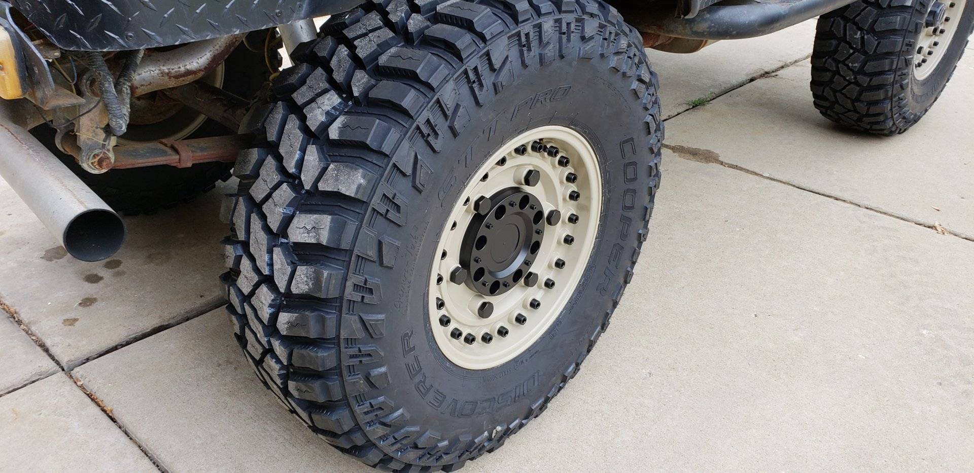

You don’t have to do the chalk test with chalk. Just look at the tread. It should be noticeable where the tire is making contact with the road and where it isn’t. Notice how the inner portion is lighter/dirty and the outer edge of the tread is darker/not dirty:

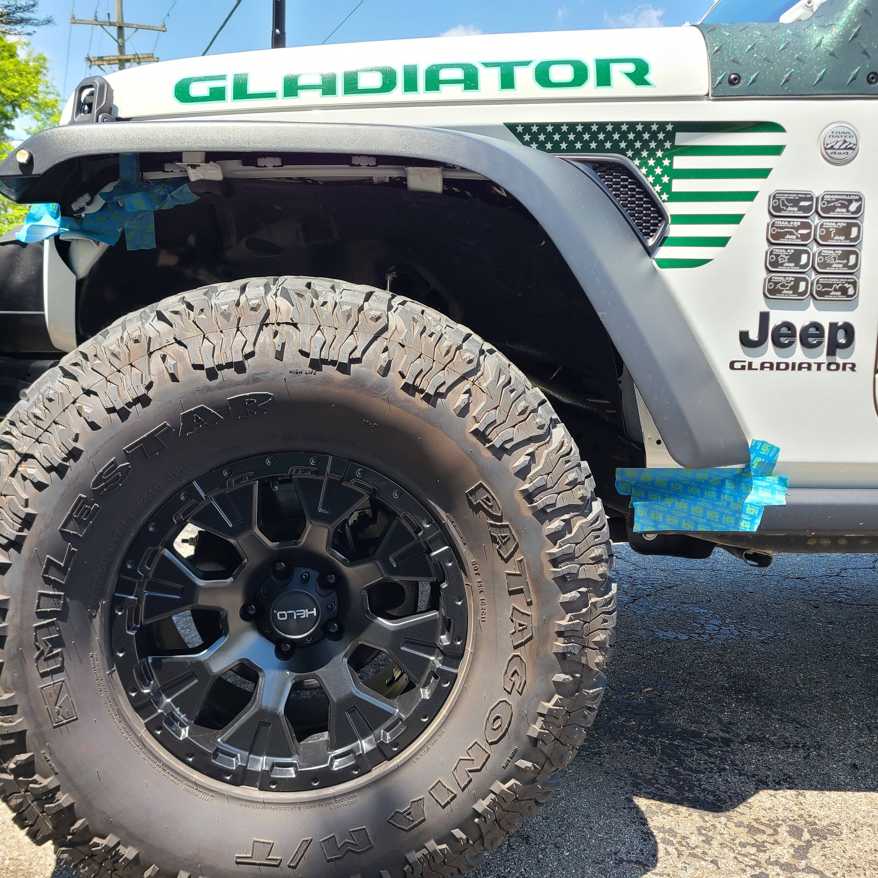

Anyone running 37x12.50r17 Milestone Patagonia MT’s?
If so what psi are you setting them at. I just put them on and set them at 36psi but I definitely find it a bit squirrelly on the highway.

My Pat's are happy at 30-32 on road, 15 off-roading
