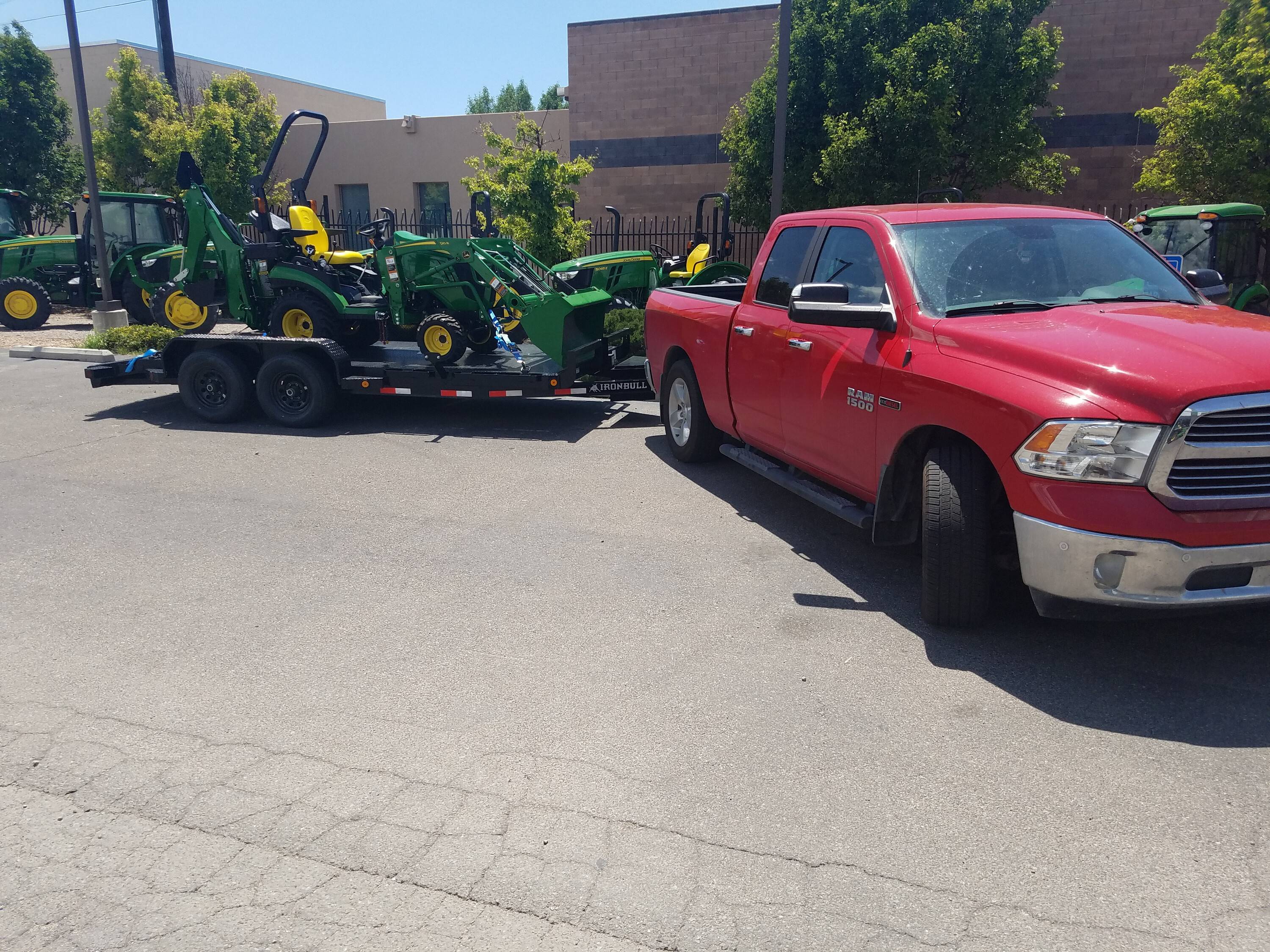

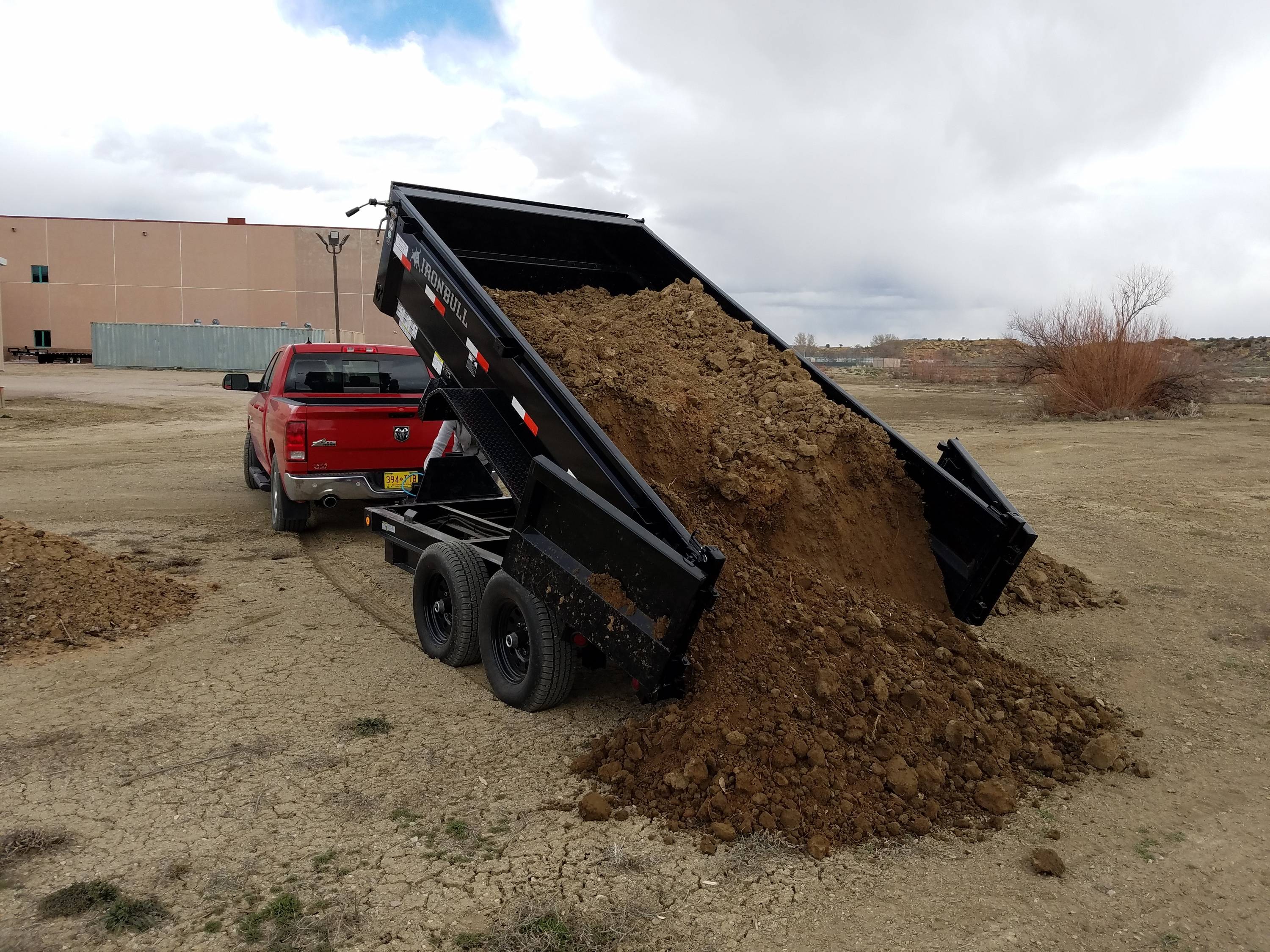

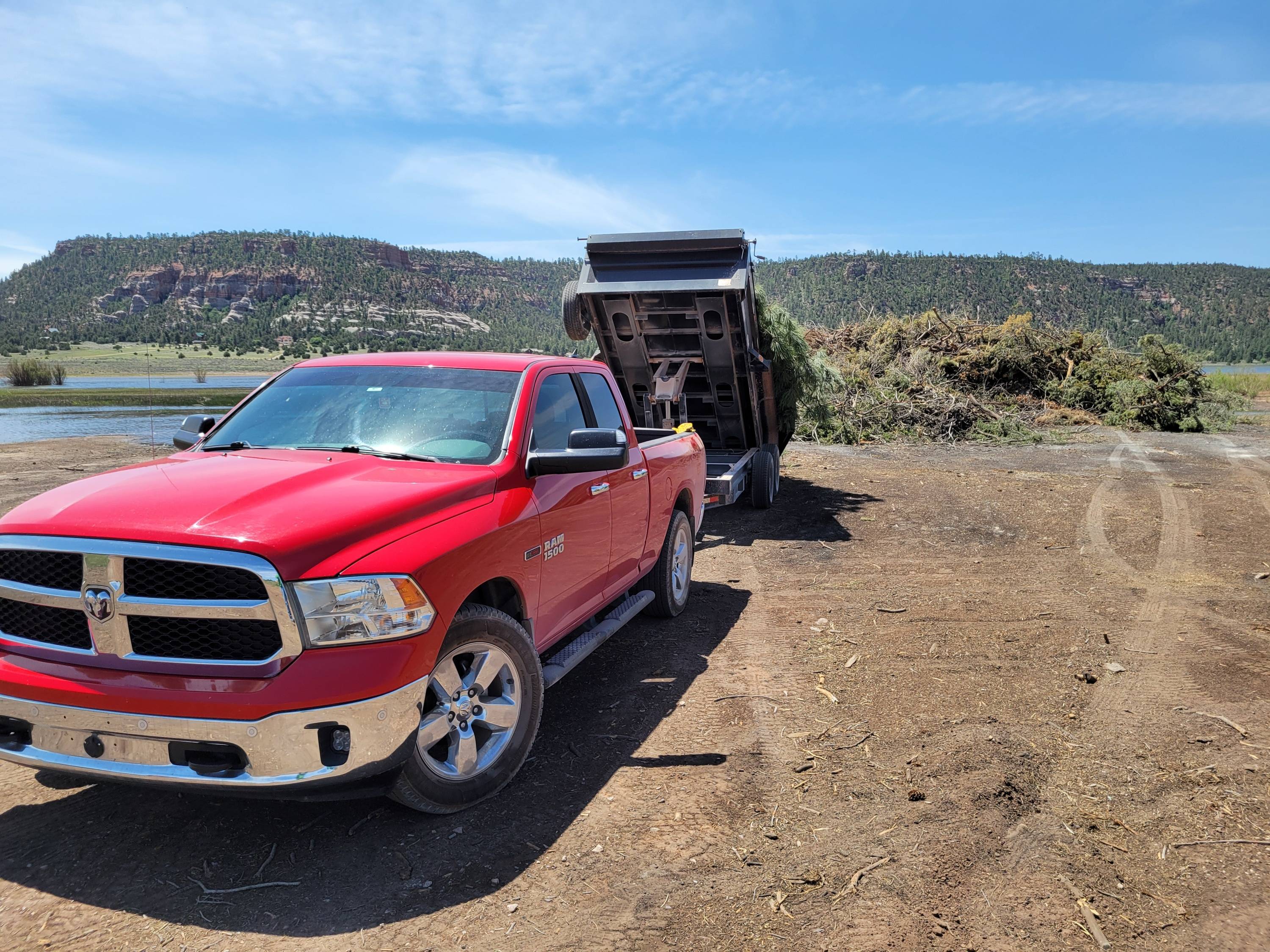

Good info, I did see a couple of real good deals on the 3.0's that still were tempting there on 23's.
We bought our 2023 Gladiator back in March for $15,000 off MSRP.
It looks like they may have worked most of the bugs out by gen 3. AND those are Rams so the 3.0 is already toting an extra ton around before it even starts up...
The Gen 2 and Gen 3 are both pretty solid considering it's a light duty engine with a B10 life of 150,000 miles. Emissions is the biggest issue. As you can see, I've had to replace the EGR cooler, DEF pump, and NOx sensors. Considering how much towing I do with the truck, I can't complain.
