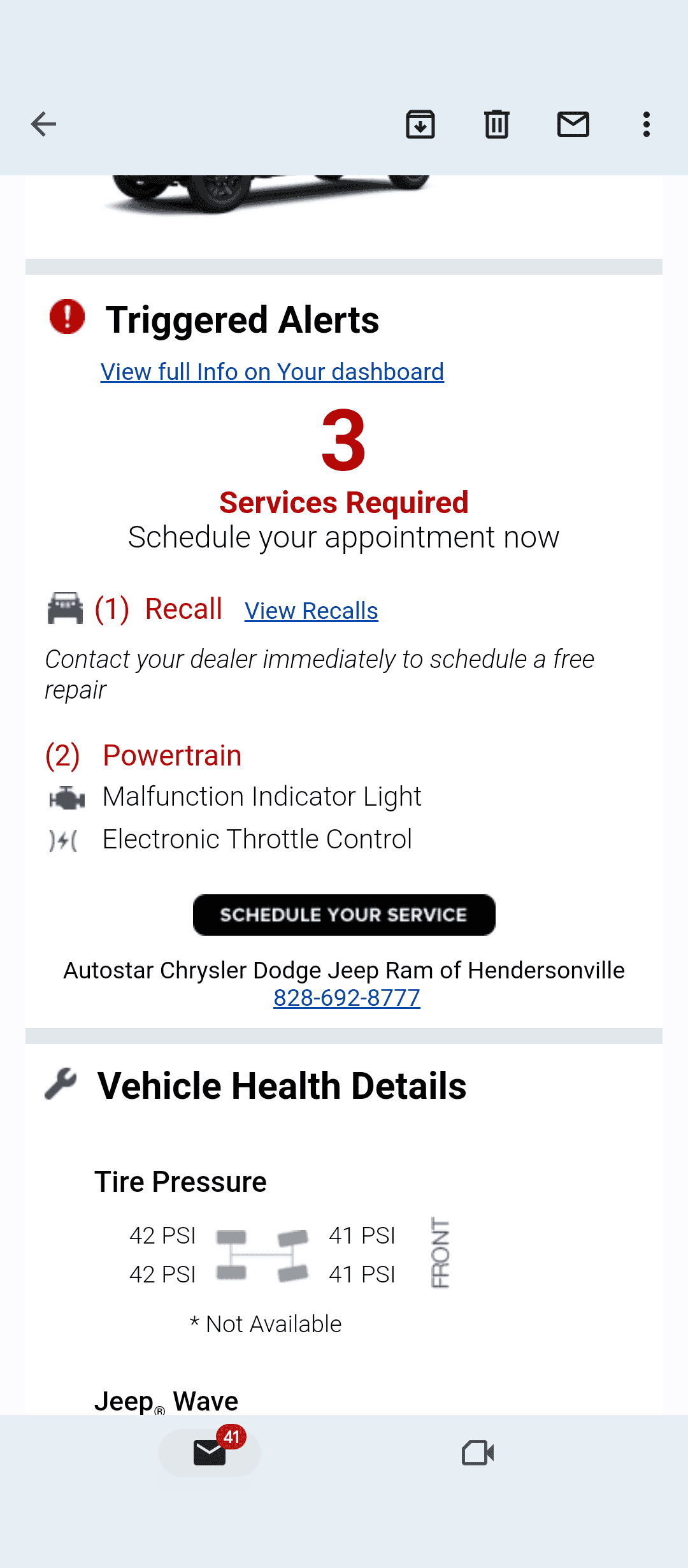

I wanted to ask several on here about my 2022 gladiator?
First of all it started going into limp mode if I was pulling my lawnmower on a trailer up a long hill.
Saying throttle control malfunction stuff like that, I pull over turn off and start back and it goes back normal except with check engine light on.
It's happened 5 times.
It's always up a hill pulling a lawn mower.
Dealer reflashed, said a loose wire. But it did not help.
They said there was a code for low voltage.
So I took my multimeter and done random test, alternator, 2 batteries seemed normal except when running.
Voltage was 12.3-12.5 volts when running.
I went to my 16jk jeep and when running it's 14.7 volts.
I am wondering if it's a sensor or something else?
This never happens when empty it's always when hooked to a trailer with lawn mower

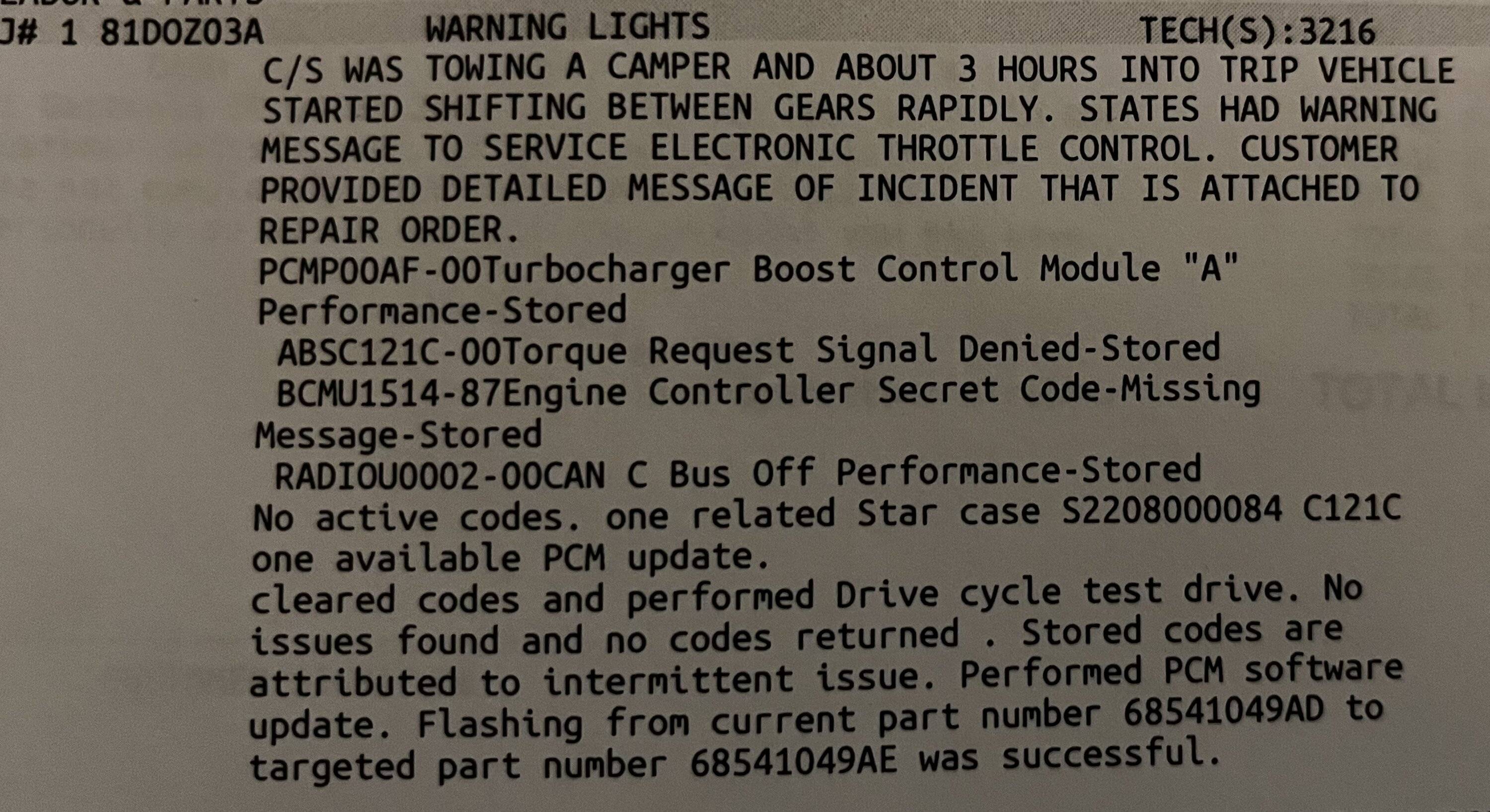

I had the same experience back in May towing a camper (~3500#) on a 325 mile trip.
Towing up a hill on interstate approx 60-65 mph, started slight incline (maybe 3%), and RPM started rapidly changing between 2k & 3k rpm - shifting gears back and forth as well. "Service Electronic Throttle Control" and "CEL" came on the display. All temps were in normal range , maybe 10-15 degrees higher than non-towing. Truck went into 'limp' mode up hills and I was able to 'reset' by stopping turning off engine for a bit (CEL stayed illuminated). It happened twice on the way there, but didn't happen at all on the way home.
Took Gladiator in for service and they found error codes related to turbo signals/some other signal not received. They updated the PCM per a service bulletin. I'm away from home at the moment, so I don't have access to the service notes, but I can post the specific info in about a week and a half.
I haven't towed anything since the update, but will be for another trip in early August . Fingers crossed it doesn't happen again. It wasn't a good feeling thinking I was about to be stuck on side of road pulling a camper.
Good luck!
Edit(including summary of 'fix')
Jeep Gladiator 3.0 diesel issues repairsummary
