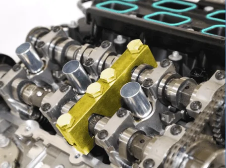

I know that the spacing between the intake and exhaust camshafts is the same on both heads.
There are 12 pins or 13 links between the timing marks on the phasers with the cams properly timed, and the secondary timing chains are interchangeable from left to right sides. The rocker arms are also interchangeable from side to side. Until the Pentastar upgrade engines came out, all 24 rockers were the same. So I don't think that there is any difference from left to right heads in valve position in regards to the camshaft position in the head.
That makes sense since the same tool can be used on either side.

Can't swear to it but I'd bet the cams ride positioned a bit differently over the follower or rocker based on the cam and head. In other words, if all else was exactly the same, bet the heads wouldn't swap side to side simply because of where the cams sit over the follower.
(would love to take some centerline measurements to see how the cams sit over the rockers and how far away the center of the cam is from the center of the valve for each cam, both heads.)

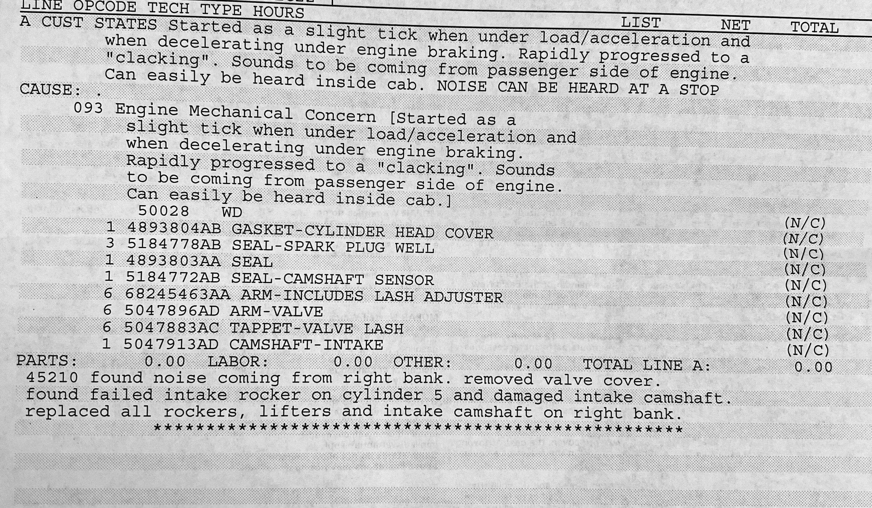

Update on ours:
Dropped it off end of last week and we were out of town until yesterday. So they had enough time to diagnose and fix without it being a hassle on our end.
The verified noise even when at a stop.
Tracked it down to the right bank. Found a failed intake rocker on #5 and damaged intake camshaft. Replaced all rockers, lifters and intake camshaft on that side.
Seems great at the moment. Will update if things change.
Ok, so 5 months later now... here's an update.
Things were great after the service and repair. No noises that seemed odd.
About 500 miles ago I started to hear something that wasn't exactly "right"... but it was mostly after a cold start and would diminish after it warmed up. Since then, it's started getting louder and more noticeable.
It isn't as pronounced as my original noise, which prompted the dealer to replace the right side cam. But I'm betting in another 500 miles it's going to be even more pronounced.
So, either the left bank is failing OR they botched the install on the right side and it's starting to go again. 47,xxx miles on our 2020 LE.
We really wanted to keep this one long term, since it was a LE. But this has us considering trading it in, even if the engine issue gets addressed via the service dept again. Some vehicles are just unlucky :)
